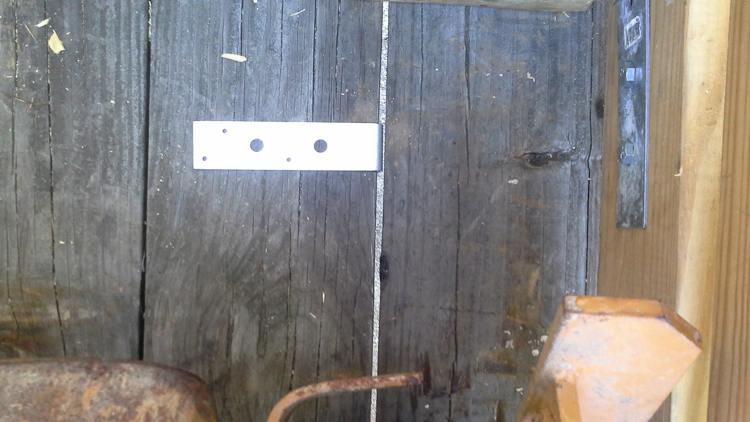

I've a trailer with deck boards that shrunk over it's life such that there are cracks between boards that easily fit a 3 gauge corner angle bracket.

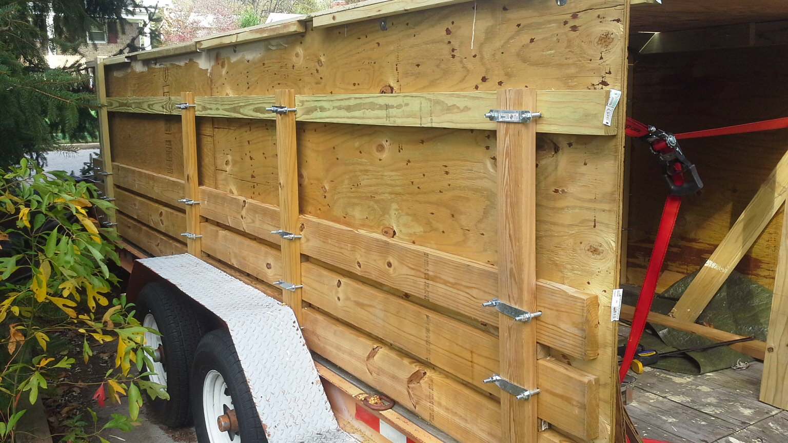

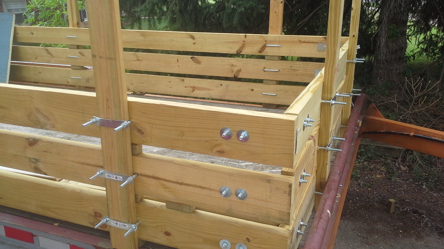

The trailer is used as a flatbed for hauling tractors.
as a trailer w/ sides for hauling miscellaneous stuff,
and with a homebuilt 4' high cargo "box" w/o floor other than the trailer decking for transporting.
With the box on I've places above the floor to attach straps to but I'm transporting some heavy equipment like a plow and a 5' tillerwhich I'd like to anchor to the deck.
So I want the design easily removable.
The picture shows one such bracket dropped thru a crack.
I'm looking for an elegant solution on putting a "thick as I can" (3 or 4 gauge) piece of metal thru the "slot" and fastening it so it doesn't pull thru.
Presently I'm thinking of dropping the angle bracket thru the crack and then put a bolt w/ nut thru the bottom hole that sticks under the bed, then a bolt w/nut thru the second hole up. I can then fasten something to the remaining portion of the angle bracket sticking above the deck.
I've thought of just a straight piece of steel strapping, but have the angle brackets.
So TBN, any more elegant solutions?

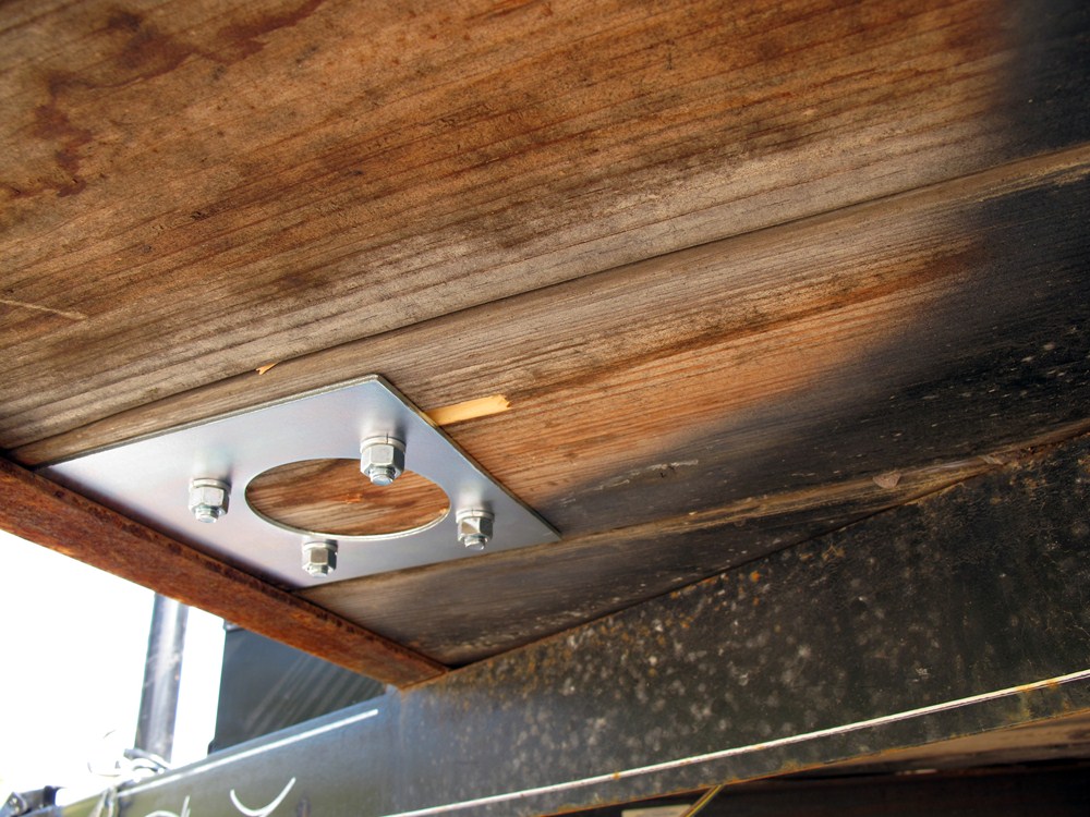

To install a tie down on a wood deck you need to use a backing plate on the bottom of the wood. Preferably close to a steel cross member. Just an L bracket through the gap in the wood is not a secure way to tie down. If you don't want to drill a hole for recessed tie downs you can use the surface mount D-ring type but still need a backer plate on the bottom. These are available from Etrailer and most trailer stores.

If i was going to use anything, it would be attached to the metal and not the wood. I think some stake pockets added along the outside of the frame would come in very handy and give you something to attach straps to. You can use the pocket tie down above in the middle pic. Route the wood to accept a flush mount, and locate it over one of the cross members for secure support.

George I bet you moved back because of the "other" metal flange on top. A reasonable way to make your tiedowns very very strong is to add a plate on the bottom (with 4 holes). Drill 2 more holes ahead and add bolts that go thru the steel flange(s?). Use Self-locking nuts so its secure without having to squeeze down hard on the upper flange. Even a thin plate like 10ga, or 1/8" is very strong in this application.
