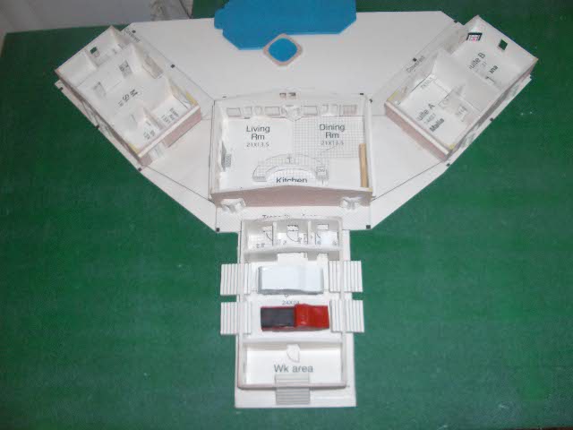

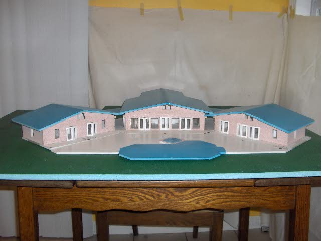

We did this, or more accurately, are still building. Still got some cabinet and trim work to do. We are owner-builders and not getting any younger :)
Before any drawing, we made a written list of what we wanted in terms of space or function, for instance: single story, ADA, exercise room, area for caregiver in my dotage, no hallways, openness, ventilation, etc. As I drew different plans, this list became our sanity check. Went through a number of styles and material before settling on what we built. Not only did I do scale drawings, I also made a scale model using that foam board stuff. This was really great. I made the roof removable. Also using same scale, did mockups of kitchen, laundry, garage w/vehicles. This provided a very good perspective of windows and doors. Although we did make changes, the final product is very close to model.
Have fun.
David
