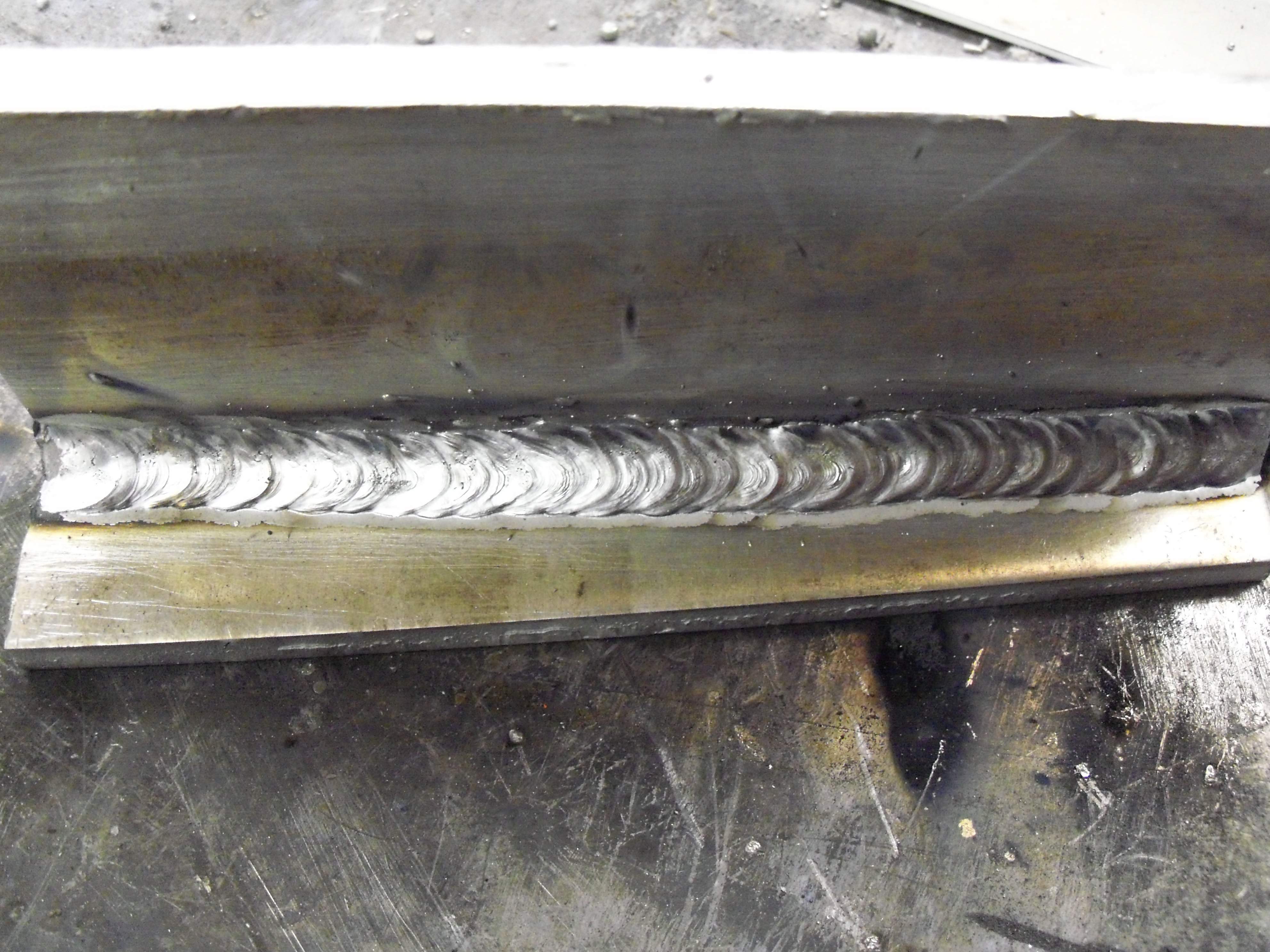

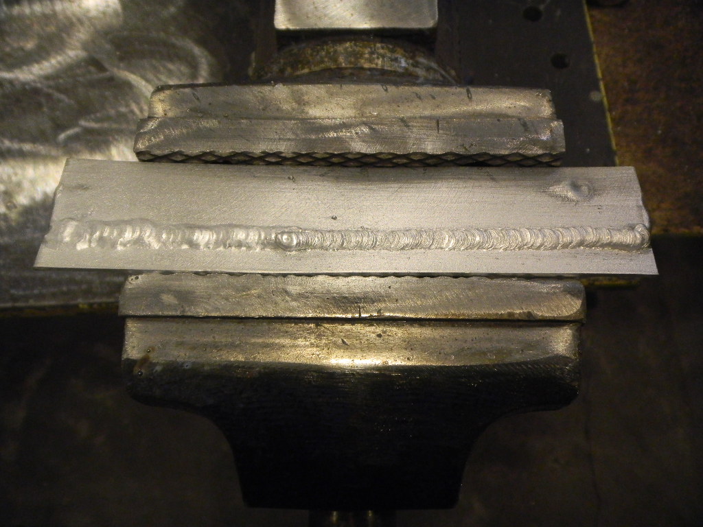

I just got mine back out of the shop. Used the Lincoln spool gun this morning, not very good luck! As the spool rotated the tensioning nut would get tighter, and stop the wire dead in it's tracks:rolleyes:! Had to revamp the whole tensioning system. But I think I got it working now. I tried 3/64 5356 and .030 5356. I ordered some .035 5356, should be here in a couple days.
Also pickup a bottle of 90% argon / 10% CO2, started playing with .035 L-56 wire in spray transfer. At the moment this Invertec V350-Pro is over my head! Too many bells and whistles. :laughing:

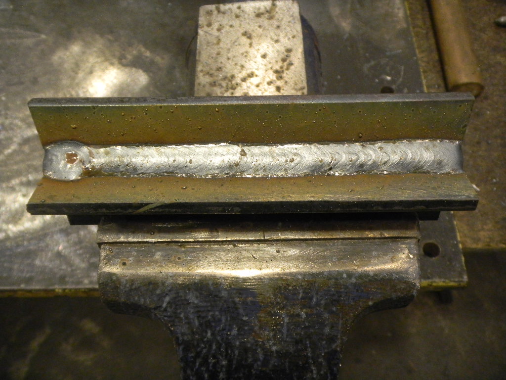

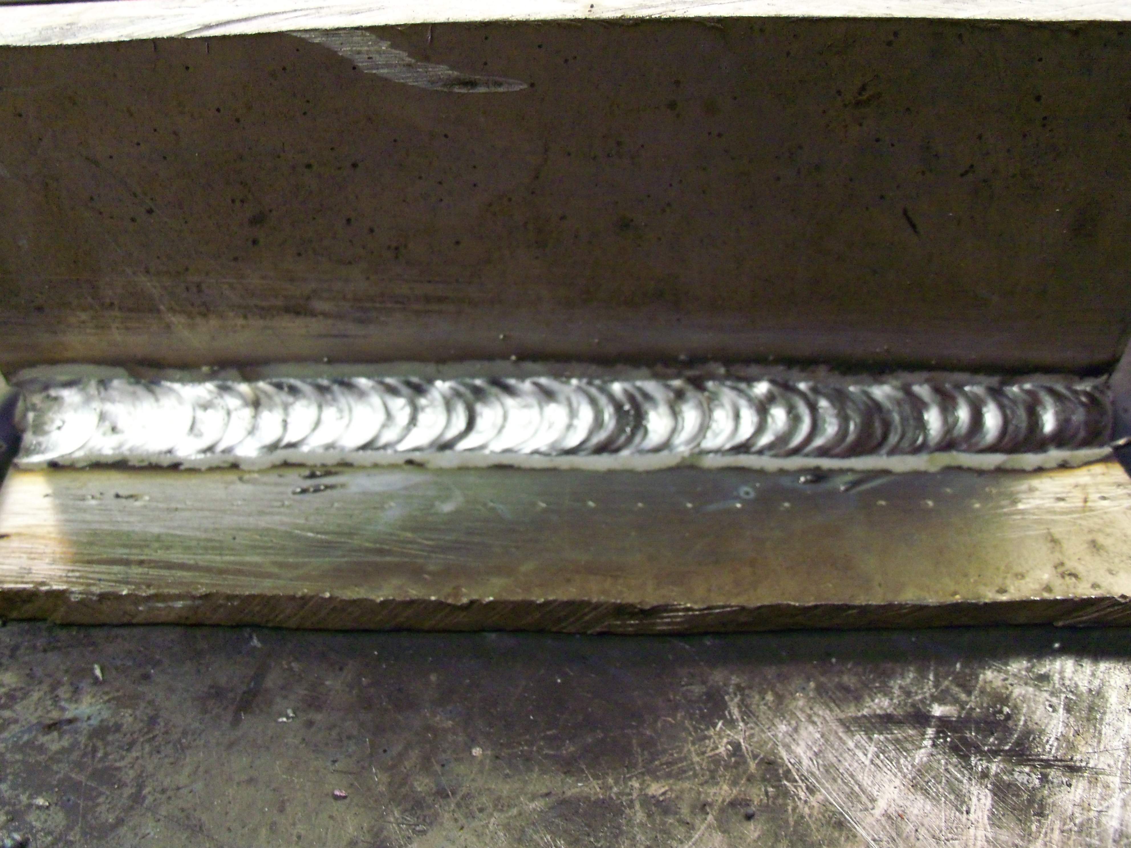

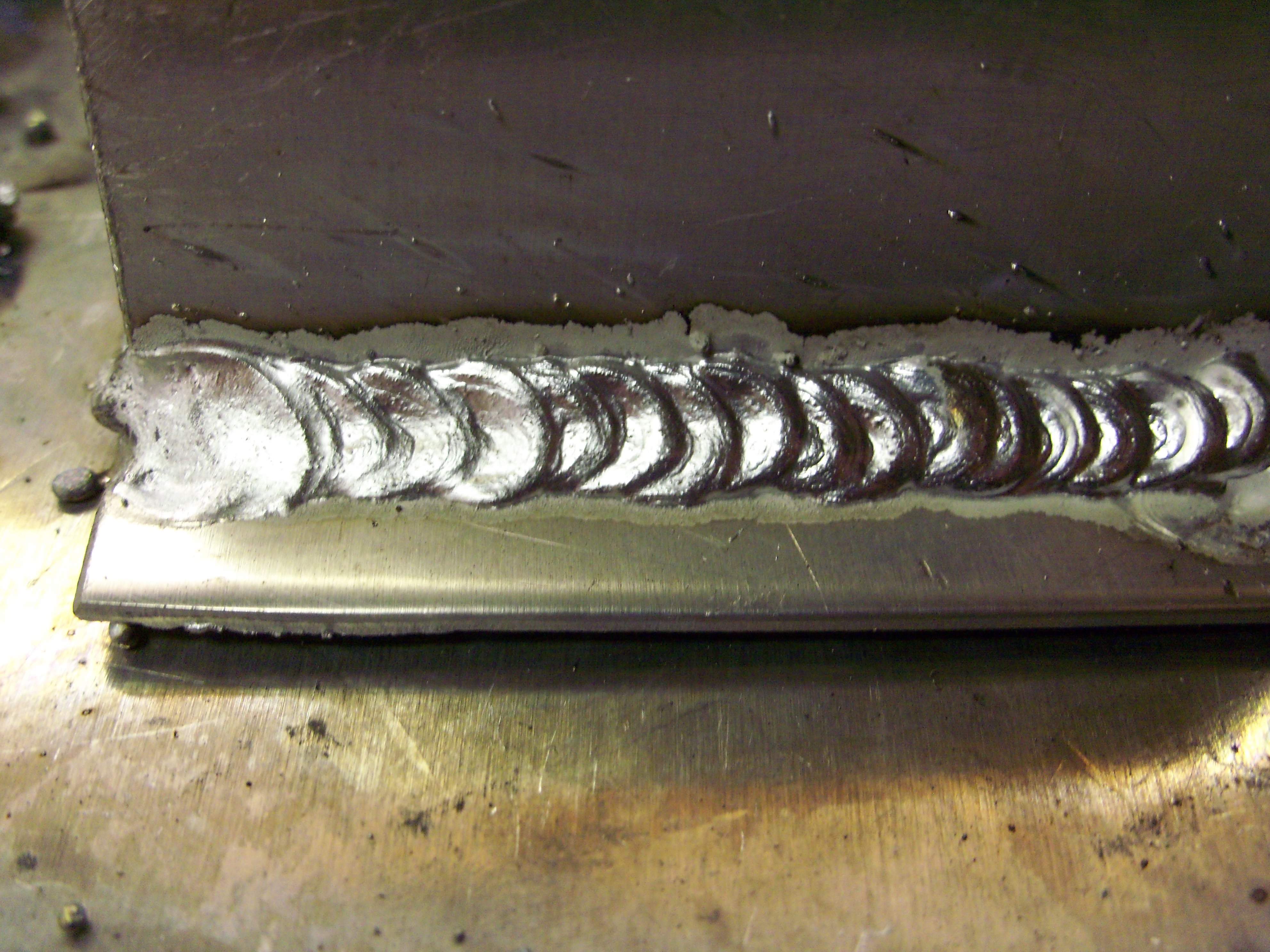

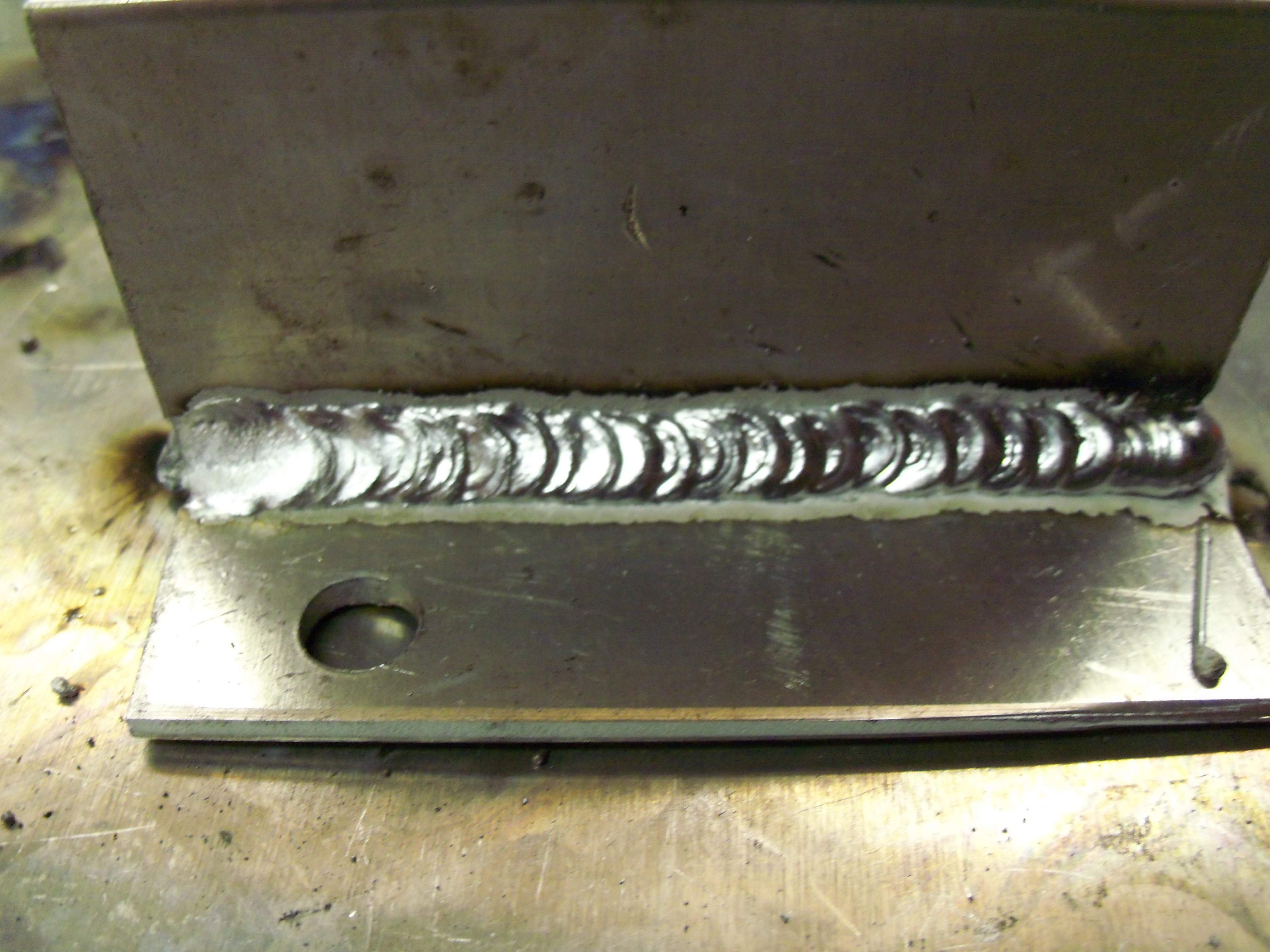

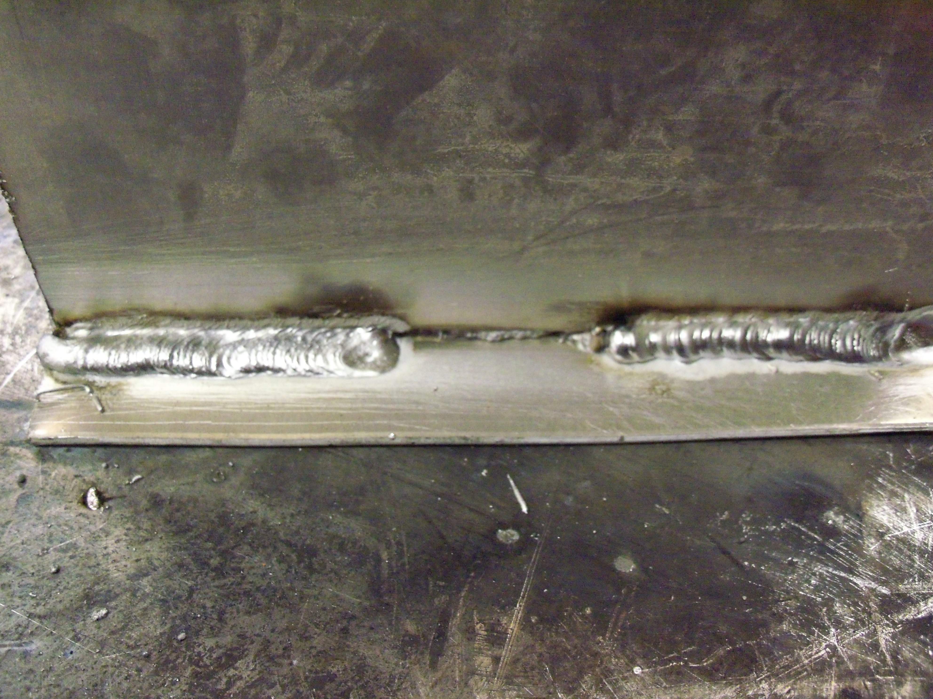

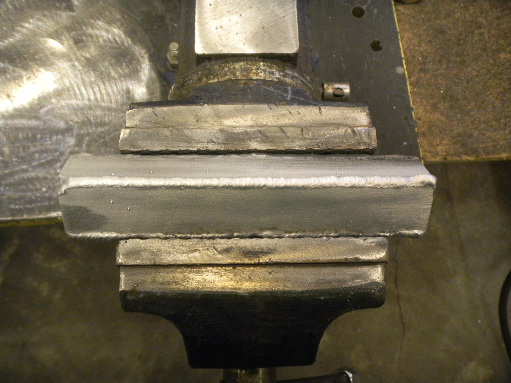

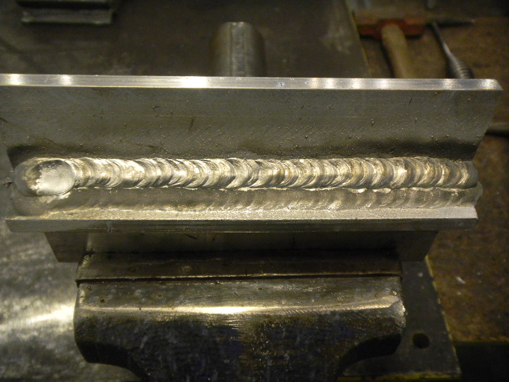

I found my camerea:thumbsup: I found some .035 4043 locally, I ordered some .030 4043. The first pics are of the .035 4043 on 14 gauge. I came out decent but I think the .030 will work better. The last 2 pics are .035 4043 on 1/4. The 1/4 welds came out great.I am running out of thicker pieces to practice on. I have a lot of 14 gauge. I am pushing at about 10 deg. So far I am verry happy with this welder.
Bill

The 1/4 inch welds do look great!:thumbsup: Do you remember how many amps you were running?

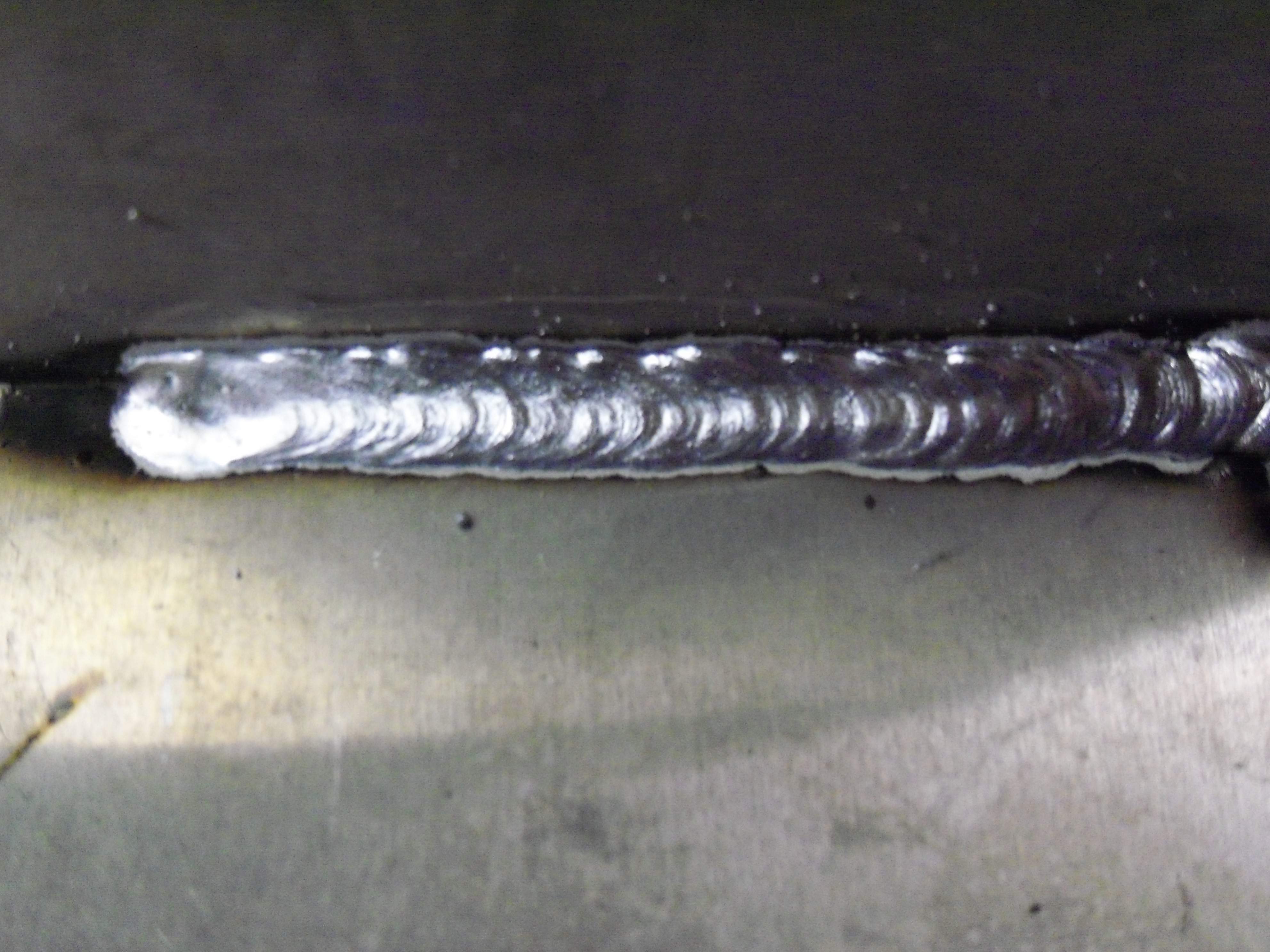

My .035 5356 just arrived this afternoon, going to give it a try on some 10-GA in the morning.

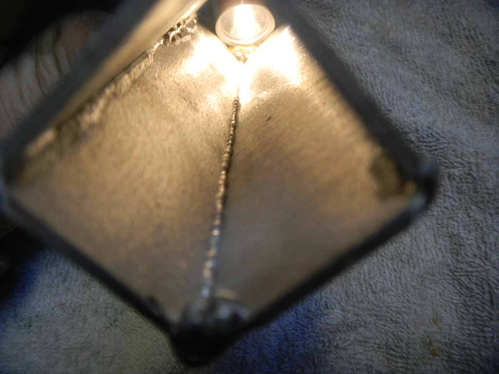

Here's some .030 5356 on some 16-GA. Corner joint, and a lap joint. The left side of the lap joint was a Tig weld from years ago, trying to find the sweet spot on the pulse.
