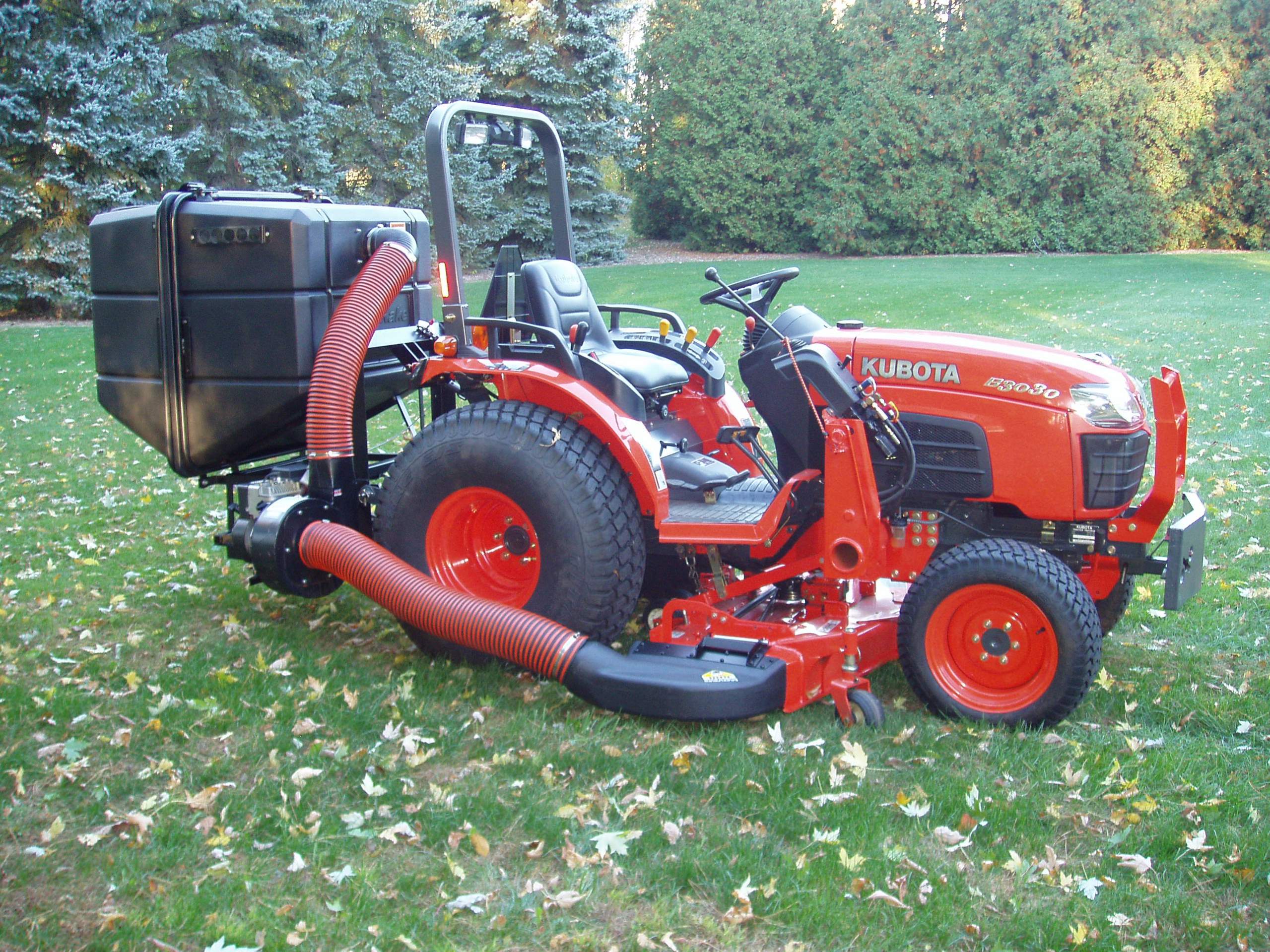

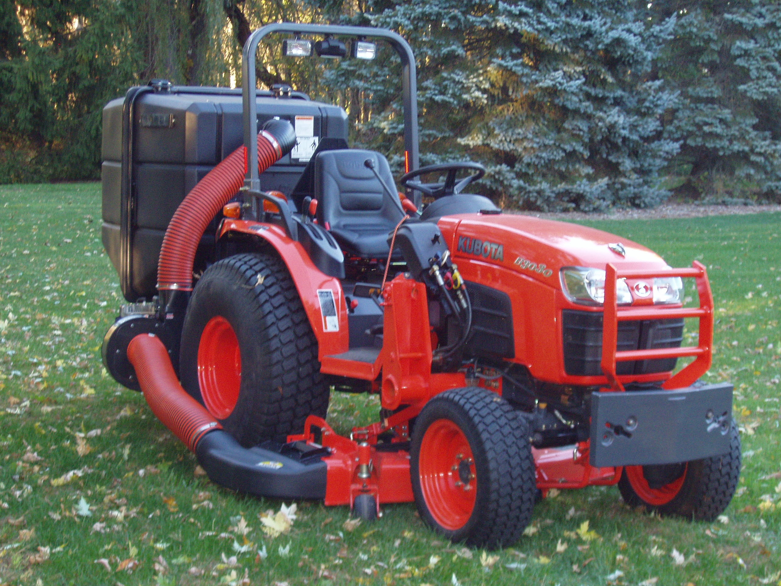

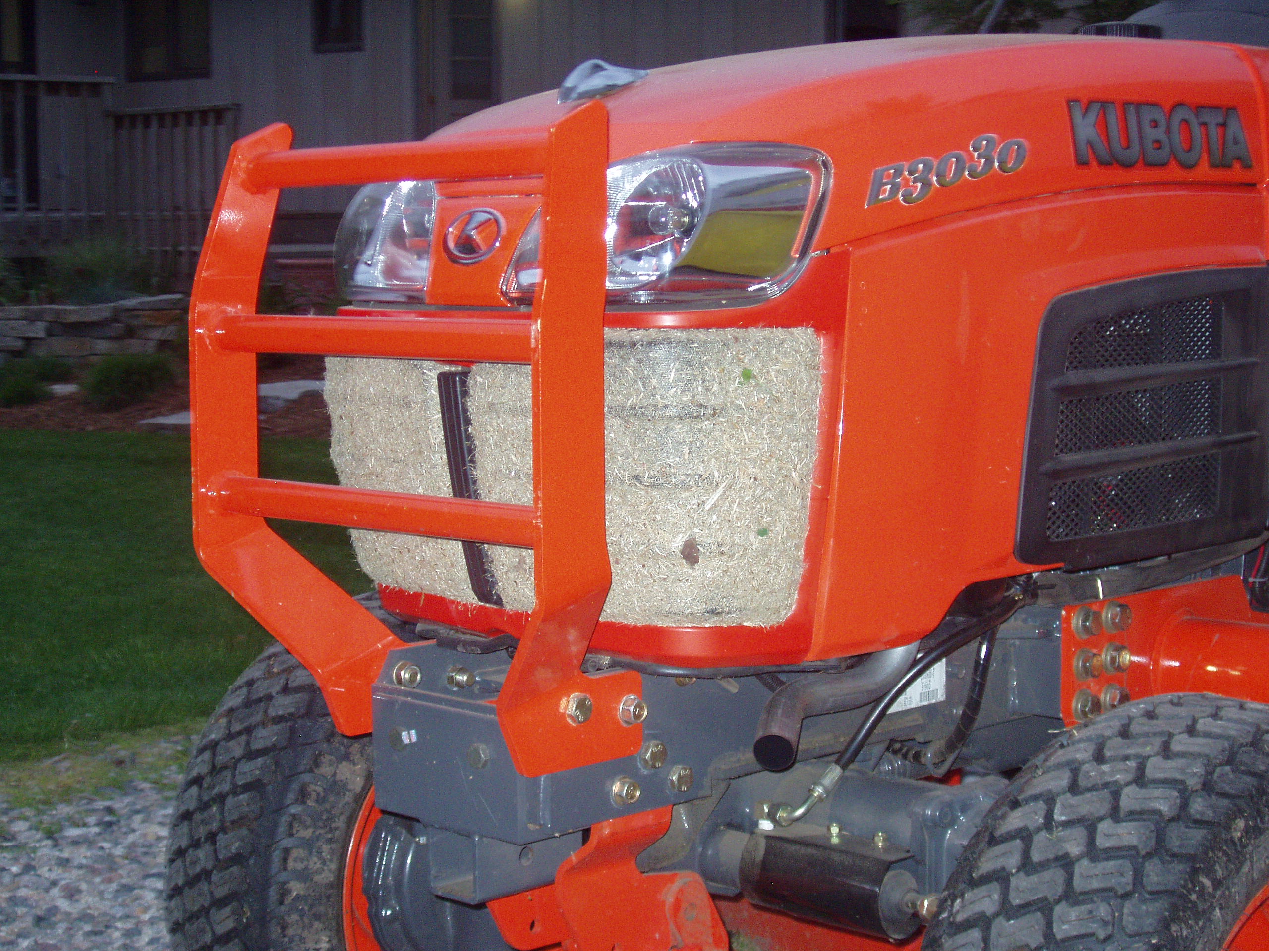

I had the same idea and made something like that for my B3030. I mostly use it to add a weight to the front end when I use my leaf vacuum. I made a bracket for the weight by welding a channel iron to a 2" peice of square tube. The weight is an old John Deere weight from the front of a 3020D. I have also attached a ball hitch to the front for moving a trailer. It is a very handy thing to have on the front of a tractor. Nice job!
The first pic was of the grille covered in dandelion fuzz after mowing one time. You can see the receiver hitch under the grille guard. The 2" I.D. square tube is welded to the angle iron which is bolted to the front and the sides of the tractor frame. The next pics show the weight mounted.
