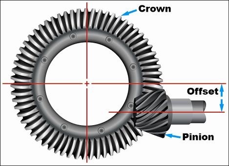

Do yourselves a favour and look at a picture of a ring gear and pinion. What happens when the ring gear is locked in position as would be the case with sufficient traction!:D
I can say for certainty that the ring and pinion forces are completely resolved INSIDE the tractor. The pinion climbing the ring can absolutely NOT cause the front of the tractor to lift.
All rotation is due to the reaction with the tires on the ground. PERIOD! (the wheels are commonly driven by a ring and pinion, but there are alternate configurations.)
Using the example suggested by Egon and the photo.
Quote:
Do yourselves a favour and look at a picture of a ring gear and pinion. What happens when the ring gear is locked in position (as would be the case with sufficient traction!) [end]
But this time, lock the ring INSIDE the differential housing, weld the tractor axles to the cases somehow ;-) Just don't allow the torque to get out.
The ring gear is LOCKED in position, but does the front of the tractor lift? NOT A FRACTION it doesn't. Something will break, but the tractor won't show a thing in it's motion or weight bias.
Any and all "ring climbing" is resolved within the transmission housing.
Hmm.. What keeps two wheeled tractors from being nothing more than a lumpy roto-tiller ? Is the pulling reaction taken out to the draw bar some how? A sleeve hitch or the like?
:thumbsup: With a little scrutiny it can be noted that within the consolidated chassis every up force has a corresponding down force.
... The 2 wheeler has a drawbar extending below and behind the axle. It being below limits the tip lever. When tip causes the bar end to dip, the tip lever is further reduced. When the pull line become // to the bar the tip is counteracted more. And then theres the operator on those long handles to resist tip by pushing straight, or at the cost of traction, lifting.
Whos going to tackle the dragster problem? Still looking for the pullpoint? F=MA :confused3:
]Matching downward force on the ring gear face and bearings.] Net effect Zero
