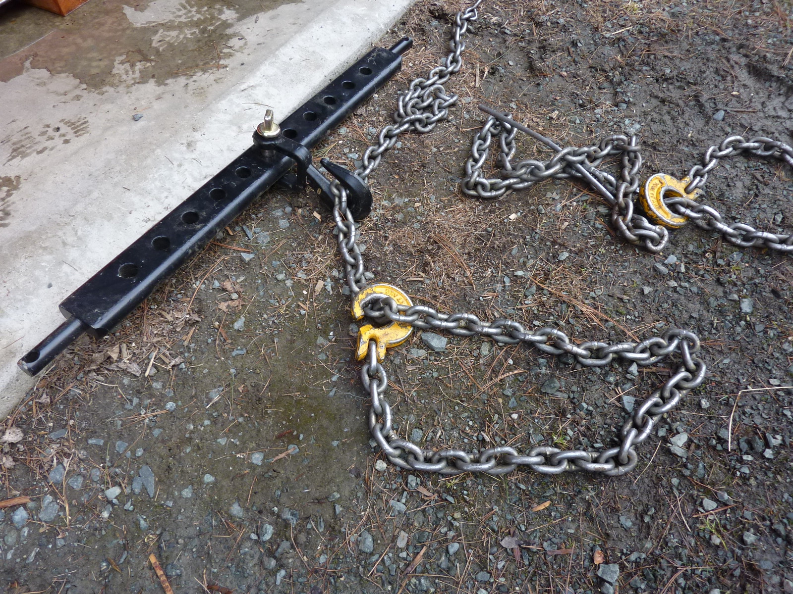

I have thought and thought about what you were trying to tell me and have finally grasped your message. I knew the front end lightened when using the lift arms as a pulling point. I thought this was solely from the weight of the log. What I didn't comprehend was that some of this front end lightening that I feel is due to the horizontal pull acting on the angled lift arms thru the 3ph components as you said. Now that I see it and the mechanics of it are so basic and obvious I am embarrassed to have not realized this before and even more embarassed it took me so long to see it after you told me.
So I was wrong in stating the horizontal pull force is always at the lift arm connection point to the tractor below the axle. I agree that it moves upwards as the lift arm raises above horizontal.
Thank you for your patience. And I apologize for spouting misinformation on this great forum.
I can now see the merit of running a chain from the raised log to the draw bar to keep the pull force at a low point. What a great idea.
gg
... No need. I really appreciate you persisting in analytic mode. These things only become obvious when all the almost correct diversions can be appropriately sorted. This perspective is not easy to see or to convey. I have a real hard time eliminating all the stinkin thinkin pitfalls as I try to turn the concepts every which way in my head.
Pardon me for addressing one of your statements that I think you are correct in, but leaves room for an interpretation that would be an "almost correct" diversion. >> The pullpoint is moved upward to the endballs when the arms are held up above the horizontal. If the tractor then backtips there will come a point when the arms are horizontal. At, and beyond that tip angle the pullpoint moves to the arm/tractor ball articulation attachment point [Which unfortunately for this issue has a location so near the axle that it stays at constant H during tip.].Effective pullpoint stays there after the arms become horizontal during tip and while they float to their max H. Here they encounter resistance forcing the endballs down below horizontal. THEN the pullpoint reverts to the ball ends.Tip is now becoming less favored, but it is already tipped a lot, perhaps beyond balance ... and even if not, the loaded components are not designed for loads that push on them and will probably fail as the ball ends near ground, and allow tipover.
As unlikely as it is to get a tractor into this situation, certain changes from what the operator is used to and has come to expect can increase traction or influence another factor so much that all previous "safe" use is moot. Fitting chains to industrials would likely be such a critical change. To deal with the significantly more aggressive pull in a manner favoring maximum performance with safety the physics of the tractor system must be applied in as wholly complimentary a fashion as possible. The designer has provided features that can let you do this conveniently. The configuration challenge is left to you.
.... Baby Grands configuration affords access to every advantage; =] You can lift as much of the load weight as you want or can with the hydraulics, =]You can tie the load to the fixed drawbar with a little slack, =] as you move forward the load hangs back and, if it wasnt clear of the ground to start, more lift force acrues increasing traction, =]you can tune the setup by varying the amt of lift, amt of slack in the forward tie, and height and length of the drawbar. ... You can tailor it as far as the point where you are supporting as much as the big end portion of the load and all the tractor on the rear wheels and be in a stable safe pull with the front wheels hovering at the ground. Any further backtip is automatically stabilized in 2 ways; 1]reduction of weight supported as you have said, and, 2] dipping of the drawbar end causing a lower pull point. Seems to me this might be the absolute limit to the pull available and as safe as you can make it.
Could be fun!
