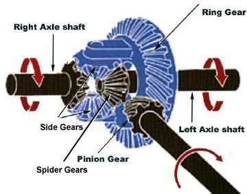

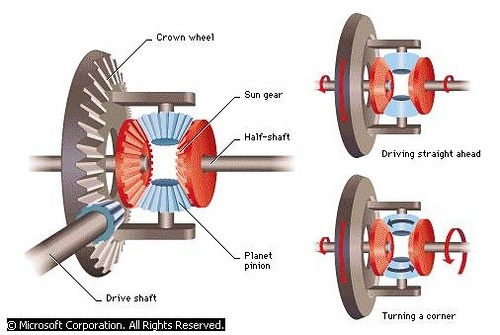

Ring gear diameter. This gear is fixed to the axle via another set of gears.
Pinion gear diameter. This one transfers the engine force to the ring gear and has the ability to rotate around the axle. You will note that the pinion centreline is fixed to the frame which is fixed to the axle housings which hold the axle bearings allowing the axle to rotate in the bearing. Stop the axle rotation and the tractor frame can rotate around the axle. Bearings help that out a lot!
And the distance from the center of mass to the rear axle. The force vectors exerted are functions of sine and cosine angles the tractor has to the horizontal.
There are even some spyder gears mixed in there.
Good. Absolutely, level ground for the simple case. [We can handle slopes too, but why complicate matters when we are stuck on the very principles of Mechanics.] Now pick out the stuf you need to know to simulate it identically. I know its hard - all those twirling gears and bearings. But when you understand it its easy. For an easy example see Post#291 and 297 where there is a small edit for clarity.
