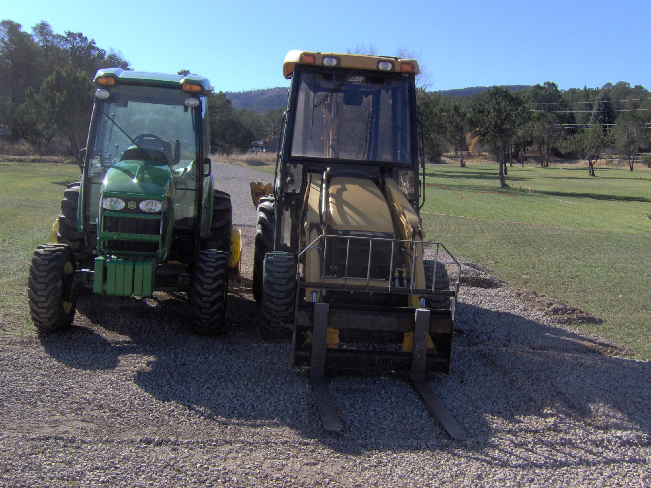

I think a 4520 or 4720 would be a good addition to your 110 but not a good replacement for it. I had the same concerns as you mention and kept my 110 and added a 4520 without fel this has worked out very well for me. If you want the power and convenience in an all in one machine look at a Kubota M59, 60hp hydro tlb.
Here's a pic of my solution.
