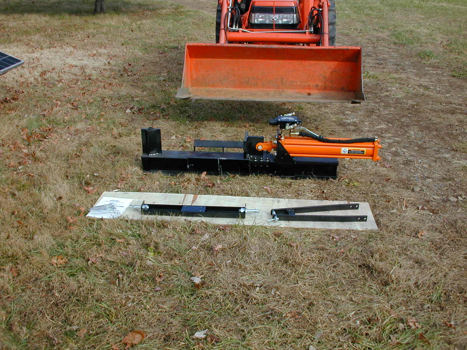

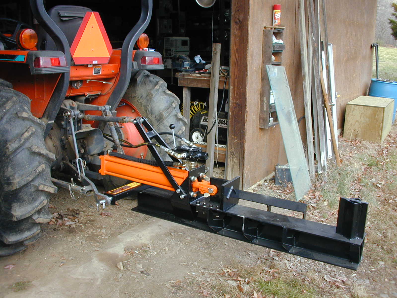

As I mentioned my HF 3 point log splitter came in about 3 weeks ago and I had to wait while my local Kubota dealer ordered the wrong QD coupler for me twice before I got the correct ones to match my L3010 FEL controls. I had the splitter on my tractor using it for a dead weight while I hauled some gravel out of my creek during my wait and two of the bolts that hold the top link support sheered off just like they were cut with a bolt cutter. I replace all four bolts with Metric grade 8/8 bolts, the ones that came with the splitter were grade 4/8. The splitter arrived from HF in about 20 days and I met the delivery truck on the county road and unloaded it from the truck with forks that I fastened to my FEL. The unit assembled in about 20 minutes and the machining tolerances were good and every thing bolted together easily. Once my QD couplers came in I hooked it up and split a PU truck load of firewood with my wifes help in about an hour. The splitter worked great, not speedy, but neither am I after my heart attack. Based on my experiences so far, I can recommend this splitter, it seems to be well built, short of the under-rated bolts and should last a long time. Here are a few pictures that I took when it arrived.
Mike

The splitter arrived from HF in about 20 days and I met the delivery truck on the county road and unloaded it from the truck with forks that I fastened to my FEL. The unit assembled in about 20 minutes and the machining tolerances were good and every thing bolted together easily. Mike
Mike, thanks for the pictures. That's a really nice crate and packaging for the price of that splitter. I'm impressed.:)
