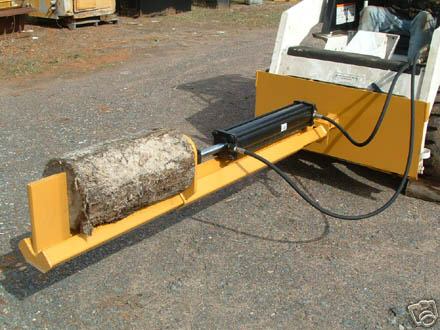

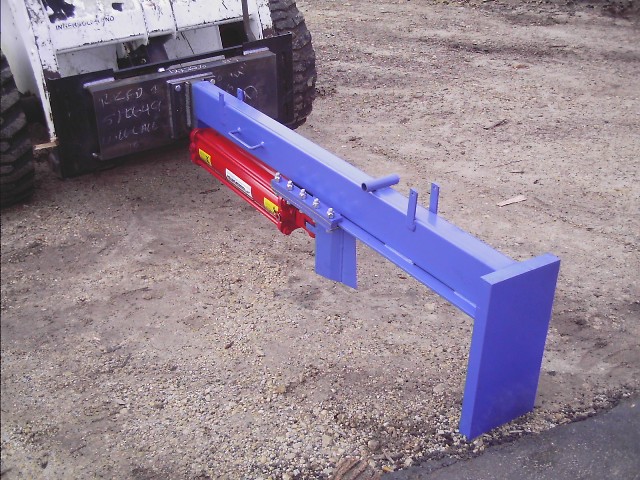

Have you considered building a log splitter . Here are to samples
