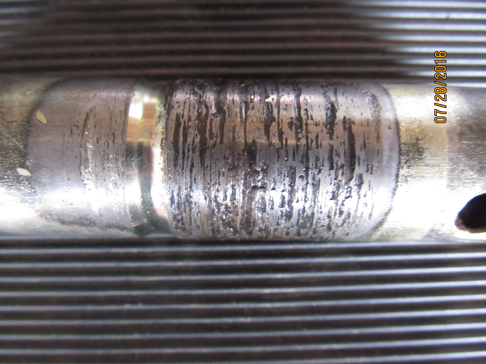

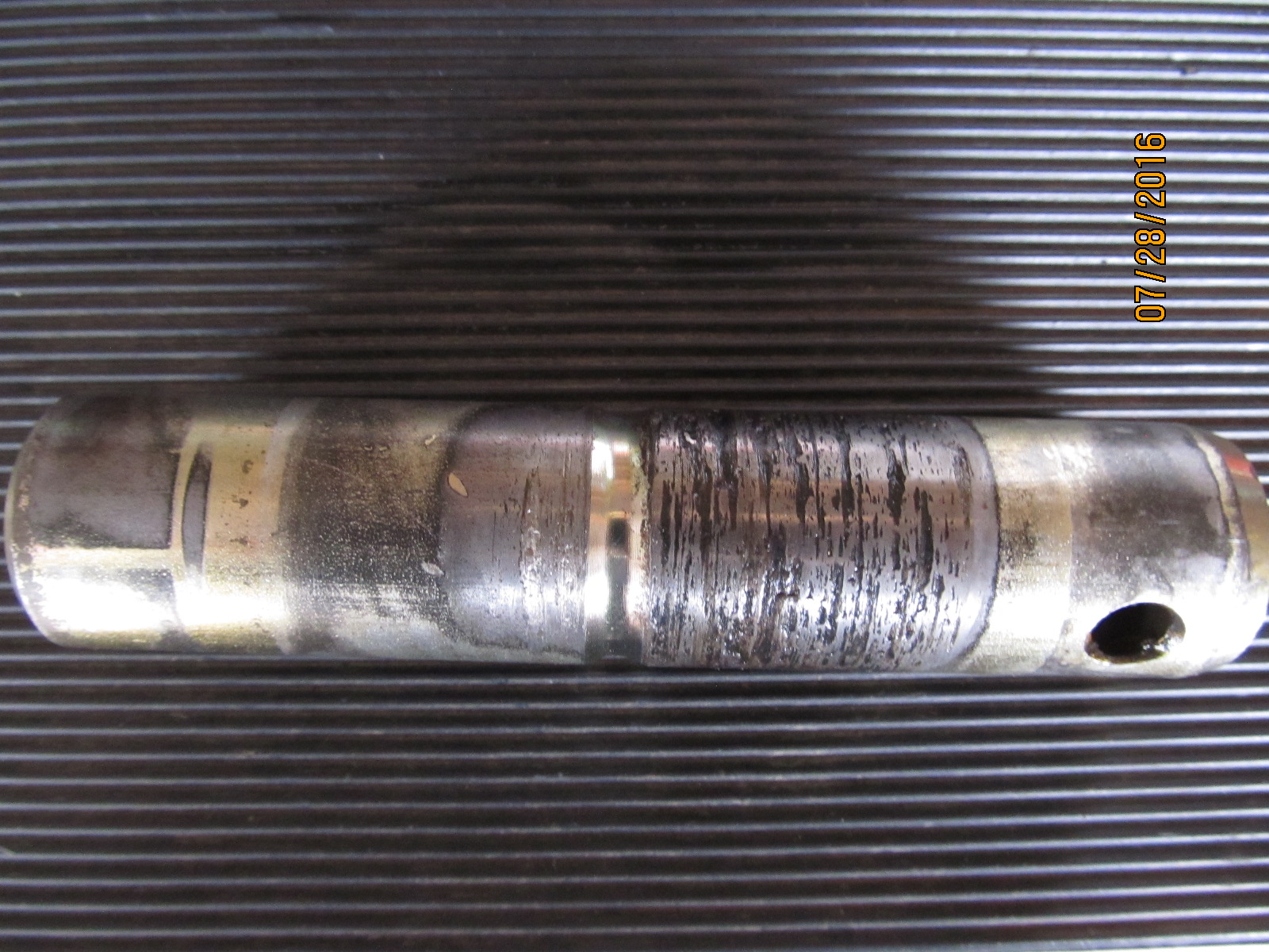

Post #1 is a classic "death by grease starvation" situation.
Have you ever heard of a machine dieing of grease poisoning? I haven't. Grease is cheap compared to the cost of repairs, but lazy and stupid are 2 things you can't beat.

That had to be making horrible noises ..for quite a while.
Actually , no horrible noise but a mild straining sound. Nothing that would alarm the uninitiated while even more damage was done..

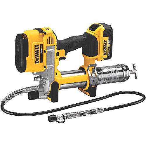

Merry Christmas everyone, and Hope you either have one or Santa brings a cordless grease gun... So much easier especially with a lock and lube end.
