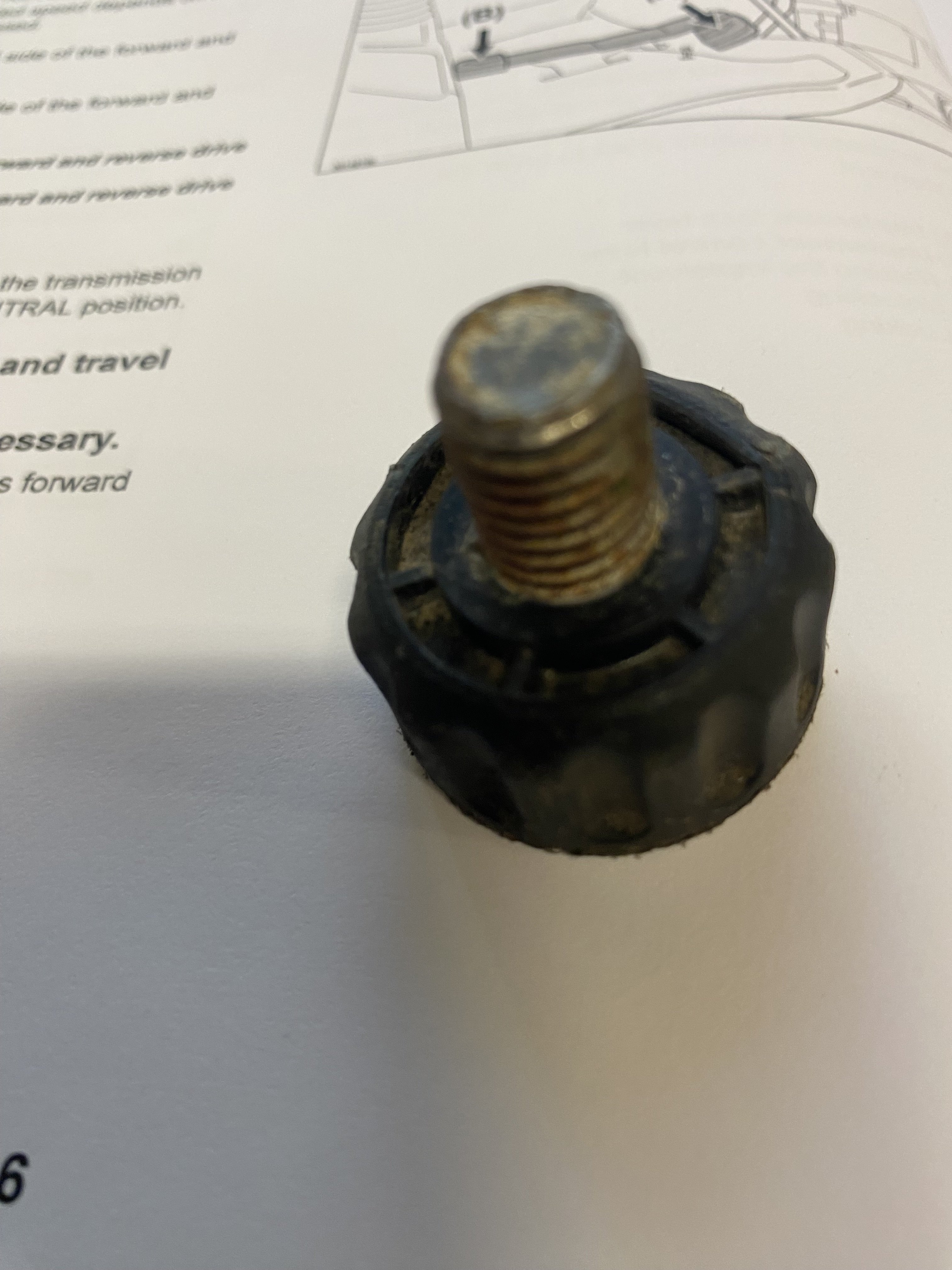

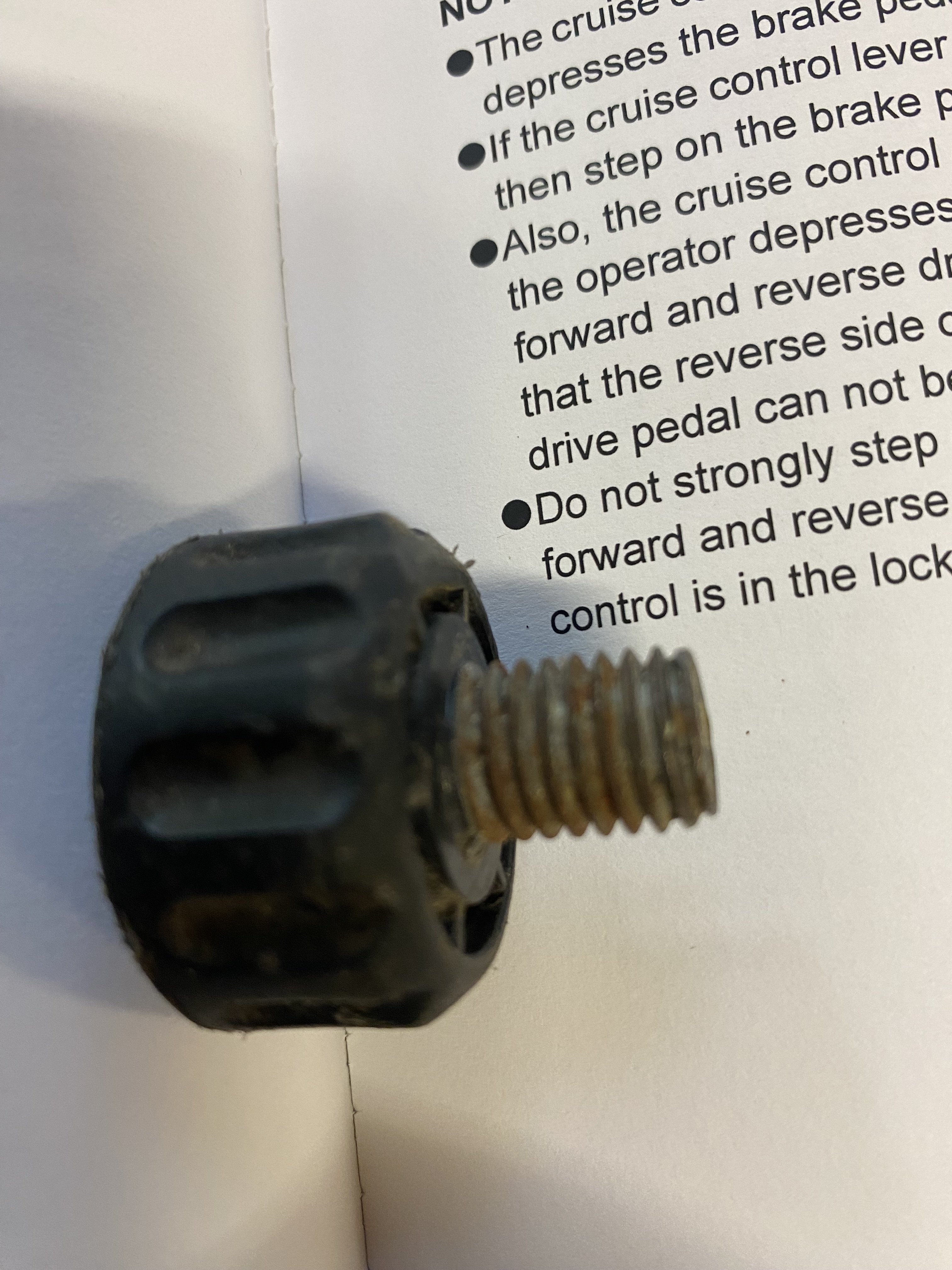

I’m having similar issues having just transported my Yanmar EA2400 back home, couldn’t get it to reverse and found this locking thread under the tractor, I idea where it has dropped out of though. Any clues?
