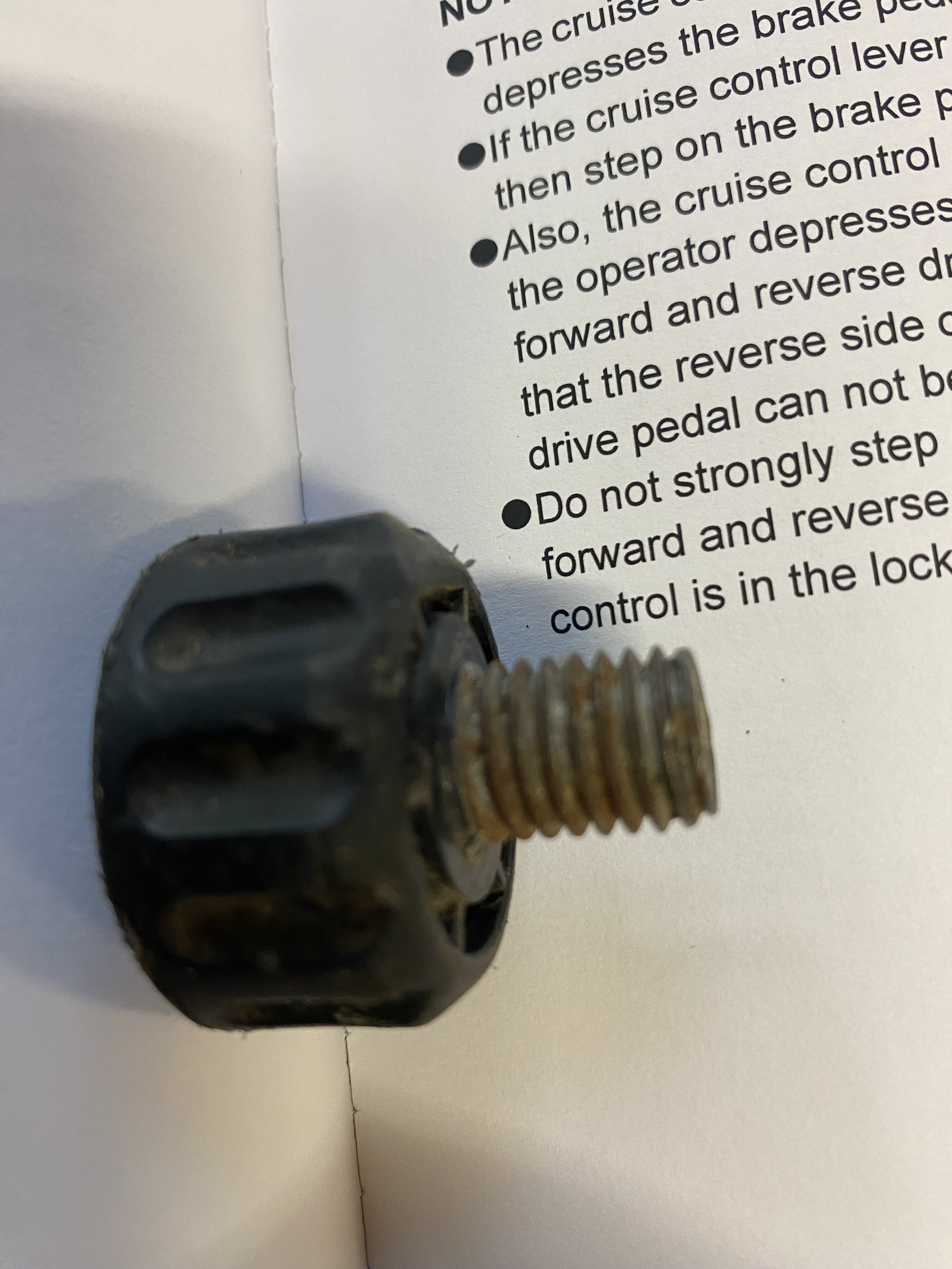

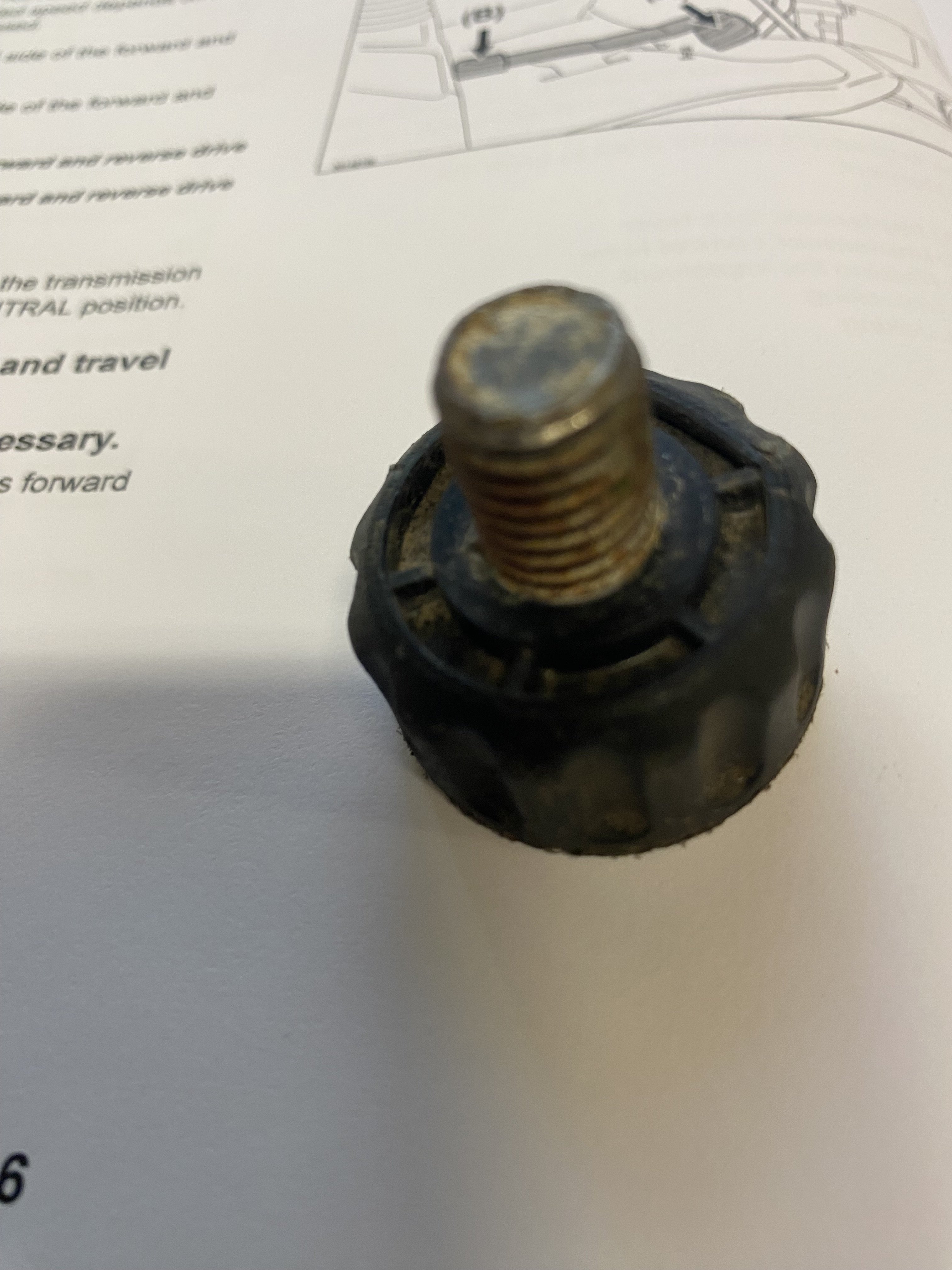

I’m having similar issues having just transported my Yanmar EA2400 back home, couldn’t get it to reverse and found this locking thread under the tractor, I idea where it has dropped out of though. Any clues?

This is the issue that I just ran into, bad reverse check valve. I just had the reverse go out on my SC2450...stopped in at the dealer and before I could finish describing what happened, the service guy said he knew what the issue is.
Apparently there was a batch of the check valves that were manufactured such that the crimp designed to keep the check ball in place let the ball escape.
I take mine in tomorrow, they said they should be able to fix it in about 30 minutes, that is if they can retrieve the ball from the case with a magnet. If they can't get the ball out with a magnet, they have to go a little deeper. He did say of the fixes they have done, only in one case were they not able to get the ball out with a magnet from the topside.
Just thought I'd put this up here for anyone else searching for troubles with losing reverse on their SC2400 / SC2450...
Have the dealer talk to the service dept at Yanmar, when they had that issue Yanmar replaced the valve with a new & improved style, they should have one,
