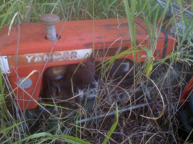

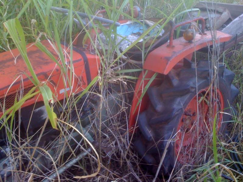

Any pics? I've never even seen a picture of one.
/ Help with yanmar y177 ? #10
Here's the best I can do..
/ Help with yanmar y177 ? #11
/ Help with yanmar y177 ? #12
They are very rare. I would say there was only a few hundred imported at the the most, just from the lack of info there is on them!
