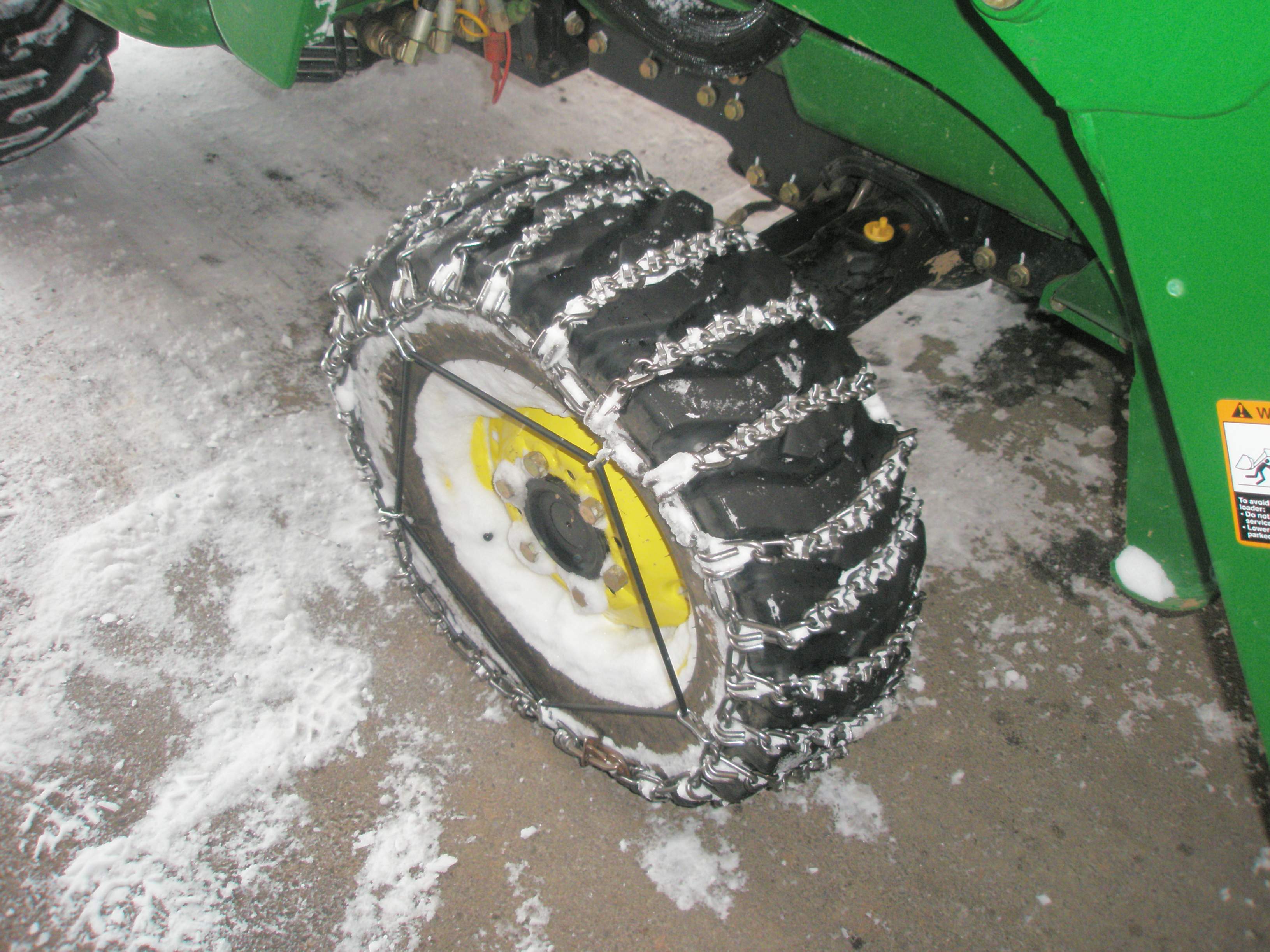

Didn't catch which tires you have r-4's or ags, with my r-4's I put reg 2 link spaced v bars on the front. Yes some of the chain falls between the lugs but still plenty of of chain on the surface for superior traction,
I guess with ags you could loose all the chain between the lugs, with straight 4 link spacing.

Your tires and chains look like mine. Although I've had my tractor for some years, I am, in many ways, a novice. Can you give me more detail on the 2 link spaced v bars? I don't know what they are, and I didn't notice anything in the picture.
Thanks, too, for the picture. Visual aids help me a lot! :D

Zoom in on that picture, you'll see the cross chains are spaced every 2nd link on the side chain as opposed to 4 link spacing and there are v-shaped grippers welded to the cross links.
