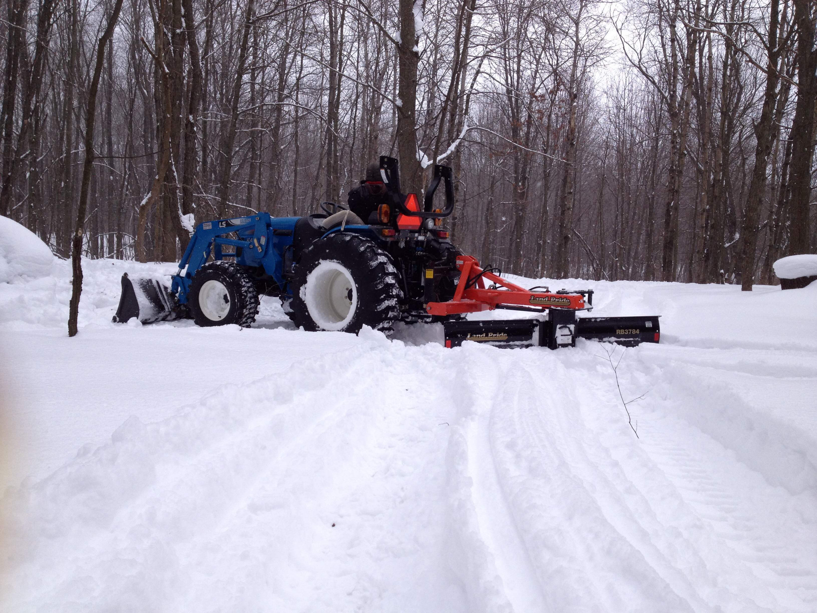

I'm trying to pick up a tier 3 tractor before they are gone but keep going back and forth between sizes.
It will be used to maintain a 20 acre Laser Tag battlefield, gravel entrance and 70 car parking lot. The battlefield areas vary from wooded to city type scenario fields. Tractor would be used to bushhog the entire property a few times a year. Loader work for construction and maintenance of the field areas, and the drive and parking lot maintenance.
I like the 3038 just not sure if I should go bigger. 3039 or 4041. Worry about the maneuverability of a bigger tractor in wooded areas. And the parking lot maintenance with a smaller one.
Thanks
Brad

I have a 4041 and am very surprised at how easy it is to maneuver, I get around in my woods easily. Very pleased with it so far. (43 hrs).

I use my R4047 in heavy woods very frequently, and it's not a problem to maneuver in tight spaces. Besides, it's got enough power to move most stuff out of the way if you really need to :D
In reality, the difference between a 3038 and 4041 is pretty minor when it comes to size, and being able to move through the woods. If you had barn stalls to fit in, or a narrow doorway to go through, it would be different....but it doesn't sound that way.

Figure 5 PTO HP/foot of brushhog and you need 30 HP to swing a 6 ft cutter. Width saves a lot of time. For 5 ft or less pull a Swisher behind an ATV. To level field with a box blade, weight is your friend so heavier tractor is better. And I can't think of any reason to have smaller FEL. Go big!
