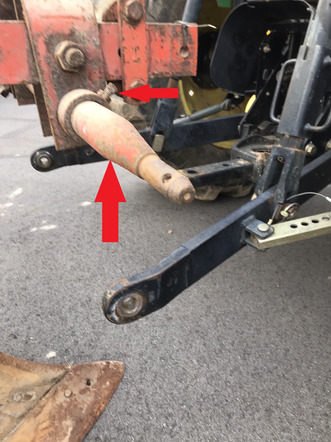

I picked up a 2 bottom plow today for next to nothing. Turned out to be too good to be true- the plow has cat 2 pins, and my 4720 is cat 1. Turns out the 2 bottom used to be a 4 bottom, hence the low price tag.
Any ideas on how I can make this work?

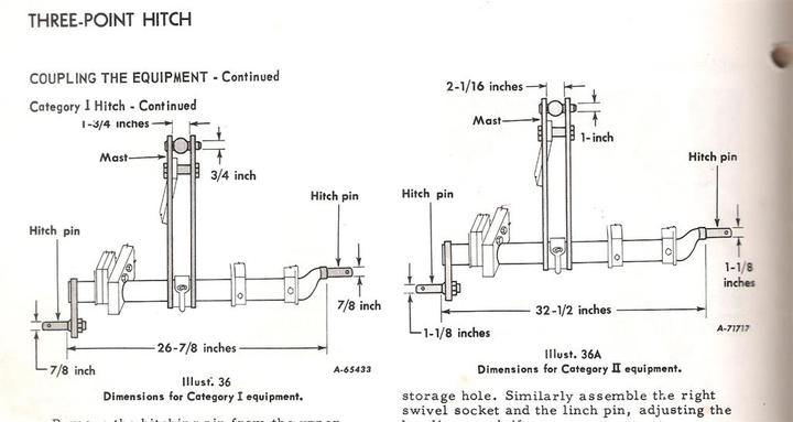

It would be a job but ends of the shaft could be cut off and then CAT1 7/8" pins welded on. It would require a piece of heavy flat iron to provide the correct offset for the right side (near side) pin.
The CAT2 pin on the far (left) end could possibly be turned down to CAT1 in a lathe with a large enough hole thru the headstock.
I'm assuming that the shaft can be slid out of the right side of the plow to make it easier to modify in the shop. The shaft would end up shorter but that should be fine since a CAT1 is narrower than CAT2.
The picture shows CAT1 and CAT2 but looking at them from the front of the tractor rather than the rear.

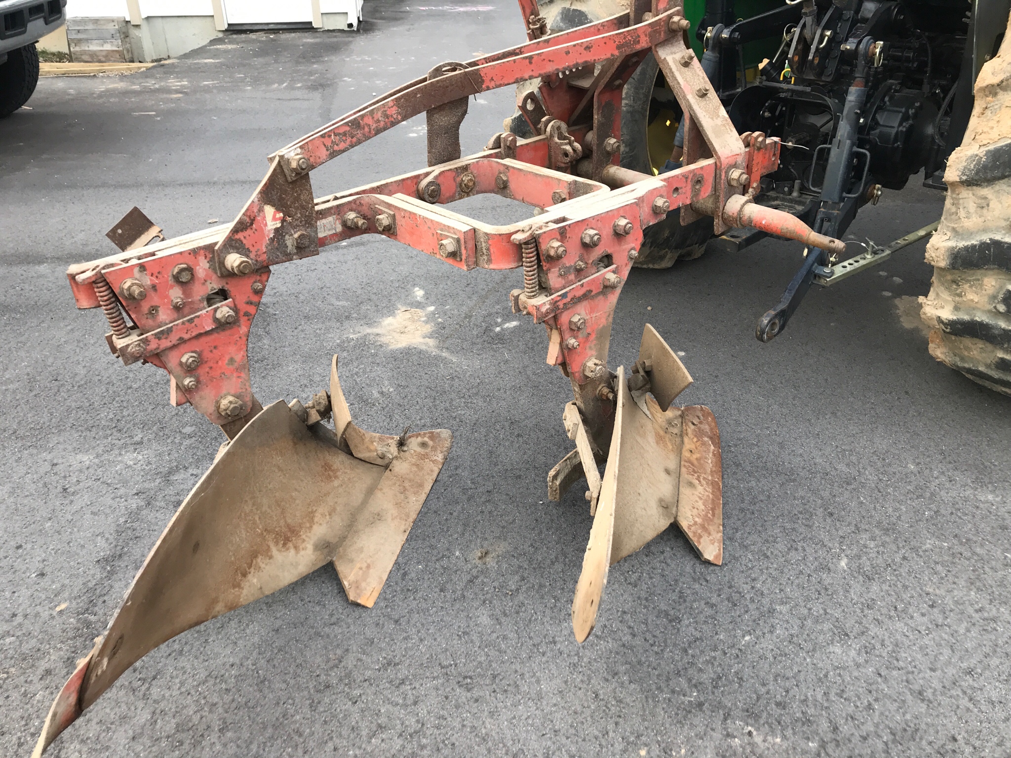

Sorry for the delay here, I did receive the Pat's quick change setup suggested and it worked extremely well- I had it ready to go in 15-20 minutes. I got such a deal on the plow that ordering the kit even if only used on this implement still makes sense. If I ever run into a situation where I find another implement that is Cat 2, I'm all set.
A local farmer buddy pulled through while manuring fields with their big spreader and spread about 15 yards of composted manure on my garden Wednesday so I even got some guidance setting up and running the plow! He was skeptical about pulling a 2-16 plow with the hydrostatic trans in my 4720 but it worked great and the temp gauge never climbed.
