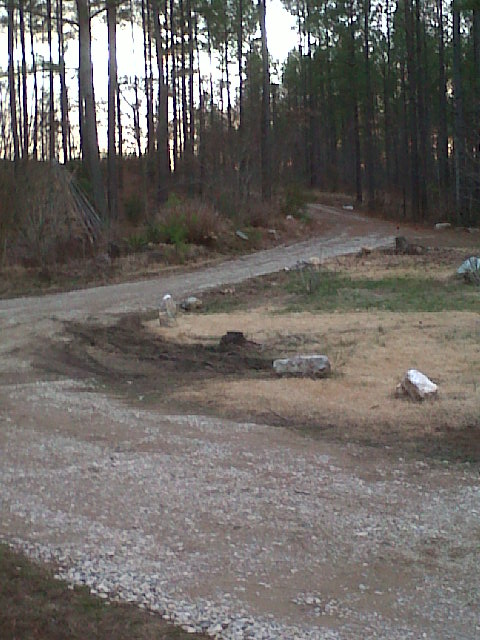

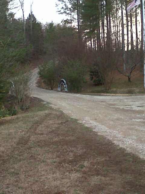

I've been considering this exact idea (I would need to wash out the bucket first though!) my biggest concern doing it this way is actually that I must somehow drive UP the very steep driveway without spilling all of the water...
In addition to seat time, I would get bucket feathering time.
Pic 1 and 2 are the steep side. Pic 3 is the less steep side...
BTW - I was planning to use the bucket to haul the water box/basket BlueRiver suggested up the hill also!
