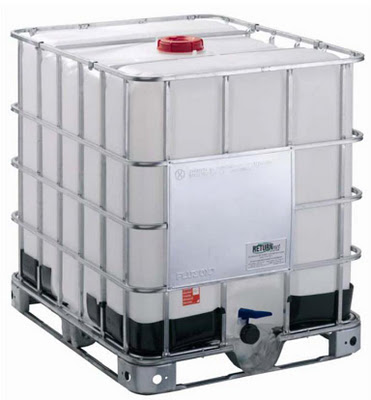

Ok... My horses are about a week away from moving in. I plan to have a second well put in somewhere up in the pasture or preferably the new home site area, but until then, I need a simple way to haul water up the hill to the pasture from my home.
I'd love to find a US Army surplus water buffalo trailer, but other than that, anybody got any good ideas for hauling 50 gallos or so of water up to the horses?
Also, if I surround the water trough with sand bags or dirt (like a raised pond?) will I get the benefit of it not freezing as badly? Is there a solar powered water heater to keep their water from completely freezing?

I see you have a FEL. How about a 55 gallon-food grade barrel that you carry in your bucket?

Around here we can find the 250 gallon totes in a metal gage and are forklift compatible for around $75 ... I have one and when I need water in remote area I use either the carry all or the pallet forks ... you can gravity feed or install a 12 volt pump. I also use it for water supply to the field when spraying.
