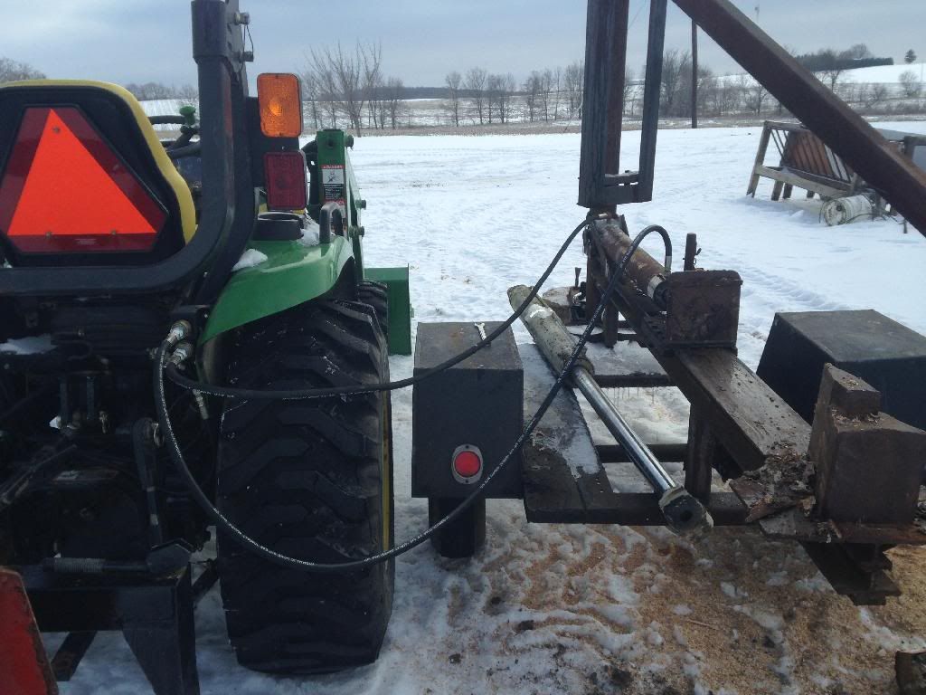

I Just purchased a craigslist project to finish. As it sits it is a trailer mounted splitter with a 3.5" x 32" cylinder mounted on a light beam with a fixed wedge. It also came with a 4.5"x 32" or 34" cylinder. Right now none of the hydraulics are hooked up and there is no motor. The trailer has a boom mounted and the previous builder was planning to switch the cylinders and use the 3.5" on the boom.
My plan is to use this on my jd 4310, 8.6 gpm flow and 2500psi, for now and maybe eventually turn it into a 3ph splitter.
So now on to my questions,
I would like to build a light duty hydraulic winch to use on the boom instead of the lift cylinder, so I can drag cut pieces (up to 150lbs) up to 25' away to the splitter. I am planning to use a hydraulic wheel motor https://www.surpluscenter.com/Hydraulics/Hydraulic-Motors/Wheel-Mount-Hydraulic-Motors/28-3-cu-in-HYD-WHEEL-MOTOR-W-5-BOLT-HUB-9-8092.axd with a 8" wheel for the winch. For the hydraulic experts what can I expect out of the wheel motor with my 8.6 gpm flow?
For control, I have two options planned out, either a electric valve control with a remote https://www.surpluscenter.com/Hydraulics/Hydraulic-Valves/Solenoid-Valves/12-VDC-5-GPM-OC-MOTOR-SPOOL-HYDRAFORCE-SOL-VALVE-9-7988.axd after the single spool splitter valve. Or a double spool splitter valve with the lines to the winch tee'd with a ball valve in between so I can free spool the winch out. Any recommendations on which way to plan this?

Your motor speed at 8.6 GPM will by about 70.
Torque about 11,266 lbs using 2500 psi.
Your log slitter valve will have to have PB to add the solenoid valve.
You could add the solenoid before the log splitter valve and use a regular log splitter valve.
The solenoid valve will give you full flow all the time.
You can't tee open center valves. They must be in series.
You could use a valve with float and be able to pull the winch cable.

70rpm with an 8" wheel/winch spool (25" circumference) ~72 Feet per minute just under 1mph would be plenty fast and likely need slowed down. The electric winch I was looking at is 13fpm. So I may need a flow control with the electric solenoid.
Wasn't planning on teeing the valves, I was thinking about putting Tees in the lines between the valve and wheel motor with a ball valve in between the two lines to provide a bypass, open the ball valve to freewheel the motor.

Here is what I'm working with. I picked up some hoses today, it does work.

Can I use the prince rapid extend valve Prince Rapid Extend Log Splitter Valve - Hydraulics, Pneumatics and Power Transmission at Beiler Hydraulics with my tractor @ ~8.6 gpm? And will there be any advantage as the cylinder has 3/8" fittings?
Thanks, Jeff
added info when I was testing the splitter in the picture above, I was running the tractor just above idle (~1200rpm) and had plenty of power. If I run less then full rpm my flow shouldn't be near the 8.6 Gpm mark.
/ Help with hydraulic winch for splitter build #14
I don't think so. That valve was designed for low GPM, about 4 to 5 GPM.

Thanks J_J, see my added info above, if I am running the tractor half speed or less my flow wouldn't be near the 8.6gpm. Do you have any idea why there is a max flow on that valve? To much restriction in the regenerative mode with more flow?
Thanks again,
Jeff
/ Help with hydraulic winch for splitter build #16
I am assuming that it has to do with the size of the orifices in the valve.
