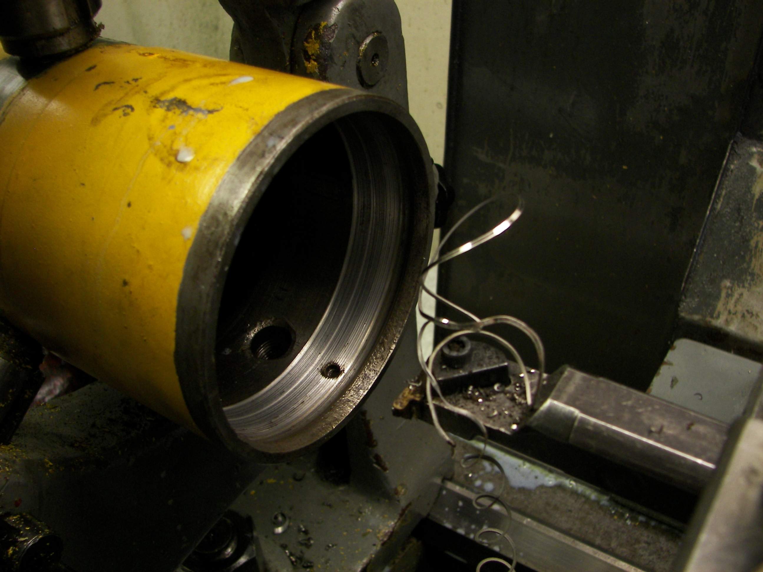

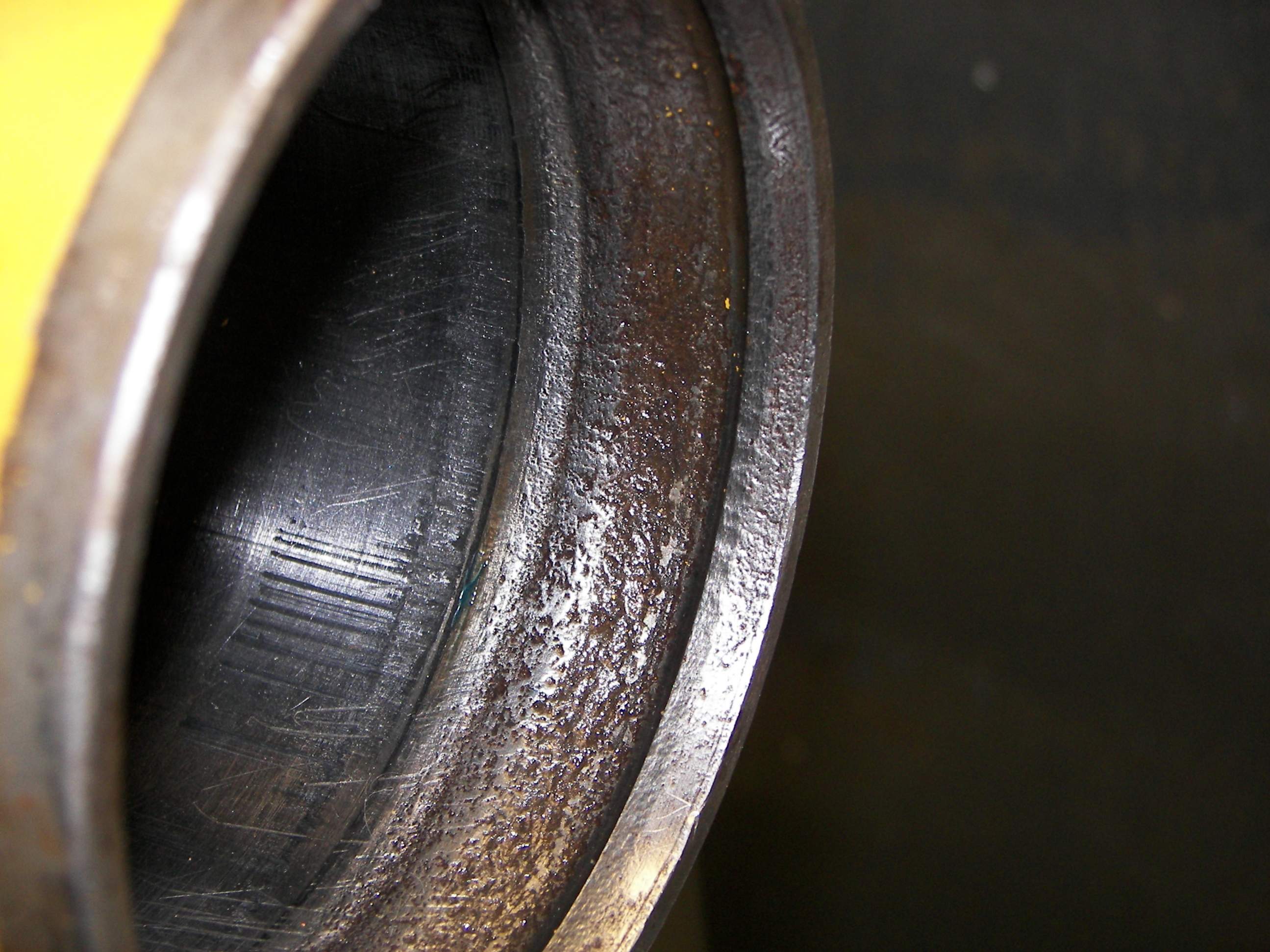

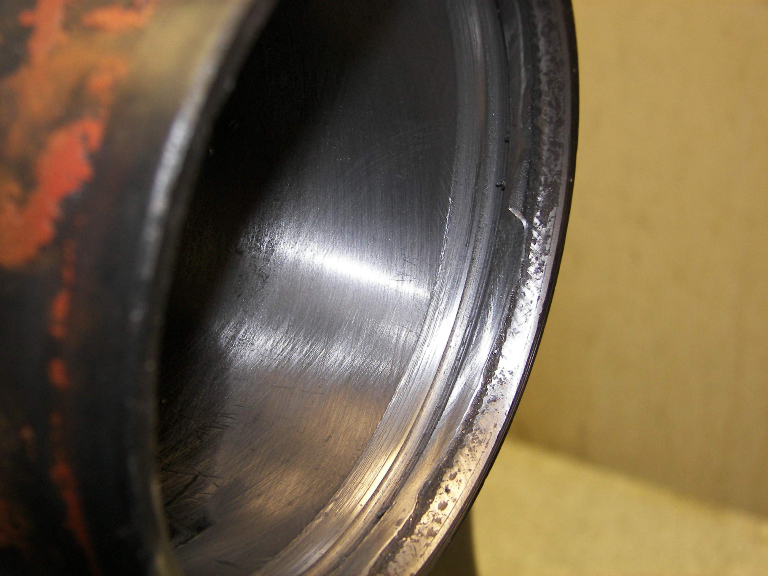

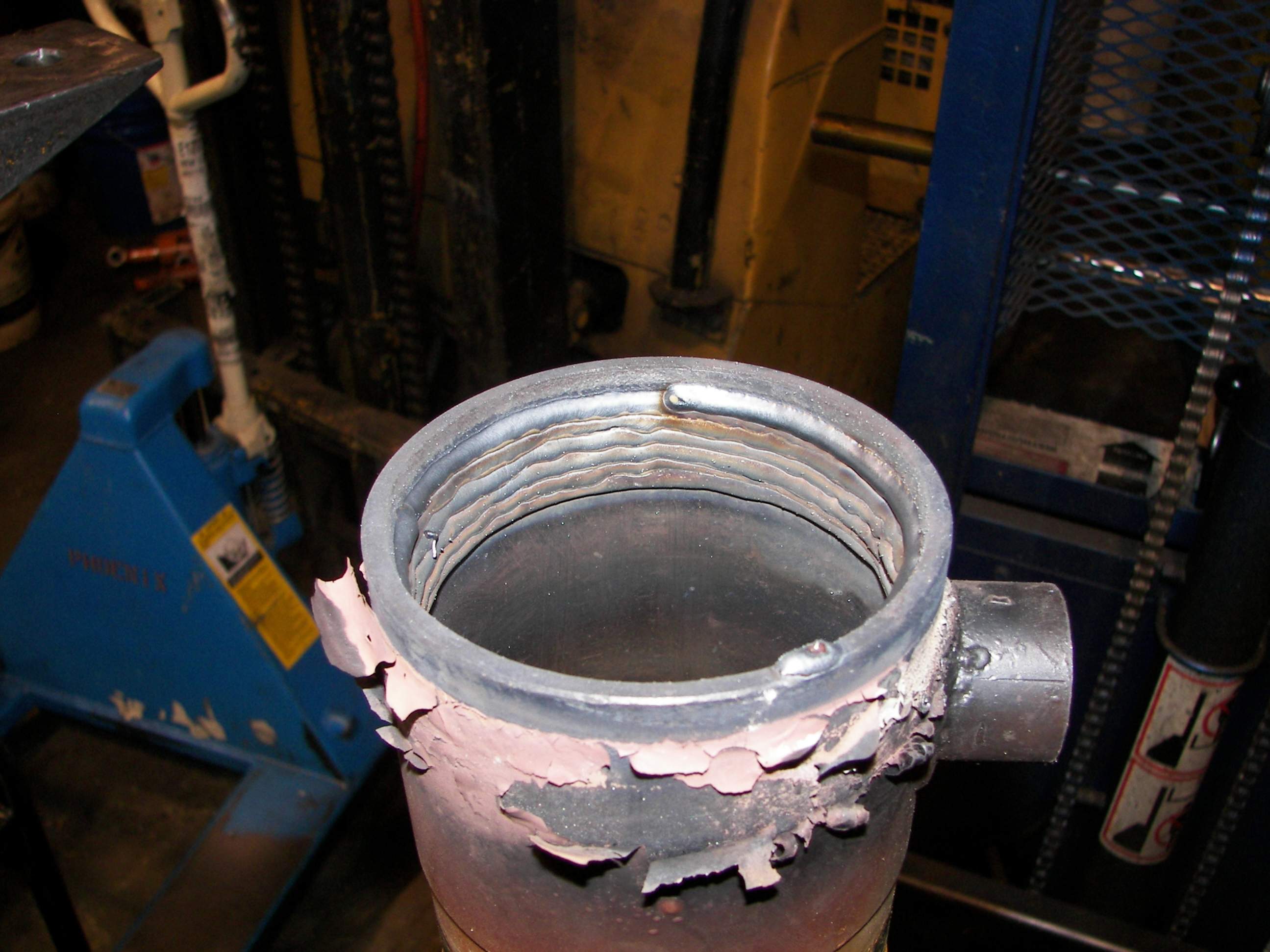

Just a note to show you a similar situation that a customer ran into recently.....This one from an older Hough Payloader....
The first photo was from a cyl that was repacked over & over & over & over (well you get the point).......it needed some TLC at the gland like yours.....
Once machinined/welded/remachined and honed, the seal/groove area was ready for repack with another fresh set of seals.....
Like Rollcenter said "HIGH QUALITY work is not cheap".......unfortunately some of my best work gets hidden inside the equipment I'm working on and sticker shock does happen when repairing worn out/rusted equipment...
Hopefully your other local repair guy is a good welder and machinist.....

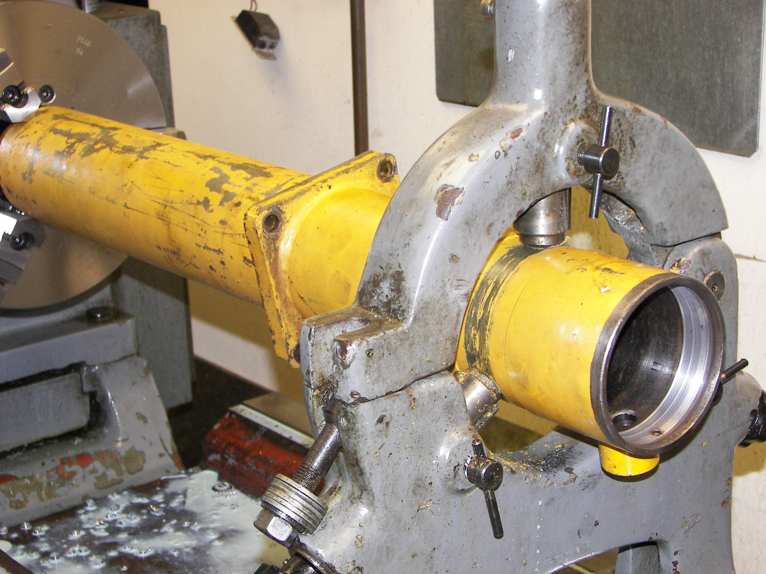

Here's the same cyl barrel.....
