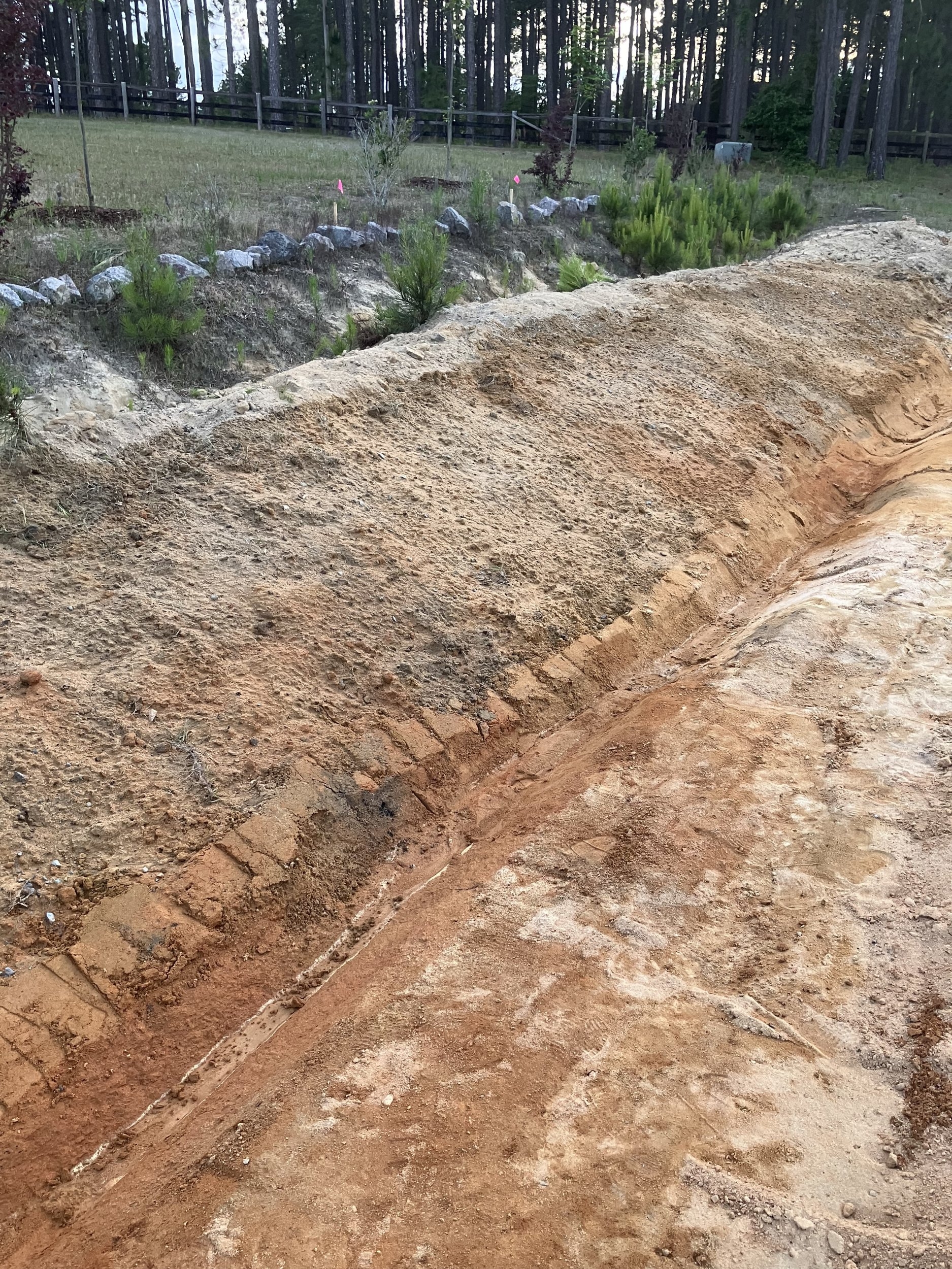

Alright see below for pictures:
Photo 1 is looking down the drive. Center you can see the small ditch, then immediately right of the ditch is what I’m calling the berm, even though it’s just a slope:

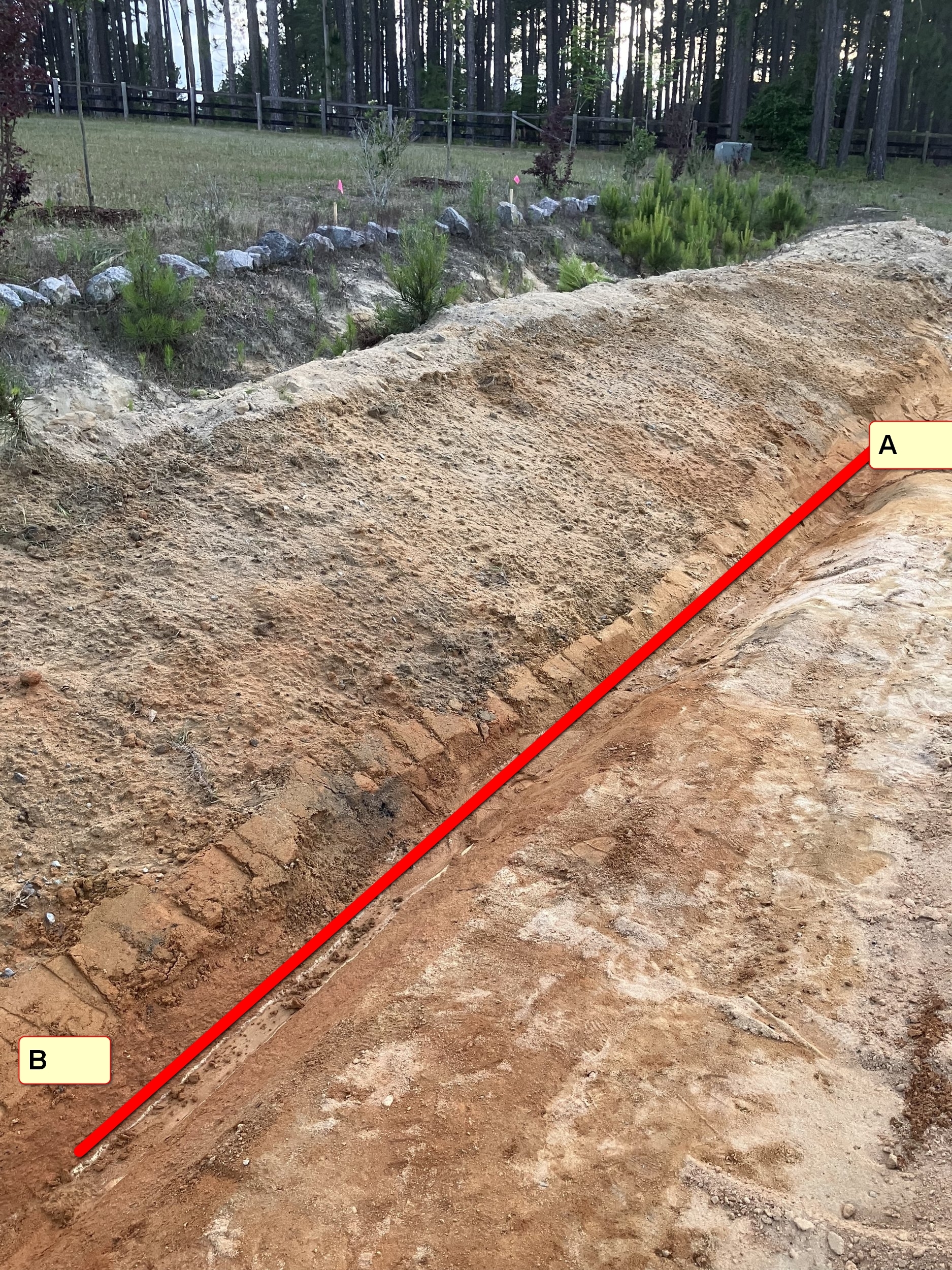

Photo 2 is looking UP the drive, from the downhill side. Ditch is to the center and berm to the left in the photo. Just a better view to show the ditch and berm.

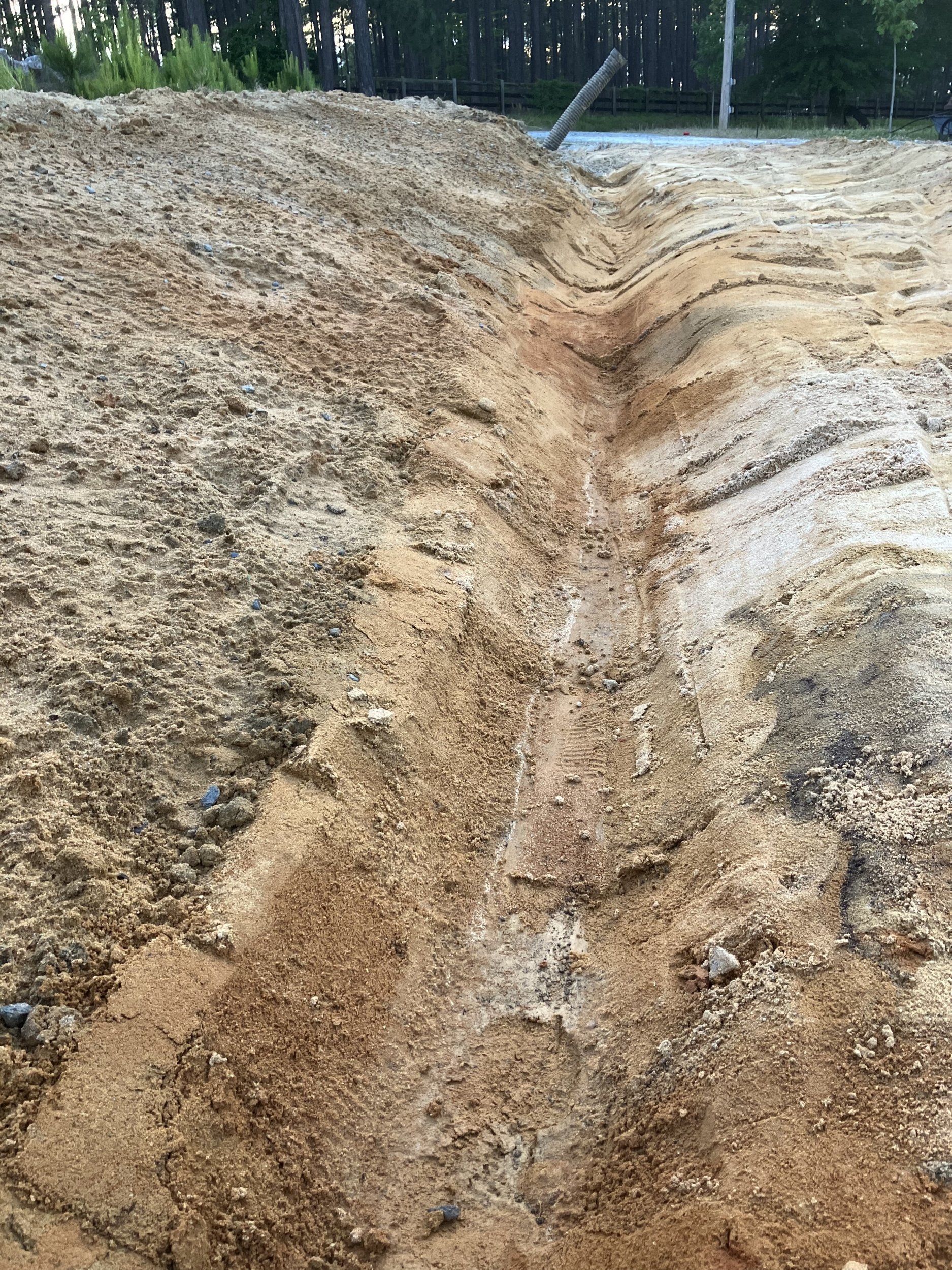

Photo 3 shows the hastily measured angle of the berm. About 20-25 degrees.

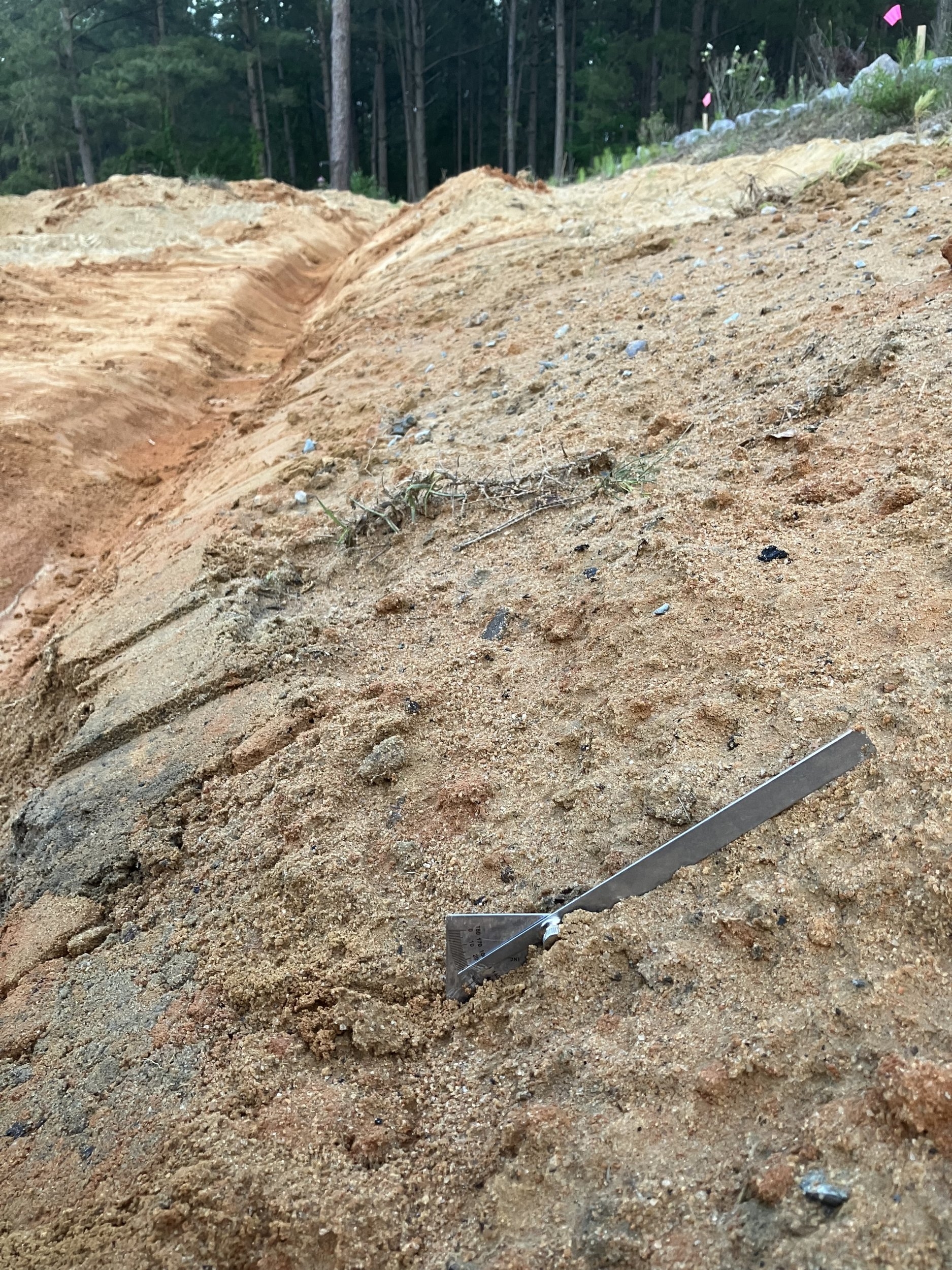

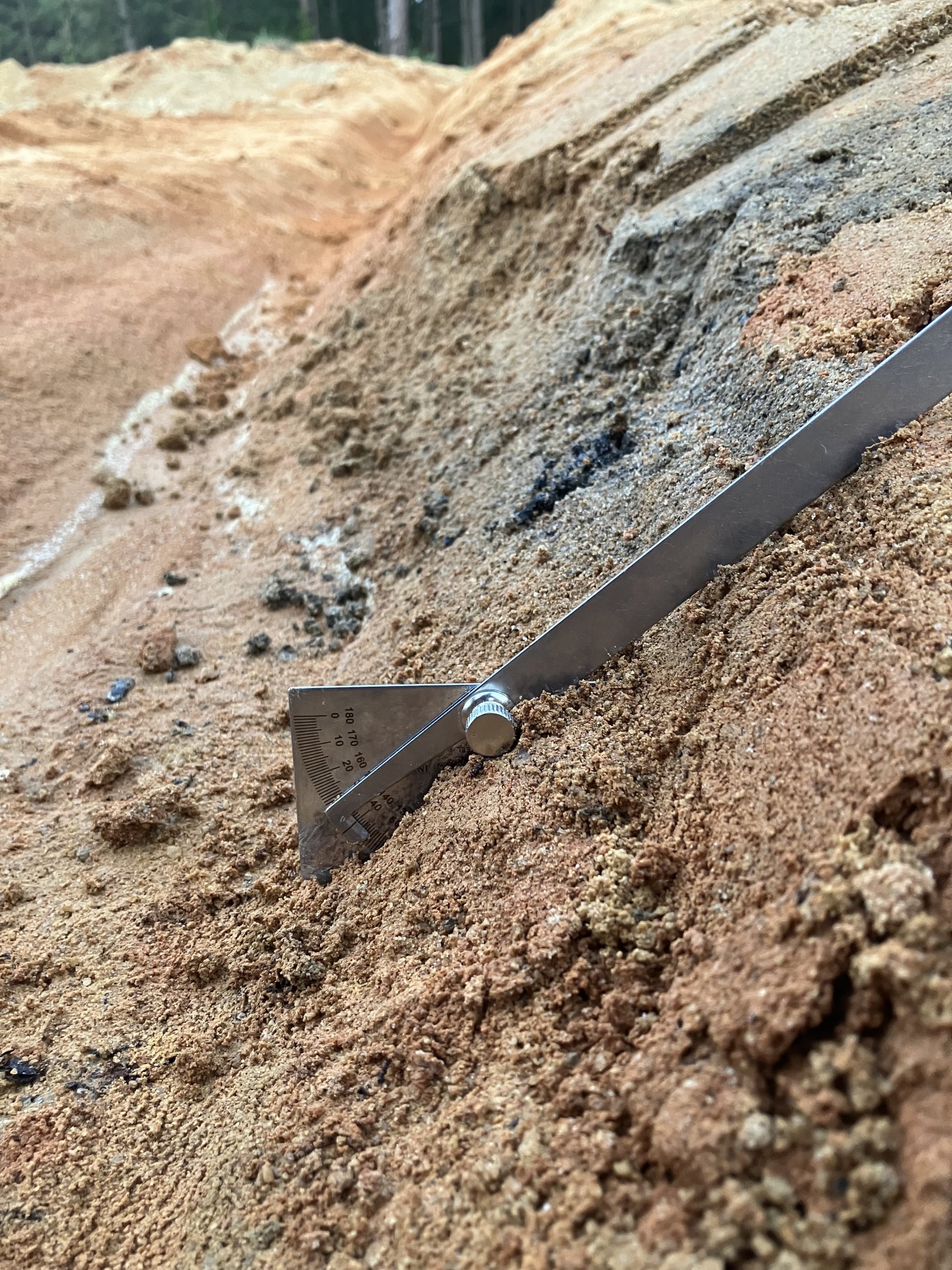

Photo 4 shows the angle of the ditch, about 30-35 degrees.

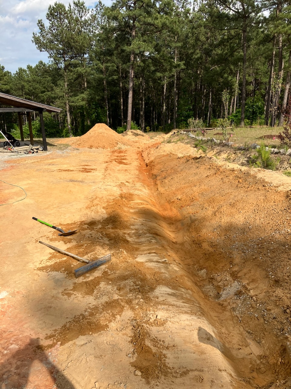

And here’s another photo for reference:

I apologize again for not communicating well. I meant to ask how much the grade of the ditch falls over its length from one end to the other--like from A to B.
