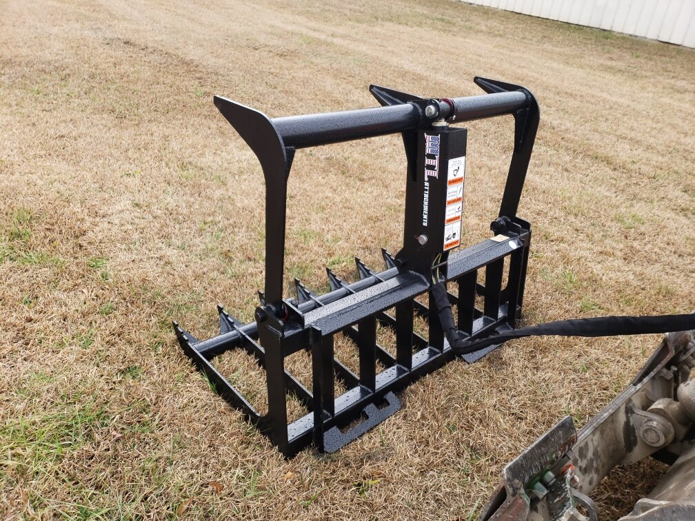

I agree that the cylinder looks to short.
Mocking up with PVC, wood, etc is gonna be easier than all the math in the world. Because some things are easy to overlook in terms of clearances and binding angles.
For example.....with the cylinder base mount offset forward of the lid hinges.....the grapple lid wont ever be able to open much beyond just parallel with the floor. Otherwise the hinges will break over-center and the grapple wont close.....or will try to close backwards.

I am looking for help in trying to find the locations to mount a cylinder on my grapple.
From the pictures I have looked at, your cylinder base pivot needs to be behind the lid pivots:
And you need a longer stroke cylinder.

Thanks for the help guys. I talked to a buddy at work who is a mechanical engineer in training and he is going to draw something up to see if it will work with the design i have. I am basically trying to copy this design for the grapple lid. 48″ Compact Tractor Root Rake Clam Grapple Attachment Fits Skid Steer Quick Attach – Skid Steer Attachment Depot
He also suggested adding another tine to the middle of the lid and extending it past the back of the top frame and lid pivot points and putting the cylinder on the back of the grapple. Similar to the below design but only one cylinder on the middle tine. Its only a 48" grapple so putting a cylinder on each outside tine on the back is not an option because of the SSQA. I may just go this route. If I did my math correct, with an attachment point of 8" past the pivot point, I should have just over 2000 pounds of clamping force, which should be plenty for its intended purpose.

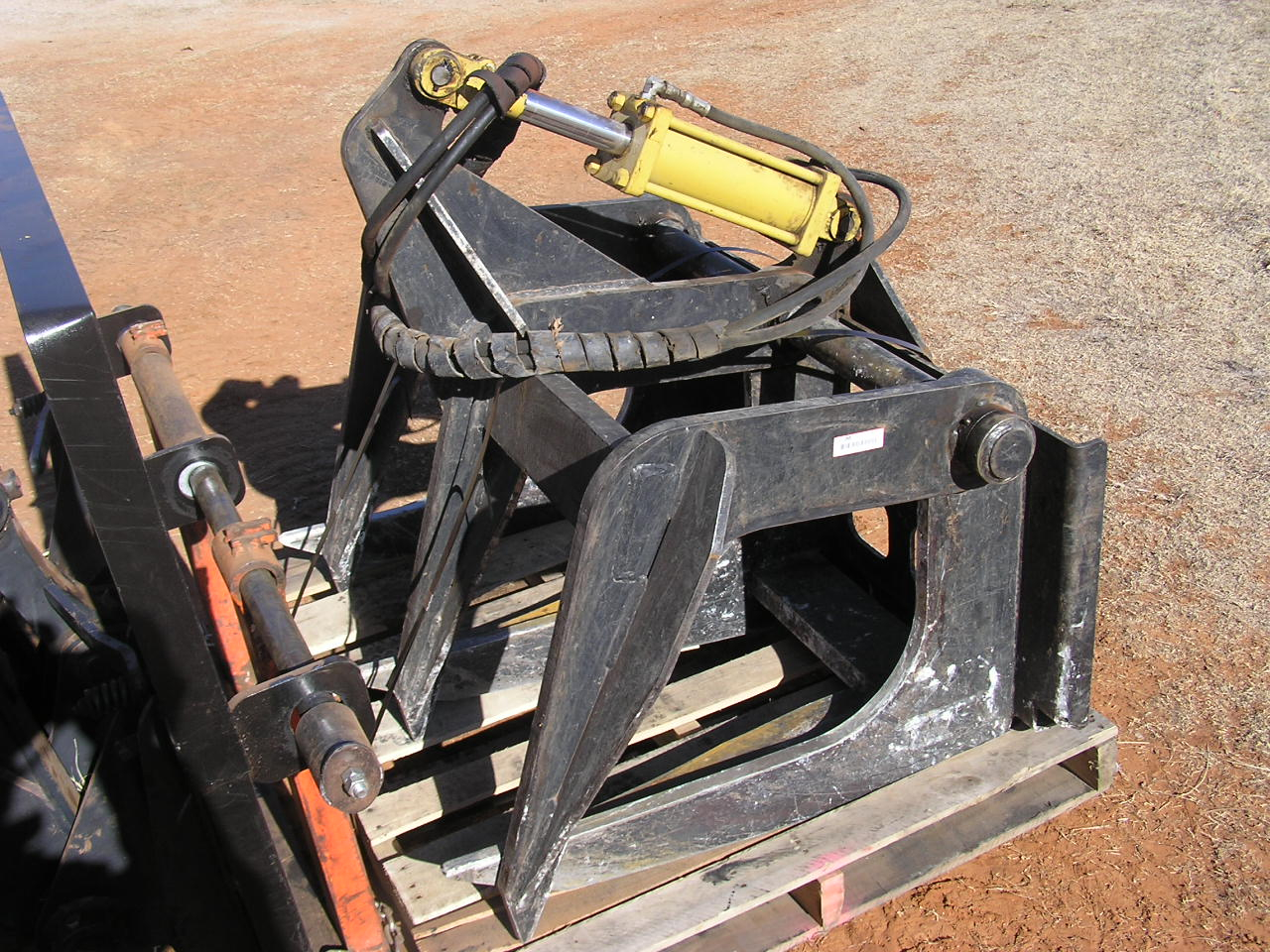

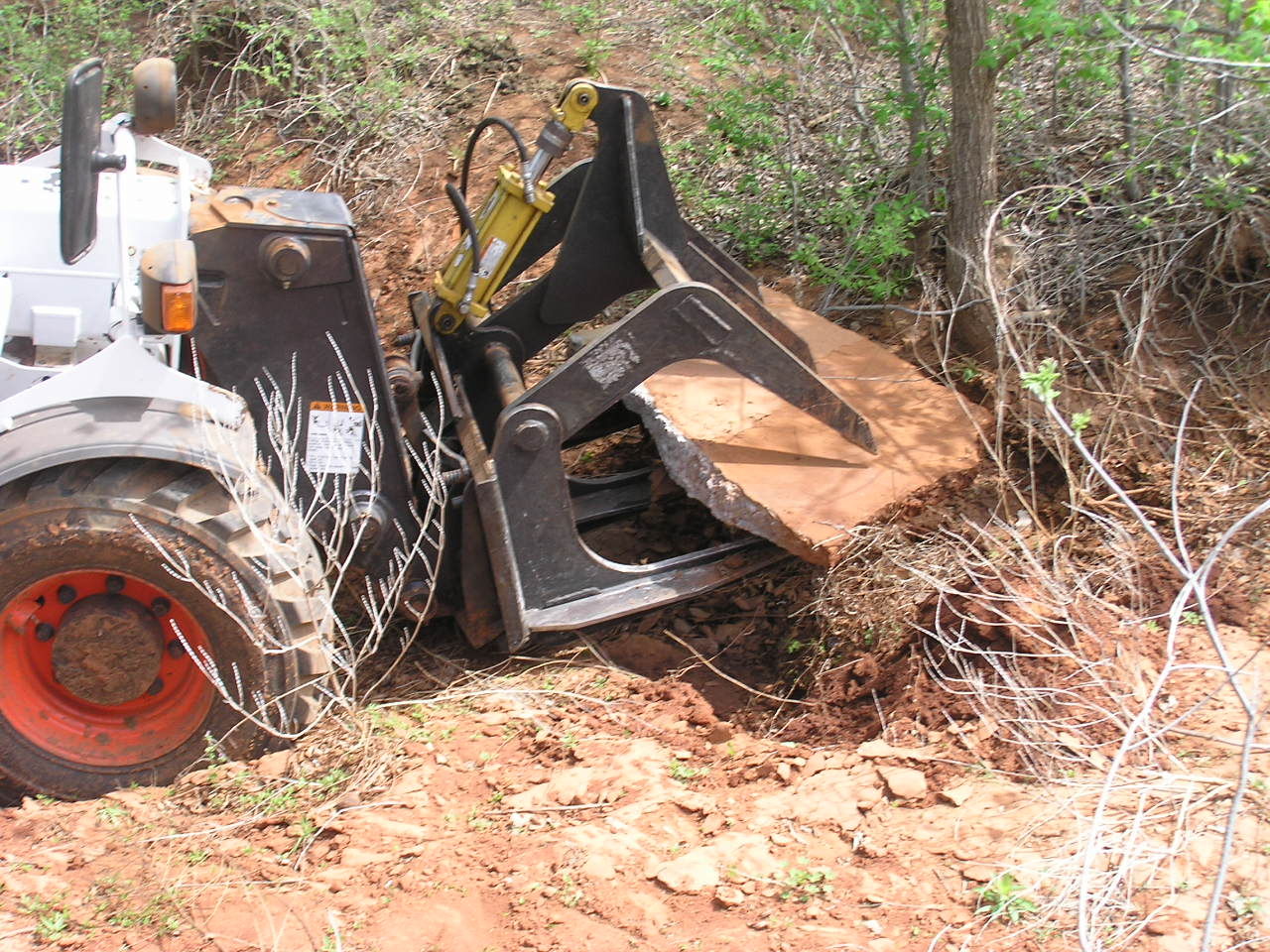

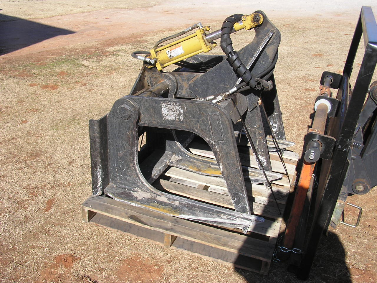

The rear cylinder pin needs to be higher than the lid pivot pins by at least a few inches. The more distance apart they are the more clamping force you would have. It looks like your cylinder pin and lid pin are almost the same height. The grapple lid pivots really should have been closer to the frame to make it more practical to make the cylinder pin higher. I’m 100 percent sure that the current cylinder is too short to provide a decent opening angle.Here’s a picture of my grapple and demolition bucket for reference. The grapple has a good opening angle but the demolition bucket would be better if it opened more.
