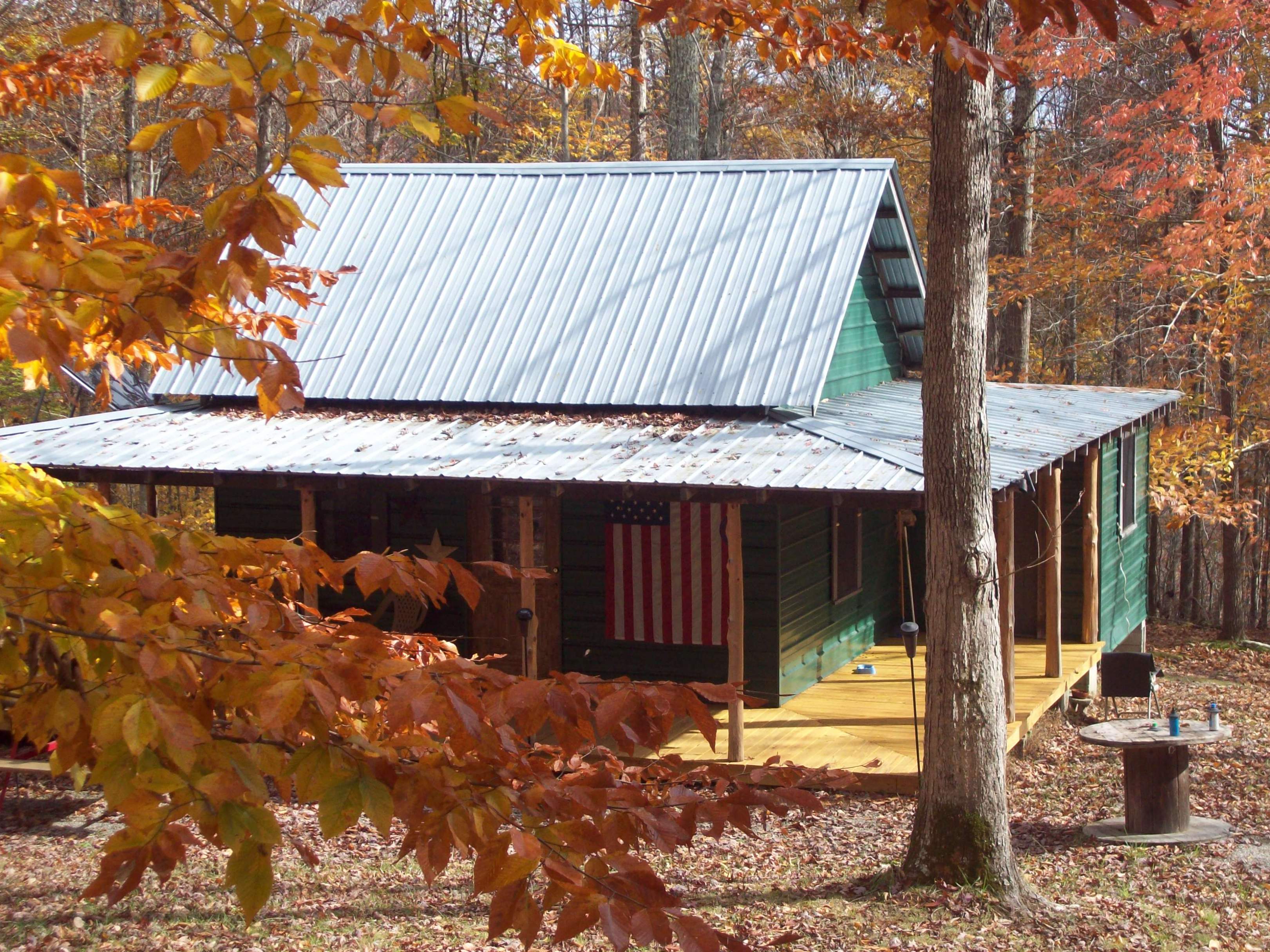

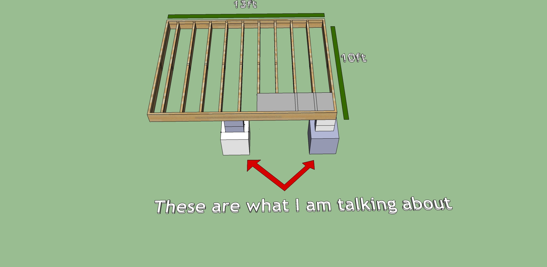

First thanks in advance for all your help.... I am adding a Room to my cabin. I was wondering if anyone could tell me how big the pads need to be for my block pillars. I will try to attach a picture of what I am asking but if that fails I will do my best to explain. The room is a 10'x13'. Two of the sides will be attached to the structure already in place. The soil is very stable. I am not worried about what code is I just don't want the "footers" to move. I will try to attach the pics now....wish me luck.:)

I was told different things by different people....one said 4 inch slab the other said 2ftx2ftx2ft.... The one I know is not enough the other seems a tad excessive.

Wouldn't hurt to what "CODE" recommends for your area. Footers need to be set below the frost line and to have good drainage and should be rebar reinforced. A basic rule is continuous wall footings are twice the thickness of the wall wide plus the thickness of the wall high. A pier footing should be at least 2'x 2' square x min. of 10" thick.

I know that in central Indiana, the bottom of your footer should be 30" below ground level, and if it was at least 10" thick and 2x2 square, you should be good.

A 2'x2'x10" thick footing will be sufficient for vertical loads. Place the bottom of the footing on undisturbed soil a minimum of 30" below grade. Not sure what part of KY you are in but be aware that your proposed framing method will rely on the connection to the existing building to resist wind and seismic loads. The piers will not offer much resistance to those lateral loads.

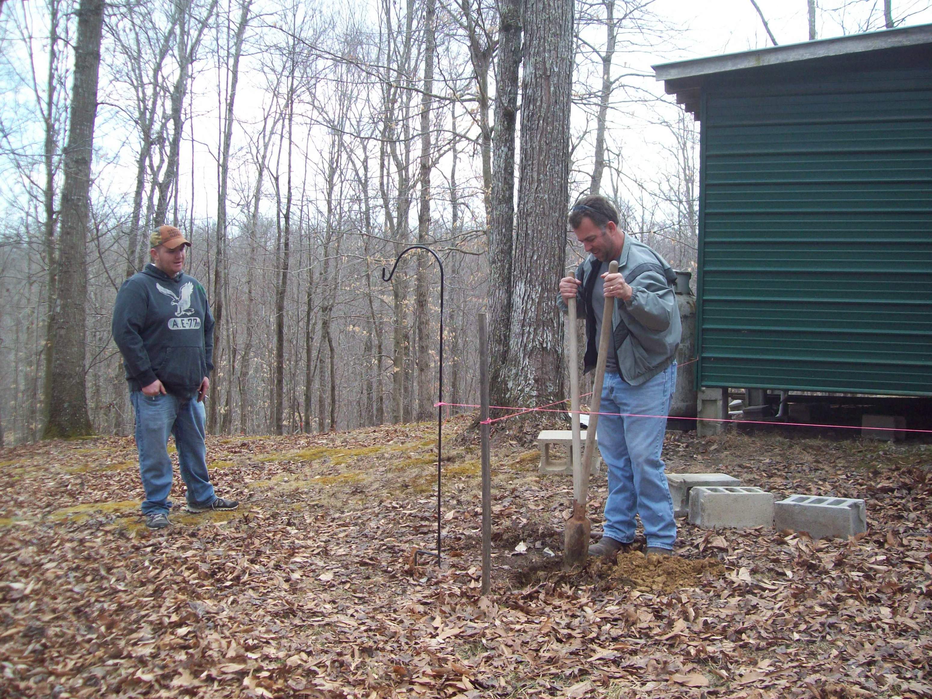

Thanks for all the feedback guys, as always a big help. I started digging yesterday and ran into sandstone about a foot down. I am pretty sure 2 feet will get it where it needs to be. Plus I am lazy. Think I found another excuse to use the backhoe :D Thanks again. I will try to post pictures as I progress.

No need to go 30" down if you are on rock because it will not heave when frozen.

I you hit bedrock you can drill a hole to insert a piece of #5 rebar and use 10" sono tube to create a column. Don't forget to insert some kind of connector in the top of the column to attach your beam. I would put in 6 columns as 13' span will require a large beam, especially if the if the wall above is load bearing. No one wants a boucey floor.
