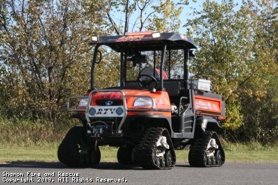

Opps, uploaded the wrong file, lets try it again.
Just another way of moving things across soft land. Very old school.
