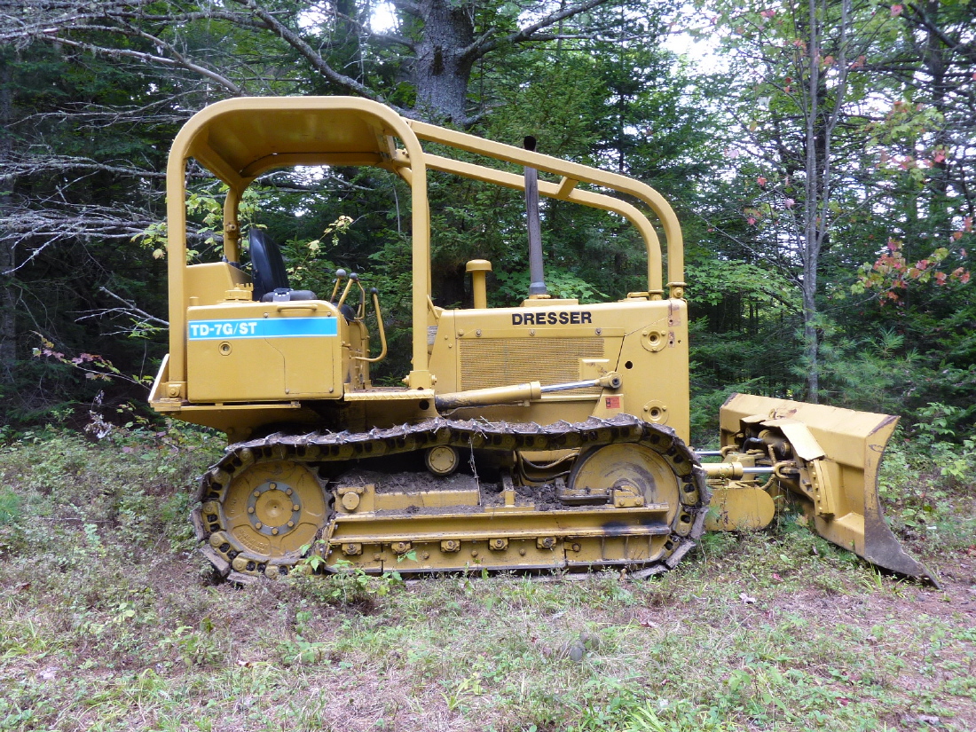

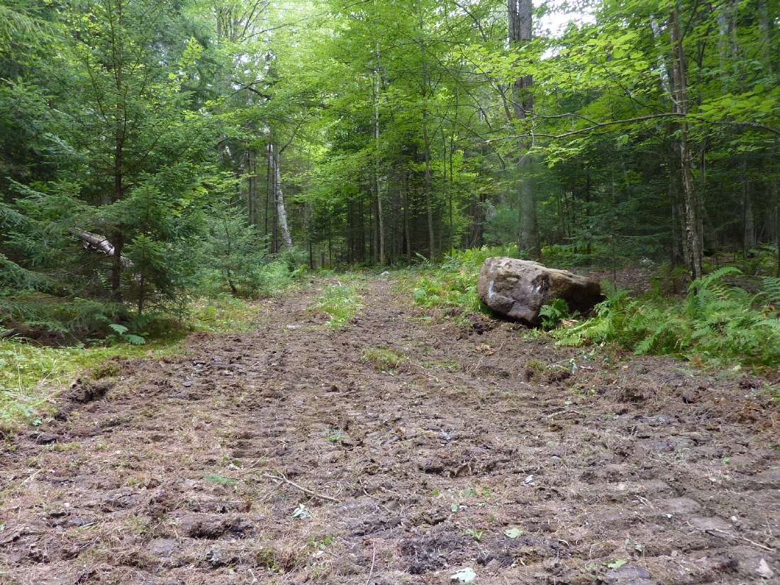

You didn't say what kind of road you want to build or how big your tress are. That and your buget would determine what you could go with for a dozer.
I have a little Dresser TD7G that I use for woods roads. It does pretty well for what I want to do as far as pushing smaller trees and popping rocks and is fairly manuverable in the woods. It weighs about 15,000 lbs.
Make sure you know what you are going to do the the stumps and root balls before you start. They mount up and get in your way fast.
