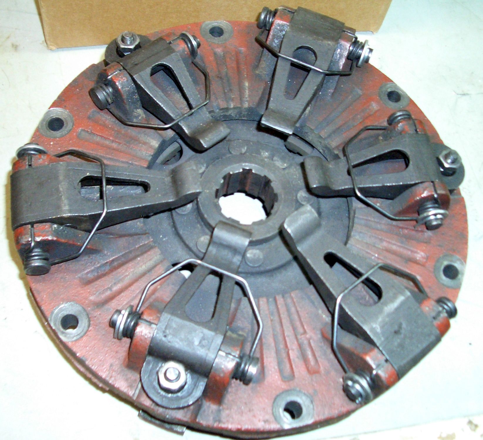

I have a new 2008-09 284 Jinma and would like some adjustment info on the 6 finger clutch witch this tractor has, but my manual show the 3 finger adjusment.., and my parts book will show the 6 finger but no info...
any body have these measurements?

You can't trust the clutch to be set up by the manufacturer. Reputable dealers do the alignment before bolting the two halves of the tractor together. Crate tractor buyers must do it themselves.
Assuming we have the same 6 finger clutchpack - I have the measurements. But it would help to know why you think it needs adjustment in the first place. And all six fingers can in fact be "adjusted" by the way. But the three you can't see are done as part of the initial stack height adjustment procedure done during assembly. Since those three are situated back on the flywheel side (as opposed to the throwout bearing side), it's kinda hard to "adjust" them through the inspection window.
Again assuming we have the same clutchpack, basically what you want to see through there is
  • the three main drive fingers parked 2.5mm away from the TOB face. For proper bearing wear, all three fingers must be aligned so as to be equidistant from the face.
  • The three PTO fingers resting 6mm behind them, or 8.5mm from the TOB. Also aligned to be equidistant (bolts by the flywheel).
But these numbers don't tell the whole story. They're technically achieved during the bench alignment, as part of the 101.5mm stack height and finger alignment procedure. Once installed on the tractor, the external pull rod is adjusted to obtain the final 2.5mm TOB gap.
Assuming we have the same 6 finger clutch pack - I have the measurements. But it would help to know why you think it needs adjustment in the first place. And all six fingers can in fact be "adjusted" by the way. But the three you can't see are done as part of the initial stack height adjustment procedure done during assembly. Since those three are situated back on the flywheel side (as opposed to the throwout bearing side), it's kinda hard to "adjust" them through the inspection window.
Again assuming we have the same clutch pack, basically what you want to see through there is

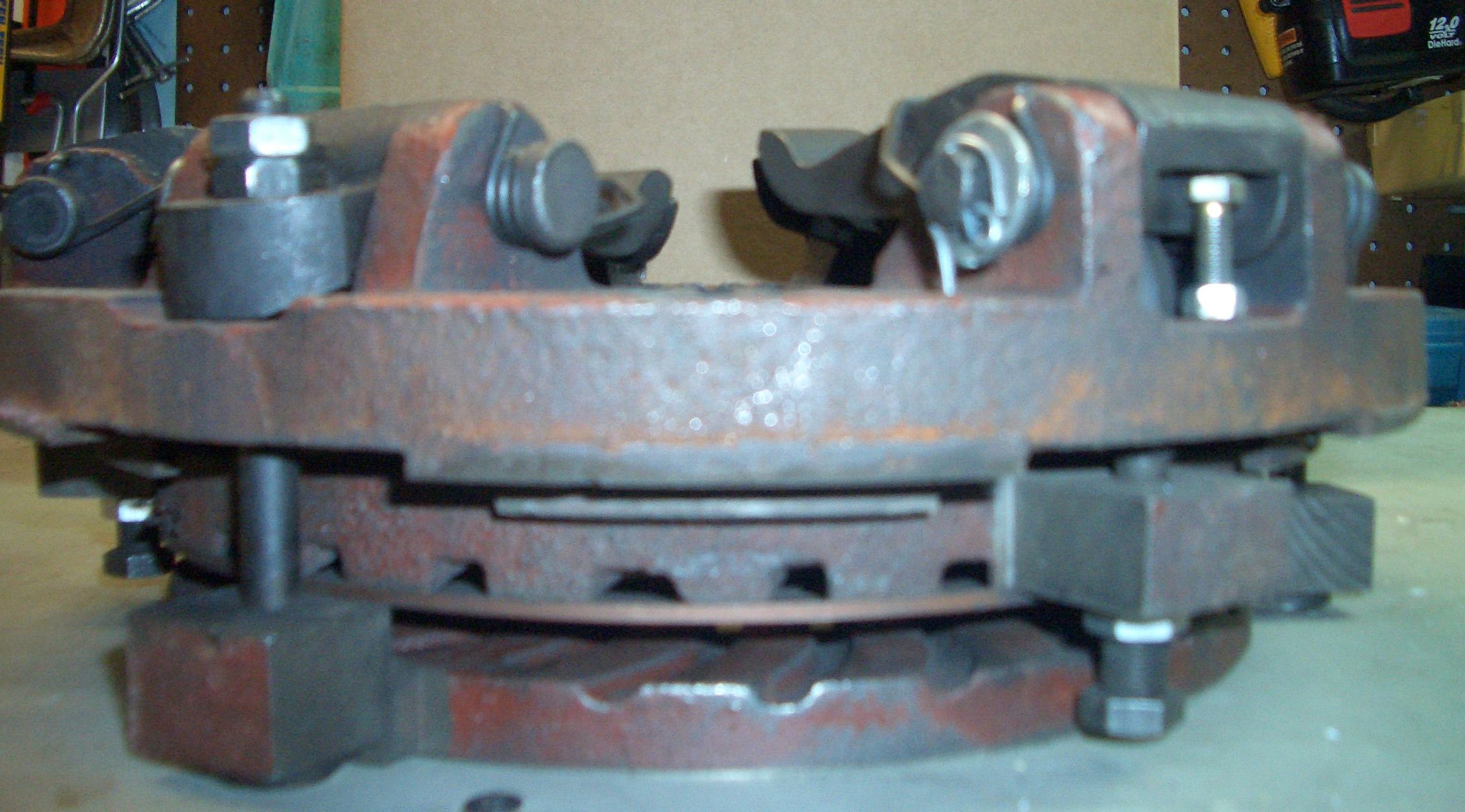

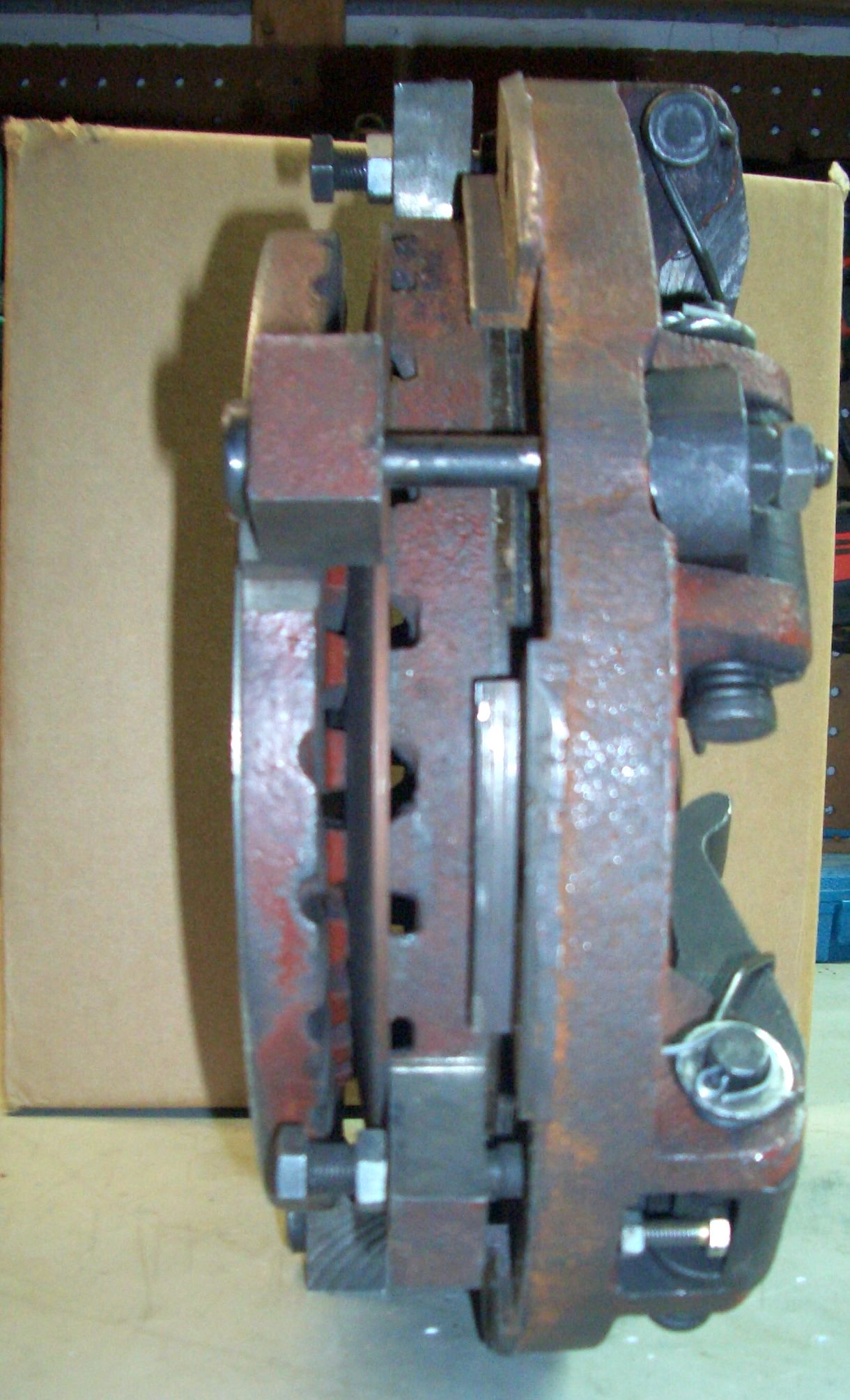

well it looks like your clutch pack is different than mine yours has three adjustments mine has 2 though the fingers.
with a clutch pack set up on the bench and adjusted properly can you take the PTO push rod and measure the distance between the pressure plate and adjustment nut and use that as a GO or NO/GO gage to check for proper measurements of the others and do the same for the main clutch?
My problem is I can't believe that Jinma company would throw a clutch pack in that's not properly set up other than clutch pedal adjustment throw, and not question the engine, transmission, rear end, integrity ,and host of other thing that make up the tractor... I have to trust something were do I start..

please explain what a clutch pack alignment means and how you go about doing it.. and what measurement you use...and where you get the info from..
It involves setting the stack height, then leveling the two sets of fingers so - once the tractor is reassembled - the two sets of fingers will be equidistant both from each other, and from the TOB face. In some cases this is done on the bench, in others you can do it while the clutchpack is still bolted to the flywheel. But I've never seen an inspection window big enough to do one from the outside. Splitting the tractor is pretty much a given.
As far as the specs, it's unsafe to assume that the ones I gave you (for my clutchpacks) apply to yours. There's an overall stack height, there's the distance between the two sets of fingers, then there's the fine tuning to equi-distance each of the six fingers. The numbers I gave you earlier actually came from my operations manual (not the parts manual). But it appears that your clutchpack is newer than the operations manual that came with the tractor. Tommy and Ronald are clearly in the same position as you; new style clutchpack, no specs.
At this point, I see four alternatives
  • do nothing and live with a little noise,
  • wait for Tommy or Ronald to come up with something
  • split the tractor and try my specs
  • split the tractor and use trial and error to develop your own specs
Before considering mine though, understand the numbers I gave you are based upon a stack height of 101.5mm. If yours is significantly different, it's probably best not to rely on my numbers at all.
