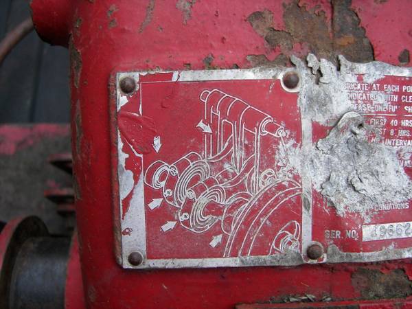

I'm stuck for the moment because the wobble crank is being kind of a bugger. Until it comes out, I can't proceed. Heres a pic of a plate on the mower showing the wobble crank business. It does a bunch of monkey-motion to balance out the shaking of the sickle bar. Massey-Ferguson calls it "Dyna Balance".

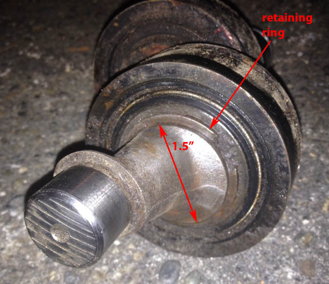

I got the wobble crank out and have a plan to weld a new stub on. Before welding the shaft I need to get these bearings off so first these retaining rings come off.
373388d1399008071-help-welding-stub-shaft-mf_31snapring-jpg
Can somebody tell me whats the NAME of the spreader tool for these tough rings? I don't know the name to search for and all I can find is the little pliers for snap rings (with a hole in each end).

I would think you could get a ring that large off with a screwdriver and a pick and perhaps a hammer.
/ HELP welding a stub shaft #44
From the looks of what I can make out of the pix, I don't think any kind of spreader will help you.
There's nothing left on the ends to get a purchase on.
A couple of taps with a hammer and small punch on the ends to loosen the ring, a bit of heat to anneal the spring then pry it out with a pick and a couple of screw drivers.

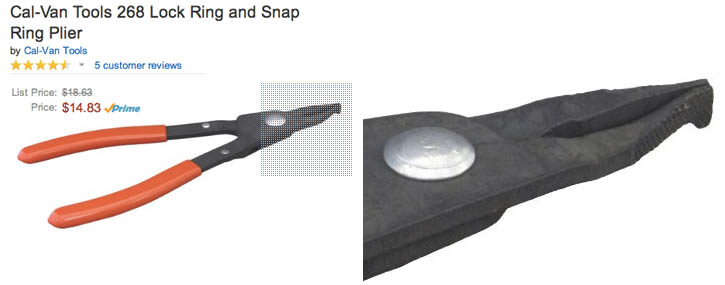

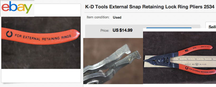

Just did a quick search and found some that look like the ones I use. Go to this page RETAINING RING PLIERS, RETAINING RING TOOL, SNAP RING PLIERS and scroll down until you get to "Lock Ring Pliers / Wire Ring Pliers". Those pliers or a similar pair should do what you need them to do.
I just reread what rsallen said and had a look and I agree that the one side looks like the edge is broken off. You might be able to get the pliers to do the job if you first loosen the ring by tapping it around with a punch. For sure replace it with a new one.

Thanks guys. To get this crank out, I had to remove the 1st of the 3 lock rings (near the broken shaft end). It was a fight - I used 2 screwdrivers (and a little one). I gave up several times. It took a full hour because I only had 2 hands - if I had 3 it would have been off in a couple minutes. I've used a spreader tool before I guess my dad had one.
Thanks PM it looks like the tool name is "Lock ring plier", couldn't think of that name while I was searching. Got it ordered.

RS - the ring is perfect (eqpt has never been apart). To break the end off one of these rings would be impossible, just amazing how tough it is.

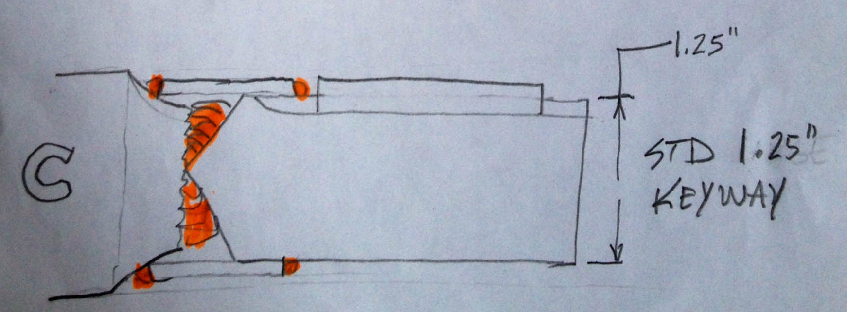

Here's my (current) welding plan. Aligning the shafts (to tackweld it) is going to be a challenge. Thinking of a slip-on pipe with welding holes to tack the cone(s) at the center. The 'tack' has to be bend-able, I might drill& insert a 3/16" rod but (with only hand tools) it will be difficult to get a good center. I have built a cradle to spin the shaft, will post a pic in a day or so. If I can get it true it seems easy from there on out. I don't think "deadnuts true" is worth the trouble, as it simply runs a pulley for a long (102 inch) belt.
Other option is to weld on a larger shaft with no keyway, then have a machine shop true it up and cut the keyway in. Probably a waste of time even to drive to the machine shop (and then waste his time too). But you guys on the internet enjoy it I know cuz you're not standing on the other side of a counter. Same here:D.

Need the bearing in place until the shaft is trued. My plan is remove the bearing after the shaft is welded to appx 1/2" diameter (?) Then weld on out to the 1-1/4" diameter (with the bearing in a safe deposit box). That bearing is a discontinued special bearing ( Sealmaster SK-89 ), it's like GOLD.

Just a suggestion - cut yourself a piece of sheet metal with a hole just a tad larger than the shaft diameter to act as a shield so you don't get welding spatter on the bearing.
Actually, I'd consider taking the bearing off before doing any welding (cover the part of the shaft that the bearing ID is fit to).
Weld up the two pieces, focusing on getting a sound weld and not on keeping the resulting shaft straight.
After welding, use an OA torch to reheat the weld area cherry red and true up the shaft - may take several truing attempts.
The reason I say this is I don't see how you can get enough heat into that cross section to assure a good weld, that close to the bearing, without toasting the bearing. Just as you finish the last weld, it's going to cool & shrink & distort to whatever shape it wants to be, depending on residual stresses, regardless of how straight the first 1/2" of weld was.
I'd just assume it's going to be wonky and plan on a subsequent straightening operation to true it up.
Maybe I'm just being overly pessimistic, but I think you can do this and get a straight enough shaft with a competent weld and a happy bearing if you prepare for everything to go "wrong" and have a way to address each setback it as it occurs.
Maybe you (or someone else) already has a different plan that will work better than what I'm suggesting - let's hear it.

I'll cover the bearing and no-spatter areas with masking tape. I've welded enough on thick stuff to know that the bearing won't feel any heat during the initial welding (first 3/8 or 1/2")
Once I get the center tacked & trued (?) my hope is to weld in an "annular" motion, which I have not yet figured out the method. Regarding a torch, I forgot to bring one dangit. It seems like welding the circular buildup with the weld area preheated thru would be prudent.
The outer welds is where all the strength is, the inner 1/2 inch (the alignment zone with the crappy tacks) is not a factor for strength, it could be hollow, for example and the whole 1.25" shaft is still much stronger than a 1". Hollow might be preferable to a pile of crappy tacks actually, but this is what I have to work with.
OK Jim you've got me worried too. I'm gonna create some kind of contraption with (again) my DeWalt 18v drill, to turn the shaft slowly, so I can weld nonstop, with the idea that the whole joint will be hot as possible during the entire weld.
