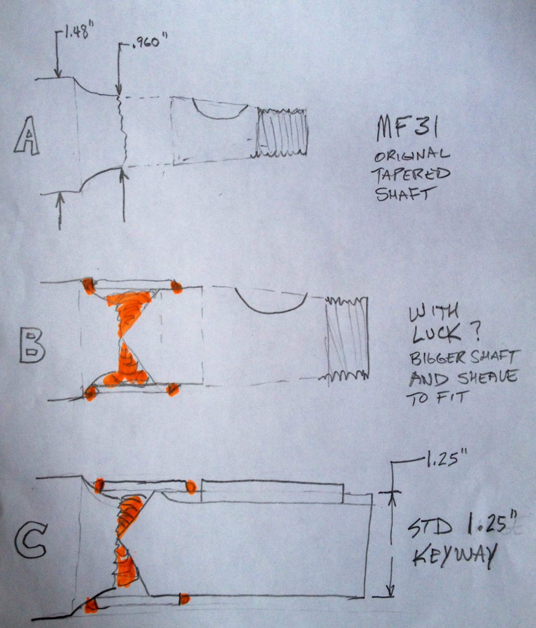

I bought this broken sickle mower thinking I could just weld on a stub shaft. But further discovery shows that this is a very highly stressed connection due to the cyclical loading of the wobble crank. Model is Massey Ferguson MF 31.

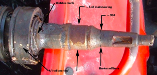

Here is a pic of my broken shaft.

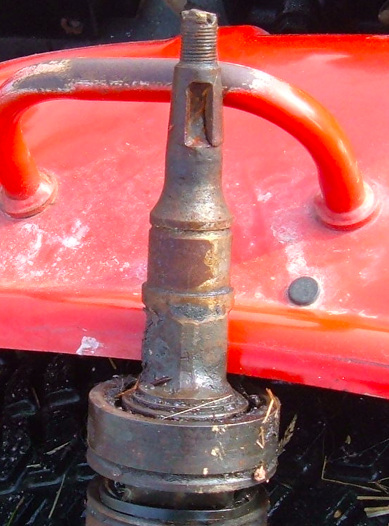

Here is a pic of a (damaged) MF 31 shaft from TBN's Barry1.
Here is a pic of 3 ways I might repair it.
A) Obtain an intact replacement shaft. This would be the best solution but it doesn't seem like there are any available. maybe all broken?
B) Find a larger tapered shaft and weld it on, with a sleeve over the weld. And find a sheave/hub that fits this tapered shaft.
C) Weld on a standard keyed shaft that is significantly larger than the original tapered keyway. And locate an adjustable sheave with a hole 1.25". I think this keyed sheave hub would have to tighten onto the shaft, there cannot be any slop whatsoever. Are there split sheave hubs that might tolerate this kind of cyclic loading?
I don't have a lathe. I have grinders and a welder, and the ability to do this kind of work if I can find the parts I need. I'd really appreciate any other suggestions, or if anybody has expertise in where to find the various parts that I'd need for any solution.

If I weld a stub onto the crank (similar to "C" above) and take THAT to a machine shop and turn it down to be like "A"…..and add the woodruff keyway and the threads. They would have to match the taper in the sheave. Any experienced guesses how much it might cost? If the machine shop bill is under $200 that might work out.
There is a main bearing at the ~1.48"

From what I can see it seems there is an inherent design flaw that renders all shafts to break over time. It would seem the stresses on the shaft when new are probably acceptable, but as the seemingly open bearing gets jammed with dirt the shaft takes the beating and cracks or snaps off, as would be the result in your case. Therefore if you seek a repair that will last a long time, IMHO, you would need to find a way to adapt a beefier shaft to the existing mechanism. If you take the pics and pieces of what you've shown here to a machine shop I believe they might be able to figure out a way to do just that.
Here's an idea. Think about boring the existing broken hub so that a rod with threads could be screwed into place and the mating surfaces could be welded? into place to have a 2 tier level of strengthening. I'm not a welder or machinist by any stretch of the imagination, but by thinking outside the box you could come up with an improved design to handle the flaws inherent in the original. JMHO.
/ HELP welding a stub shaft #8
I do think that a split sheave hub with it's tapered OD would handle the loading but the key and keyway might be the weakest link. Probably would be hard to find an adjustable sheave though to fit the hub.
A "D-method", if the inboard part of the broken shaft isn't hardened would be to drill and tap it as large as possible in the area "under" the main bearing land. Then a replacement tapered end could be made with an integral threaded stud to match the tapped threads along with some Loctite. The direction of the thread (RH or LH) might best be determined by the direction of rotation so that it is self tightening. Could this be done for $200? Probably depends on if you can find a machine shop looking for work and it might be easier to just make a whole new shaft.

Without a doubt the taper is there to prevent slippage that'd hammer any key on a taper-less shaft. (think small engine flywheel) Having a new shaft turned from 4140, 4340 etc would be my choice (PHT'd to say ~30 Rc machines easily (think gun barrel), and would combine o'all strength with toughness (threads, bearing seats, keyway), tho' Barry1's looks to be a forging).
Costly, perhaps but also may be the best result possible and IMO less likely than any welding mentioned to come undone and teach a lesson in two steps (do-overs?). btw: Matching the taper angle to hub would be 'cake' to any competent lathe hand, and all work easily done from a 'properly dimensioned sketch' if sent out.
Thats why I'd want to increase to 1.25" diameter on the stub shaft……? Still a question a split sheave hub can handle the loading of the wobble crank.….
I don't know if it broke by fatigue or by backing into an "immovable object". Yes it looks like a forging, hard to imagine that a weld could survive where the original forging could not. The MF 31 sickle mower is 7 feet long and I'd use it on the BX24 until I get a (slightly) bigger tractor such as a B3030. I would mow weeds in a field maybe twice a year, it's not hard use and not much horsepower.
Here's a roughly dimensioned pic of Barry1's thrashed wobble crank showing where mine is broken

And a repeat picture of my mower "wobble box" looking at the broken shaft stub

SODO, I am having difficulty matching up what you show in the first picture with the rest of the pictures. Because I am not familiar with that machine is makes it harder. In fact what does it really do that is not visible? Is it a PTO or belt operated machine? An infinite variety of split hub adjustable sheaves are available at industrial supply places that handle power transmission products. Split hub sheaves tend to be pretty spending, probably above your target of $200. That hole assembly appears to be pretty lightly built for withstanding a lot of vibration or other stresses especially the larger one on the left. A single belt like that is probably hard on belts especially with what appear to be idler and tension sheaves. Reminds me of a low end riding lawn mower. I was looking to get some machine shop work done a couple years ago and they wanted $150 just as a set up fee. And that was over here in low rent Port Orchard. Found a retired machinist over here that had a shop in his garage and he tinkered on small projects for neighbors and friends. he did the job for a bottle of JD and I furnished the material. He died last summer. Successful welding may depend on the material the shaft is made of; forged steel, cast steel, case hardened, cold rolled stock, alloy. From the apparent vintage it is probably machined from a forged billet. To do any welding you have to disassemble the shaft from the housing and pull the bearing off. The break may be allied to a worn bearing. I would plan to replace the bearing and any seals. Again there are infinite varieties and sizes available. I have always been able to find replacements even for obsolete machinery.

I don't know about threading it. Thats a big hole to drill, probably 3/4" hole? And I think I could center it better welding than choosing a center to drill and tap on two shafts and hope they align.
Chris, If I welded on an oversize shaft (as you described) and brought the wobble crank to a machinist, along with its mating tapered hub; do you think a machinist would do the taper, matched to the hub, woodruff, and threads for $200? I think that sounds like $500, and since I'm 10 years behind the curve actual cost will be $1,000.
Remember the goal is just to cut some weeds. I'd like this implement to be cutting weeds at $300. If the the finished project looks 95% as good Flusher's mower below I will be thrilled!
:cool2::cool2::cool2:
:2cents:
At this point it seems like I should just weld on an oversize the shaft stub (1.25") and use a browning split hub with a 1/4" keyway and hope it survives a small tractor mowing weeds twice a year at half throttle. And if it comes loose maybe just weld the split hub directly to the shaft.

Am I the only one with eyes that work on this forum?!!
Take another look at the pictures of that shaft!
The keyway is not only hopelessly wallowed out, but the pressure side is totally compromised. (Broken away)
And how about the bearing land? Does it look concentric?
How about the beat up threaded end ?
The cotter pin way?
This entire thread just HAS TO BE some sort of sarcastic joke to see how many people will sucker in.
THE SHAFT IS IRREPAIRABLE!!
I think everybody can see that shaft is a total wreck. My shaft is broken off; missing the end. I'm showing Barry's wrecked shaft to help folks envision the part.

Doubtful. IF you actually read the thread you'd know the shaft you refer to is for reference ONLY. It is NOT the broken off shaft base shown early on in this thread. I guess reading and understanding two pages of thread with numerous pics is TOO difficult for some. Geeeeeeeeeeeeeeeeeezzzzzzzzzeeeeeee!:duh:
