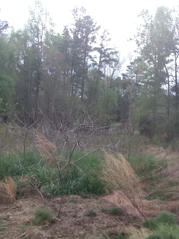

Seems like everyone loves pics! Here are a couple. I will add plenty when I start a new thread ... I don't want to take away from ScHrf thread. I will posted new thread name here when I start it.
Pics 1-4
Im in Raleigh, nc area.... So mostly pine trees. Very dense wooded area .... And has gradual slope down (about 10' every 100 feet).
