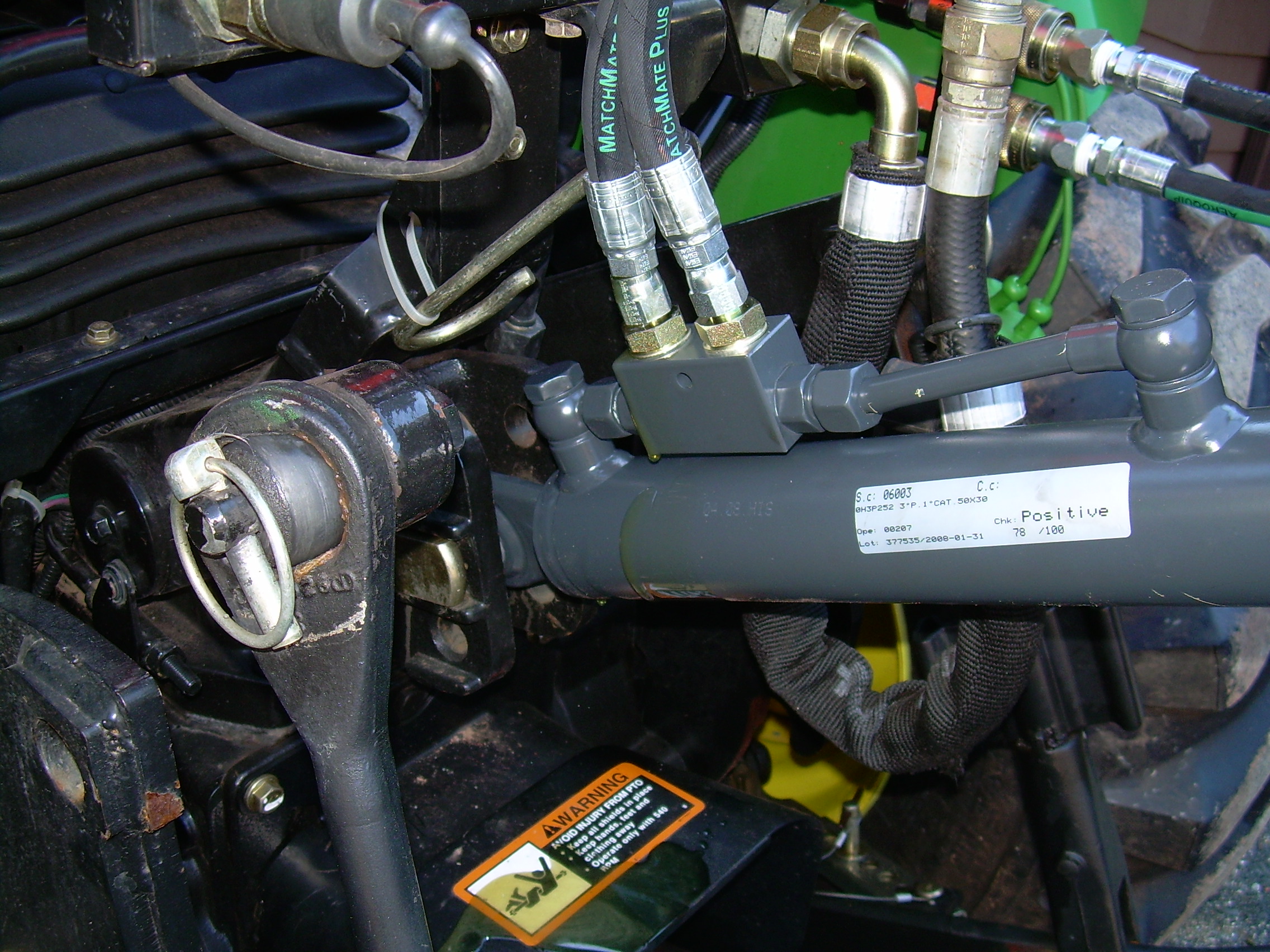

Update:
I got my CCM HTL today (Monday), just ordered it on Thursday afternoon, so that was fast.
I got the 18-26.5 with out hoses, I'll get those made up tomorrow,
anyone have an idea on the length size I should make with remotes on rear fender? probably go with 1/4" hose to slow the flow.
The unit looks well made, all welds look VG, there's a threaded hole that goes all the way thru the check valve block, not sure what it's for? It's called 2 inch but measures 2.37 on the outside.
The 2 nipples are 3/8 and just have a copper washer between them and the block, should any tape or sealer be used at that connection? I know the answer is usually no for hydraulic fittings.
JB.

/ Help specifying Hydraulic Top Link #28
1/4" hose is the best bet....make sure they are long enough not to bind at
full lift and full drop.
Looks like you got a 2" cylinder, which is the ID, with 3/16" walls. I have
never had or seen any hyd cyls with walls thinner than 3/16. 0.20 is very
common, too. Both are plenty thick.
Sealants are only used for fittings that seal at the threads, like NPT fittings.
Copper gaskets like on those banjo fittings I see there...no sealants. I like
to lube copper gaskets to avoid galling them, and anneal them if I am re-using
old ones.

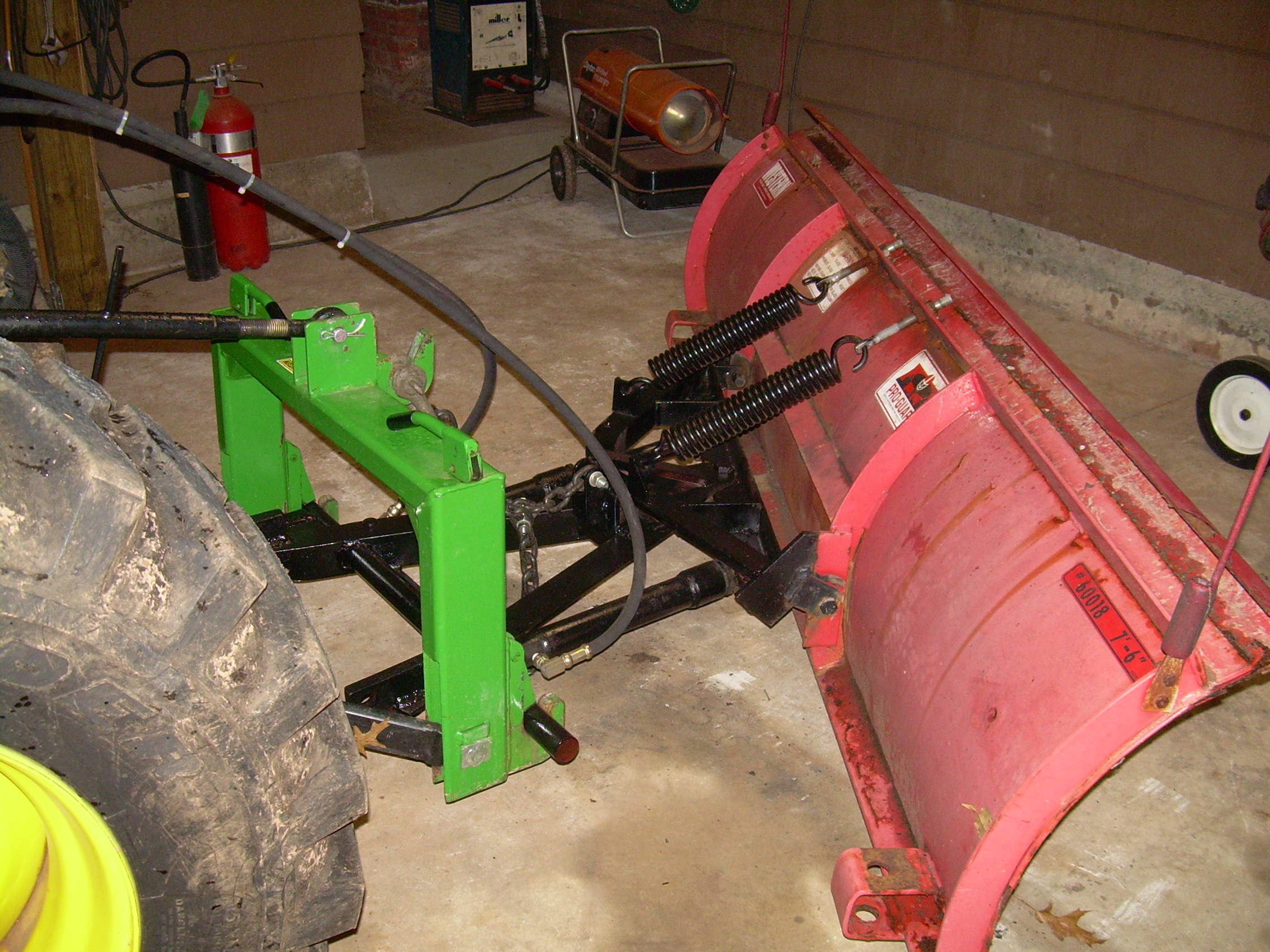

Thanks dfkrug, they only had 3/8 hose but it's not to fast. $90.00 for 2 hoses and fittings!
CAUTION! GENIUS AT WORK!!!
Had the hose made up and installed my HTL today, worked great for the first 8 seconds then I decided to modify it by raising it to a space that happened to be occupied by my PBY bracket.
Bent the hard hydraulic lines on the cylinder, broke the JIC fitting on one of the brand new $45 each hoses.
I can't describe the feeling I had when I first saw my handy work! The sprayed hydraulic oil all over everything was like icing on a cake.
Normally I would go off on some profane diatribe where I link all the worst words and phrases you've ever heard in one long run on sentence with no punctuation.
But I stayed fairly calm and just observed what caused the problem so I could prevent it from happening again, called Mark at CCM and he reassured me it wasn't the first time this has happened to a newbie HTL owner, ordered a couple new tubes with banjo fittings, washers and flares. The hydraulic shop took pity on me and made me a new hose at no charge.
Was able to straighten it all out and put it back together leak free for now, but I'll have the new parts in a few days anyway. I rearranged the check valve block and turned it to the side a little so it clears everything now, the hoses are 3 feet long, maybe could have been longer?
This 18-26.5 is not the perfect match for replacing my original top link, as it provides very little back angle and to much front angle capability with the next size up it would be to much back angle and not enough front. The perfect cylinder for this machine would be 19-29 inches.
CCM has been easy to work with and Mark is very helpful, said he'll see if he can find the special size I would like.
Oh Well, Live and Learn.
JB.

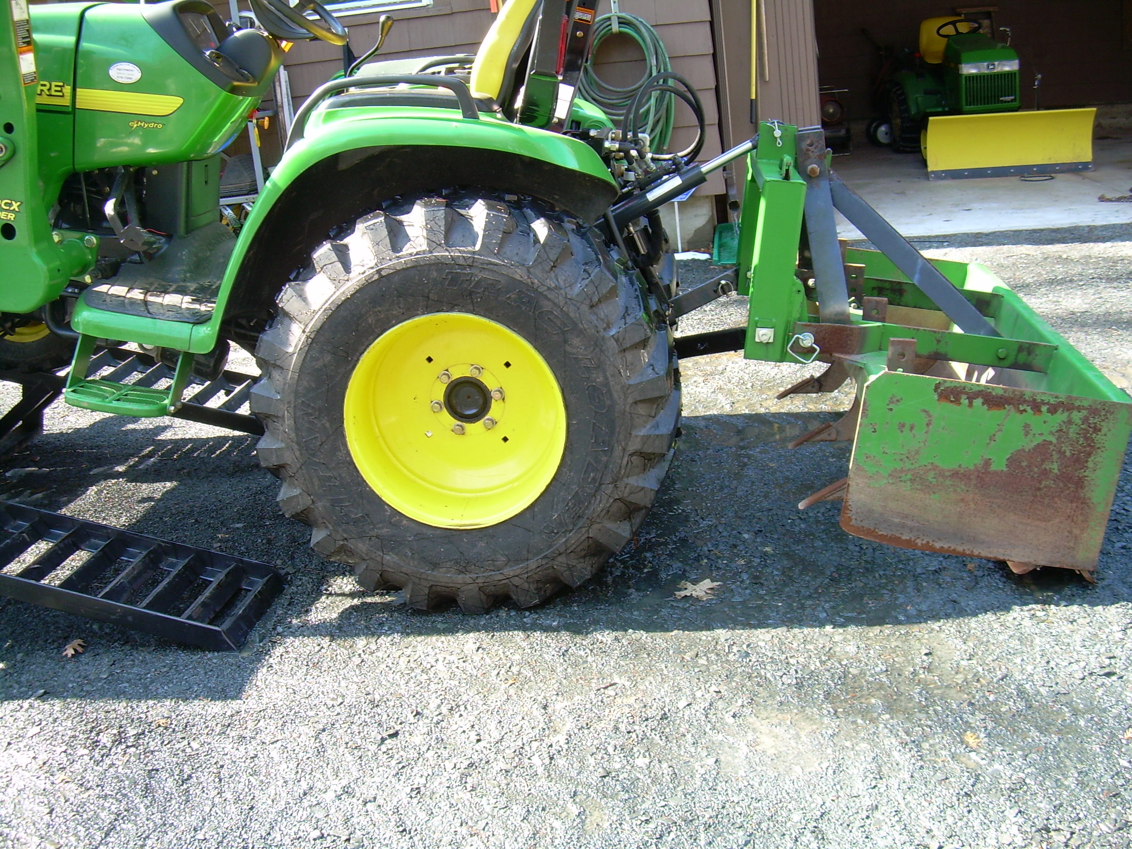

I am also thinking of adding a hydraulic top link. My current one measures 17.5" closed and 27" closed. Based on your experience, would you recommend going with the 16-22.5" or the 18-26.5" toplink from CCM? Also with the hydraulic hoses disconnected, will the cylinder stay fixed. I have a splitter that I would like to run off the same set of remotes, and would like to switch the hydraulic lines one the splitter is attached.
Thanks,
Ken
Get the 18-26 for sure that's as close as you can get to the range you have now, with the smaller one you would barely get it to go back as far as just vertical.
I wish mine went further out but it does go past vertical a couple of inches and from what I've heard most work is done angling implement forward.
It sure make using QH even faster, picking up rear implements, lineing all 3 points up with ease and tipping them forward to be able to reach the release handles even easier without stretching.
Also found an added benefit that's almost a necessary, when climbing the ramps on my new equipment trailer, even with 3 pt all the way up the cutting edge of my box blade dug in, no problem now, just tilt it forward to provide plenty of clearance.
That was just a short BB, imagine a long rake or mower, you'd be all day cranking that top link in to gain the needed clearance.
JB.
