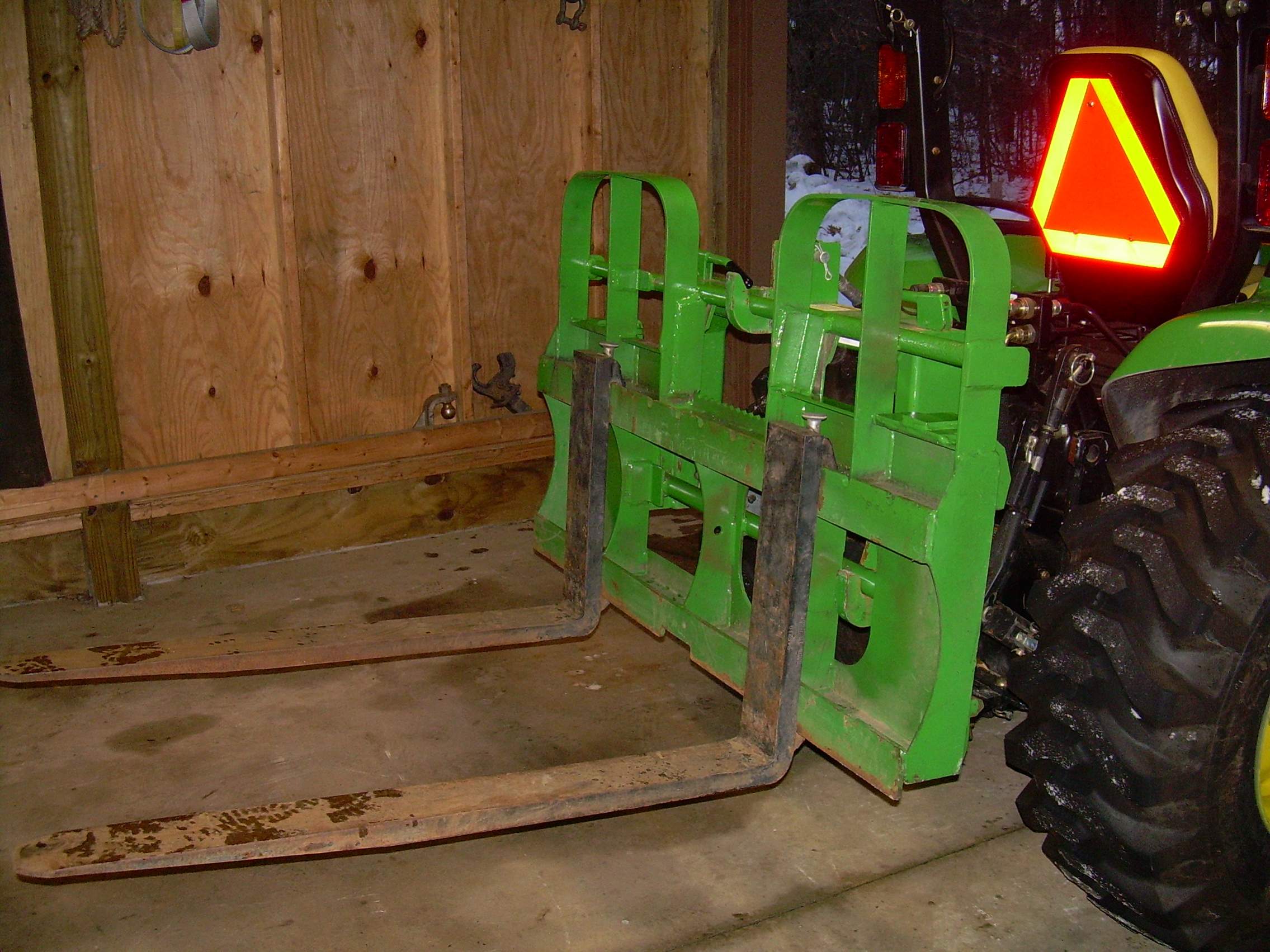

Yea, I've come to the conclusion that I need the same as you have jgrreed (cat1 2" cyl 18-26.5 w/chk valve), as mine measured 19"-29" with my i-match QH, almost ordered one today from CCM, but was toying with the idea of their 21"-32" though that's probably more than I would ever use/need.
Thanks to the replies of everyone here I was able to call local hydraulic specialty shops in the area and intelligently specify exactly what I wanted, but to my surprise none of them had much experience with cylinders for this application and said they would have to special order one.
So how do you like yours, must make hooking up implements even easier combined with the QH. also how fast does it move? I have the 3rd scv remotes and with the western snow plow SA cylinders it's way to fast, I'm sure they were never designed for this amount of PSI/GPM.
With the check valve is there no bleed down even if the lines are not connected? with the plow on the 3pt I'll be using the 3rd scv for angling the plow and the 3pt for raising and lowering, I'm wondering if I'll have to put the manual TL back on, due to significant bleed down.
Pictures, one shows my new plow which I wont need the HTL for and the other shows my 3pt modded forks which would greatly benefit from the HTL. Another pic shows where I got the idea for 3pt forks, I never thought I would get the HTL but since I did the 3rd scv for the plow, I might as well get the HTL, I'm sure it will come in handy for my other back blade, box and rake.
