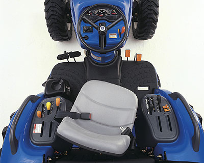

We are buying first tractor ever, have right arm limited use, thumb & forfinger, some power but not much. Use it everyday with my horses, and take my pain pills after!
Do we go gear or hydro, just because of no shifting ease. ?

I have severe RA under constant treatment by a specialist so I can empathise with you. Brand is less important than function in my book. Definately go with HST transmission. And go with a more modern design than either the NH TC30 or the JD 790 because those don't have the ergonomic design that newer machines have. Look for a tractor that 'fits' you, some have fender mounted front loader controls and that may be easier for you to reach/manipulate. Others have loader controls that are mounted on the loader and those may be a harder reach. Also look for other little things like the New Holland "turtle/rabbit" control that is on the loader lever of some of their models, other brands have a similar feature, but it gives you greater control of the machine and is as simple as pushing a button with your thumb.
There are plenty of bargain tractors out there, but in your case I would strongly avoid them. Bargain machines, while they may be strong and reliable, typically do not have the features that YOU will find useful given your reduced right arm function.
Adjustable lower links are a help, but I'd spend the extra $200 and buy an aftermarket set of "Pat's Easy Change" 3pt connectors if you are going to be swapping a lot of implements and one of them is a post hole digger. If you are not using a post hole digger, then get one of the other brands of Easy/Quick Hitch systems (available from most any dealer).
Look for a suspension seat and an adjustable/tilt steering wheel. The suspension seat will take some shock out of your body on bumps (tractors do NOT have shock absorbers). Some tractors have steering wheels that you can tilt and/or adjust in multiple ways. That little thing may be the difference between you being able to control the tractor with one arm or not.
I will say that both New Holland and John Deere have some of the best ergonomic designs of any brand I know. Both brands impress me greatly for some of the design details and features they include that are simply not on other machines. Kubota outsells both JD and New Holland combined, and I own a Kubota, but I have to tell you that in your case I'd seriously look at the New Holland TC29 or TC33 and the JD3120 and JD3320 machines. Kubota would have B7800, B3030 and L2800, L3130 and L3400 machines in the same ranges as you are looking at. The B7800/L2800/L3400 machines are basic and I would rule them out given your circumstances. The B3030 and L3130 are deluxe machines but I beleive both of them are lacking in ergonomic convenience when compared to the New Holland TC29/TC33 or the JD3120/3320 machines.

As Bob Skurka has indicated, the NH Boomer Series of compact tractors is an excellent choice from the ergonomics built into the operator platform. However, the TC30 I believe does not have the deluxe features you will be looking for. If you consider NH you will want to look at the "DA" series of tractors such as TC29DA or TC33DA.
As Bob mentioned, these series of tractors have a built in Hi/Low speed adjustment button on the FEL joystick handle. From your post, not sure if you have or do not have thumb & forefinger function on your right hand. If you don't, this is still not an issue for changing hi/low speed as there is also a toggle button on the righthand controls mounted on fender that serves the same purpose. On the lefthand controls (fender) you will find the levers for putting tractor in gear (hi & low speed) as well as putting the tractor in 2WD or 4WD. A little bit confusing the way I have stated it, but overall you have 4 speeds to choose from. Left lever in low or hi speed & then right button on joystick or fender controls for additional hi/low speed. Definitely go Hydrostat.
The power brake lever is also mounted on the left floor by the seat. You will need to operate this lever quite often however can start tractor with it disengaged as long as brake pedals (left) are depressed.
Quick attach feature for FEL is a must. Do not have to get off the tractor to change lets say from FEL to forks & best of all of course, no tools required.
The supersteer option is also nice especially for FEL work as you will do far less steering / moving tractor back & forth for alignment. The other benefit of supersteer is the auto sensi-track feature. I have never needed to put my tractor in 4 wheel drive as the sensi-track features does it automatically for me. So just leave it in 2 wheel drive all the time. However, SS is expensive & not absolutely required.
Curved front hood on the NH series makes front visibility much better than lets say a Kubota.

If it isn't too personal, how much can you move your right arm? Most 3 point controls are a lever on the right fender requiring several inches of motion to fully raise or lower implements. Loader controls are typically mounted either on the fender or the loader itself, again on the right side. I think a good dealer/hydraulics shop should be able to put together some loader controls that mount on the left side of the loader. I don't know about moving the 3 point controller. It seems there is probably a way to adapt a tractor to your needs. There is no shortage of old time farmers with varying degrees of injury to arms and hands who still run tractors, my FIL being one. He had a staph infection that limits his right arm to about 45 degrees of movement at the shoulder and still runs his Ford 5000 around with the loader and bush hog on it. He's 81.
For everyone else, maybe it would be helpful if we could post pictures of each platform area similar to the one showing the swivel seat. Then the location of controls with respect to the seat would be apparent and newhorse would have at least a basic idea of what might work, thus saving a little time. Not that there's anything wrong with visiting tractor stores and sitting on machines. /forums/images/graemlins/smile.gif It just might let him decide which ones to visit first.

Can move right arm, have nerve damage in tendons from wrist, the forarm itself is aggrivated by nerve damage, scare tissue, so I control with pain meds. Right thumb and forefinger are only two with some power. Can't lift with right arm , have become left handed over the last 13 years...
Looked at the NH33DA -very nice, allot of extras. We are leaning towards the JD 3203 --as the price with FEL, 60" HD Bucket is $16183 vs $18800 quoted on the NH TC33DA with 14LA loader. Though the NH has better finance rates now... I think the 32 HP/24 PTO HP will do just fine for the property we have to work with. The 2nd JD dealer we went to was great to work with, and thier service dept has long time employees of 10 to 25 years. The NH dealer, not too comfortable with, and is farther away 35 miles, they would charge to haul tractor if a problem during warranty?
I am going to go with the Pat's Easy Change instead of the JD I-match, so I can use with other mfg attachments, and a post hole digger.
Even though there is not allot of reviews on the New JD 3203 , we are going to chance it based on the comfort, location of the loader joystick , leg room , AQHA discount and the 2nd dealer....Will send pictures when we get it!
