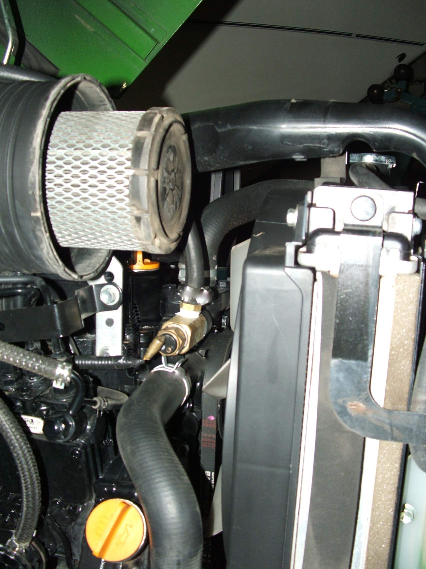

OK, I would love input on this brain-dead move of mine
I went outside to start the tractor again to see if I could get it running smoothly. Suddenly it dawned upon me I AM RUNNING WITHOUT MY AIR FILTER. This raises at least a couple of new questions:
1) can the bad air filter be ruled out as it was running without a filter
2) does this lend credence to the t-stat theory
3) did I do any damage. Total running time was less than 2 minutes, the cap to the filter assembly was on and locked in place, the conditions in the garage were cold and free of any obvious dust
Thanks with my tail between my legs,

So you broke the rule of mechanics. You put something back together to the point it looks like everything is right. TskTsk:duh: I doubt you hurt anything so don't worry. A very dirt air filter or one that has gotten wet at some point can cause a diesel to run very poorly.

I agree with kuboman that running your tractor for 2 minutes without the air cleaner won't harm it especially if the "inner" air filter element was still in place.

SI2305, what year is your 2305? The air filter you are showing in the pics looks to be the secondary filter. Hard to tell from the pics. Where is the primary filter or maybe the older model don't have it? Mine is a 2008 and here a pics of the primary filter. The secondary filter is inside that one. I don't have a pics of the second one but if you need to see it I can take a run to my garage and get one for you. I also could be wrong and the pics of your filter could be the primary one. Either way, I think there should be 2 filters. The 2 minutes it ran without the filter did not damage anything as it was only park outside not working in the dust or anything. If this is your secondary air filter it definitely need to be change, but check see if their should be a primary one also. It could be a few things that is causing your problem, but you have to replace your fuel filter first. There is a red plastic ring in the bottom of the fuel filter bowl. This ring will float if you have water in the bowl. Those to me is your first step to take. After that, it could be your injectors or fuel pump. I hate to bring this up, but I had to replace my engine at 300hrs with symptoms that sound somewhat like yours. If you look into my older tread under ''2305 engine needs to be rebuilt'' you can maybe compare a few thinks but lets not get ahead of our self. Do it step by steps. Start with your filters.

I would do what Henri said and replace the primary air filter along with the fuel filter and clean the bowl. It sounds like you park the machine outside so I would run some Power Service through it as well. My friend had the same issue with an old 755. the new fuel filter and Power Service cleared it up in a few minutes.

I don't have a pic of it, but the inner filter looks absolutely pristine. This was definitely the outer filter and evidently all the mowing I have done with it has really gotten it dirty as of late. Labrat--I used to park the machine outside. It has slept indoors now for 2 years. I could be wrong, but I don't think its parking location is the cause for these symptoms. Thanks to all for the reassurance that the 2 min running time without the outside filter did not cause catastrophic damage.

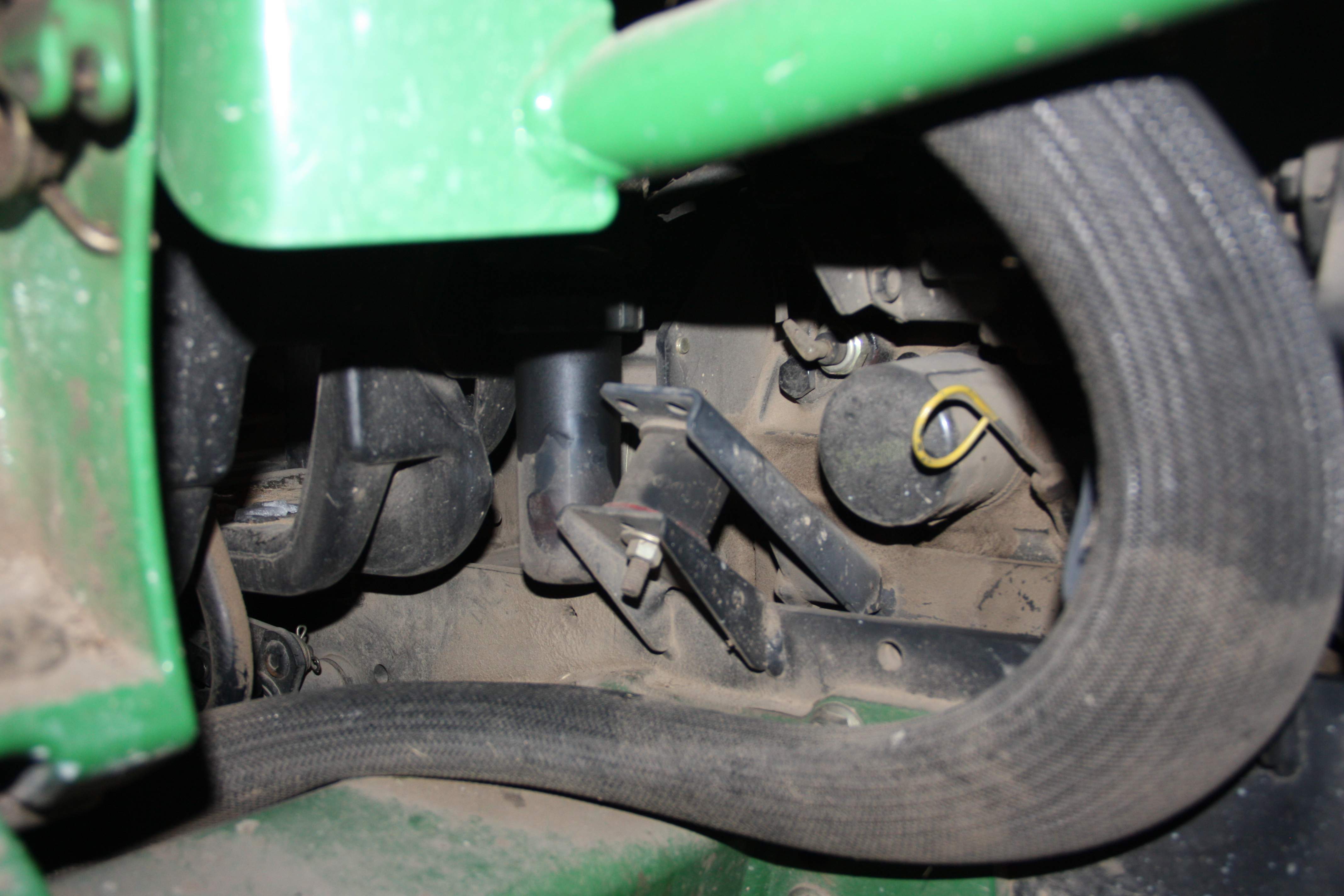

Here is a pic of the side of the tractor with my embarrassingly dirty fuel filter. I was thinking that a generally cleaner interior would help highlight the condition of the fuel filter. Or I just need to get my hands dirty and get the job done. I have kept up on the other aspects (basically fluids, tire pressure and greasing) but this one slipped through. no one to blame but myself.
SI2305

Changeout the F filter - you now clearly appreciate its' value :thumbsup:.
You may find some of the "darkness" is just buildup on the inside of the fuel sight bowl - you'll know soon enough.
For general exterior engine cleaning, I often just grab my bottle of Simple Green - soak, scrub, rinse usually does it. I keep SG around for other reasons, and have used it for a long time - one thing I like is its' low toxicity.
Your engine may look dirty compared to parade queens, but is still way better than a lot of working equipment I've seen. Clean looks good, and can help you identify issues as they are emerging.

Thanks for the input on Simple Green. Just spray on and hose off. Generally I am doing this for the pragmatic issue of seeing problems before they manifest into much bigger ones like I have now and yes, I too have seen some pretty filthy machines working hard.
