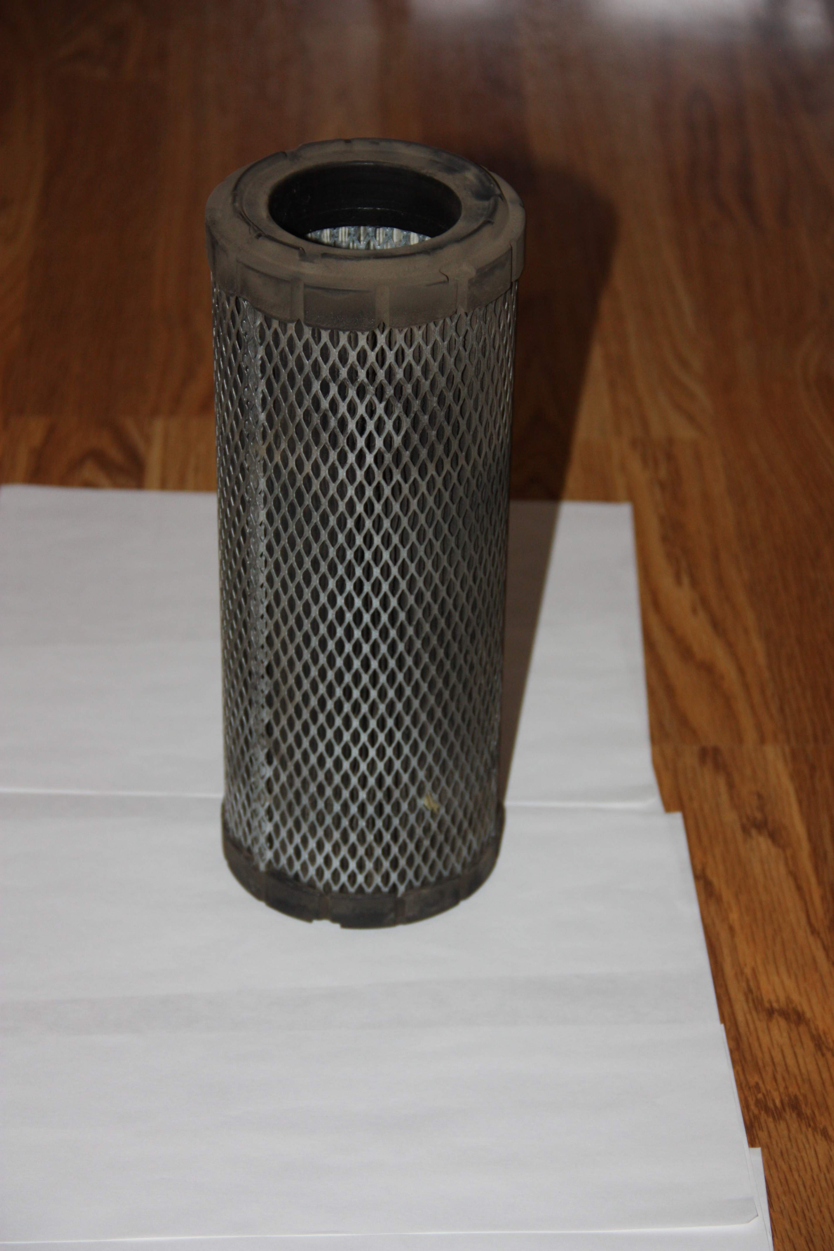

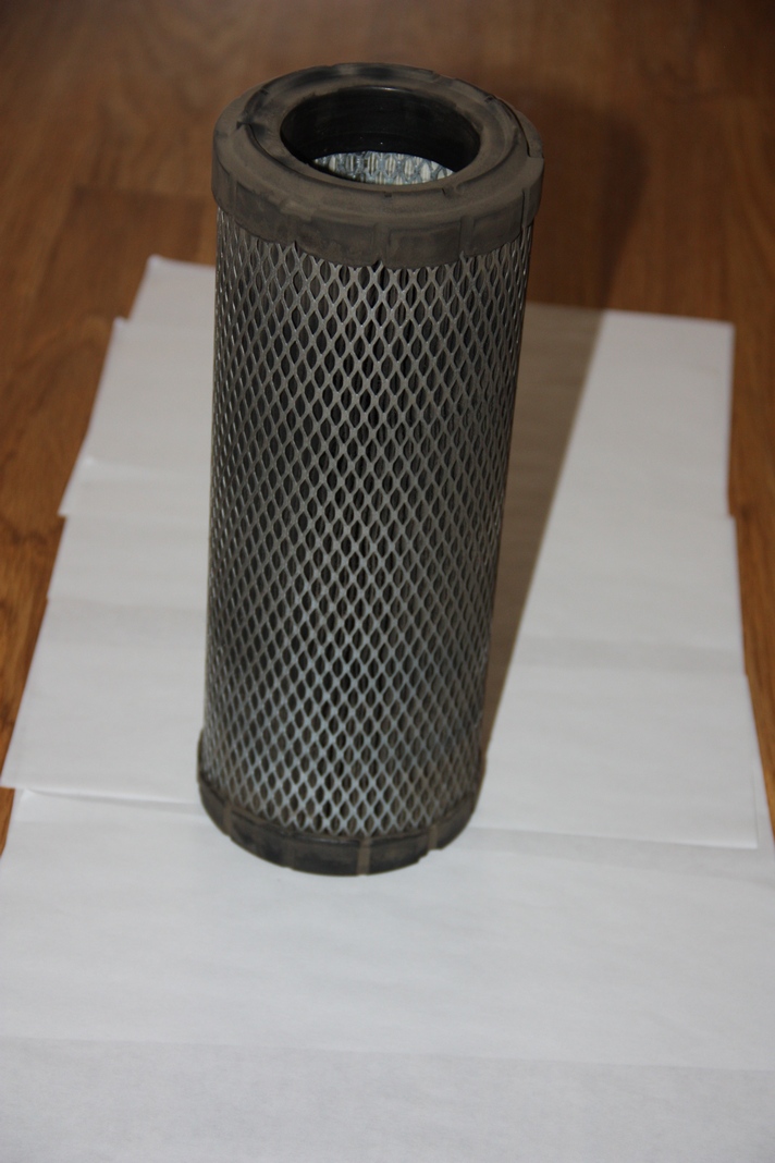

The Deere manuel says to not replace a filter unless "Very Dirty." I removed the filter for the first time in some time (last time it was only slightly dirty). Is this what you would call replacement level of dirtyness? I have attached two full resolution photos for examination

Sorry, my internet connection is tenuous at best right now. I only have 1 pict to upload but it should good enough.

here is a bigger image

Look at the inside of the filter. Now look at the outer weave of the paper. Does it look dirty to you? How many hours on the filter? Sometimes if you work in dusty dirty conditions the filter will jam up with very small particulate matter, which is what it's supposed to do. I'd try changing it and see if you notice any difference in running. you can always put that one aside for dirty working conditions, but clean air and fuel is what any engine needs to function correctly. Don't worry about what the book says, you're trying to get it running properly- go by hours and type of use, a filter is cheap engine protection.

Thanks, I never knew exactly how dirty "extremely dirty" was. It would have been nice if the manuel (have one) had a picture for reference.

I have semi-regularly checked the air filter and it never seemed to get terribly dirty BUT
Last summer (2012) our lawn mower broke and we replaced it with a RFM so the tractor has seen much more frequent use and often in very dusty conditions--definitely explains the air filter.
*by the way, the inside of the filter looks very quite and the internal filter-the one protected by the filter that is now oh-so dirty--looks absolutely pristine. Good news there.
