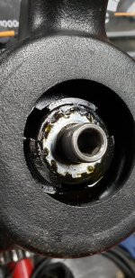

Ok, this is something that ought to be really simple and straightforward.
The shop manual says that all I need to do is remove the center cap with a screwdriver, remove the nut securing the wheel to the splined shaft, pull up on the wheel to remove it.
Yeah. That's not working. No matter how hard I pull.
I've put a piece of wood across the underside of the steering wheel grip to gently hammer it up-no worky.
I bored a hole in that piece of wood and used a threaded dowel, nut, and washer to apply force from the center splined shaft upward against the underside of the wheel grip as I thread the nut upwards. Still doesn't release. Even while tapping as I do it.
During all of this, I'm applying penetrating spray to it.
I started to use two screwdrivers to press up against the flat side of the orbital valve under the wheel to pop the wheel off. Still nothing.
I don't want to use a 3 claw clamp because it could ruin the wheel. I'm trying my absolute best to do this with care.
Anyone else have any ideas?

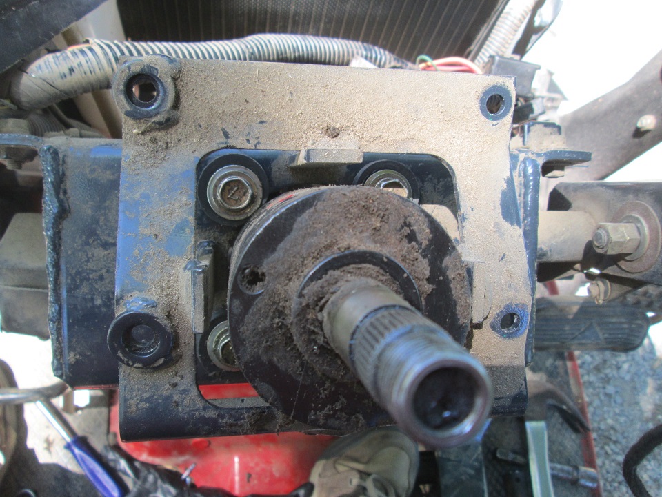

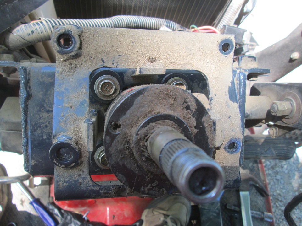

There has to some type of loctite on the shaft. I couldn't budge mine while pulling up and tapping. Eventually removed the steering valve bolts, and tapped it down ( the valve won't fall due to the hoses). Came of quite easily, and could remove /replace it easily afterwards with no binding. I was changing the rubber mounts, so had to remove the bolts anyway
View attachment 626182.
It wouldn't make a bit of sense to use Locktite on a spline shaft with a nut on it.
If there is a thread locker, some heat on the shaft would break the bond.
They probably wound up with a tighter fit than they expected, and they are forcing them on, which stretches the wheel.
