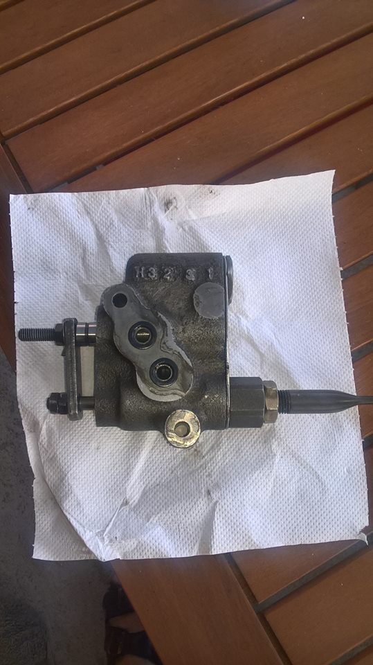

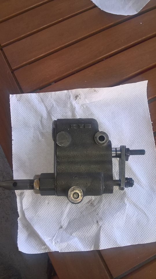

Do you mean the large flat head screw on the Control valve inside the Hydraulic Block?
:( i didnt remove that one as well when i had it off and checked it , Bugger. :)

Im close now to giving up :( Oil is flowing to the Hydraulic Block But nothing moves , just had the piston to lift arms out and no oil is coming in to the cylinder no matter what i do.
Oil is flowing to and from FEL but nothing moves.
There must be a fault in the Control valve in the Hydraulic Block that releases the oil before any pressure can be built any where. thats the only thing i can think of.
Ah well time to find an expert and have the tractor sent there so some one else can get grey hairs :)
Ah well timer to find an expert and have the tractor sent there so some one else can get grey hairs :)
A stuck relief valve or a broken relief valve spring in your valve block will cause these issues .
Oil will just go back to tank and not do any work if this is the problem .
Is the relief valve an external adjustable type, which can be unscrewed from the block ?
Can you upload a picture ?

The FEL is connected on the side of the Hydraulic block (Where the external relief valve used to be)
And the return from FEL goes in to the Filler hole on Gearbox (that one gives oil all the time the tractor is running now, NOT sure but i think it didnt give oil in return unless i moved the leavers before)
