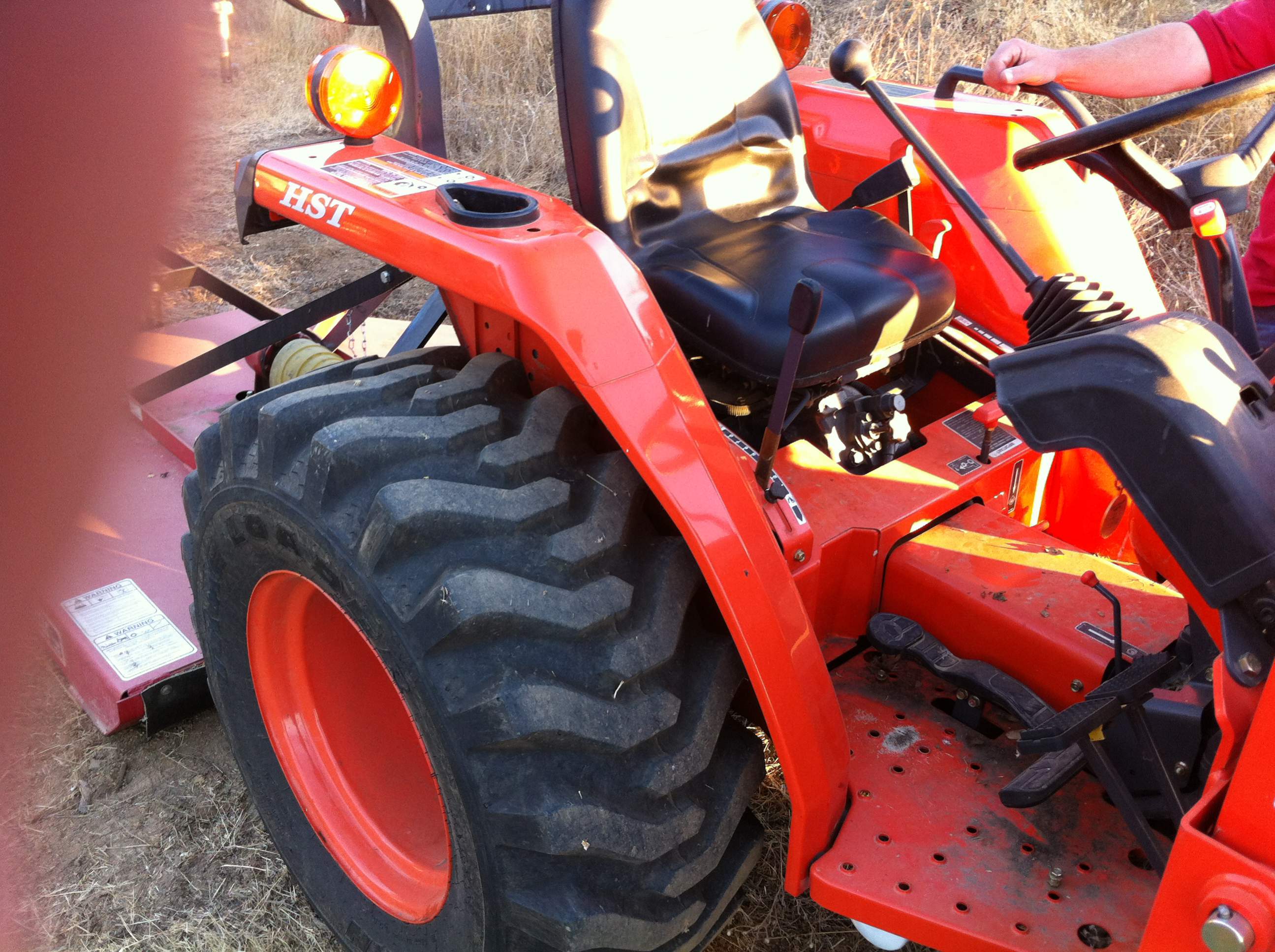

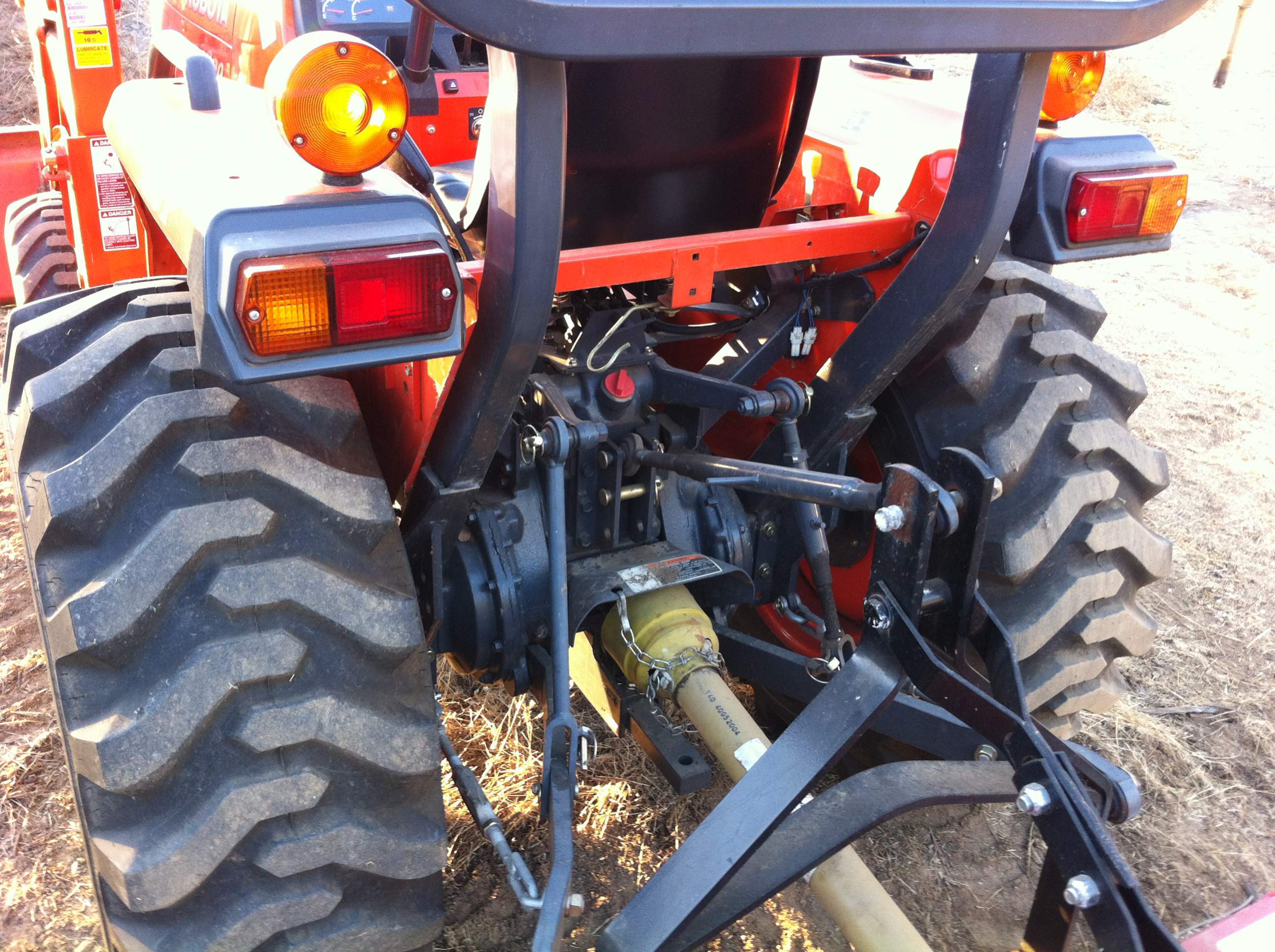

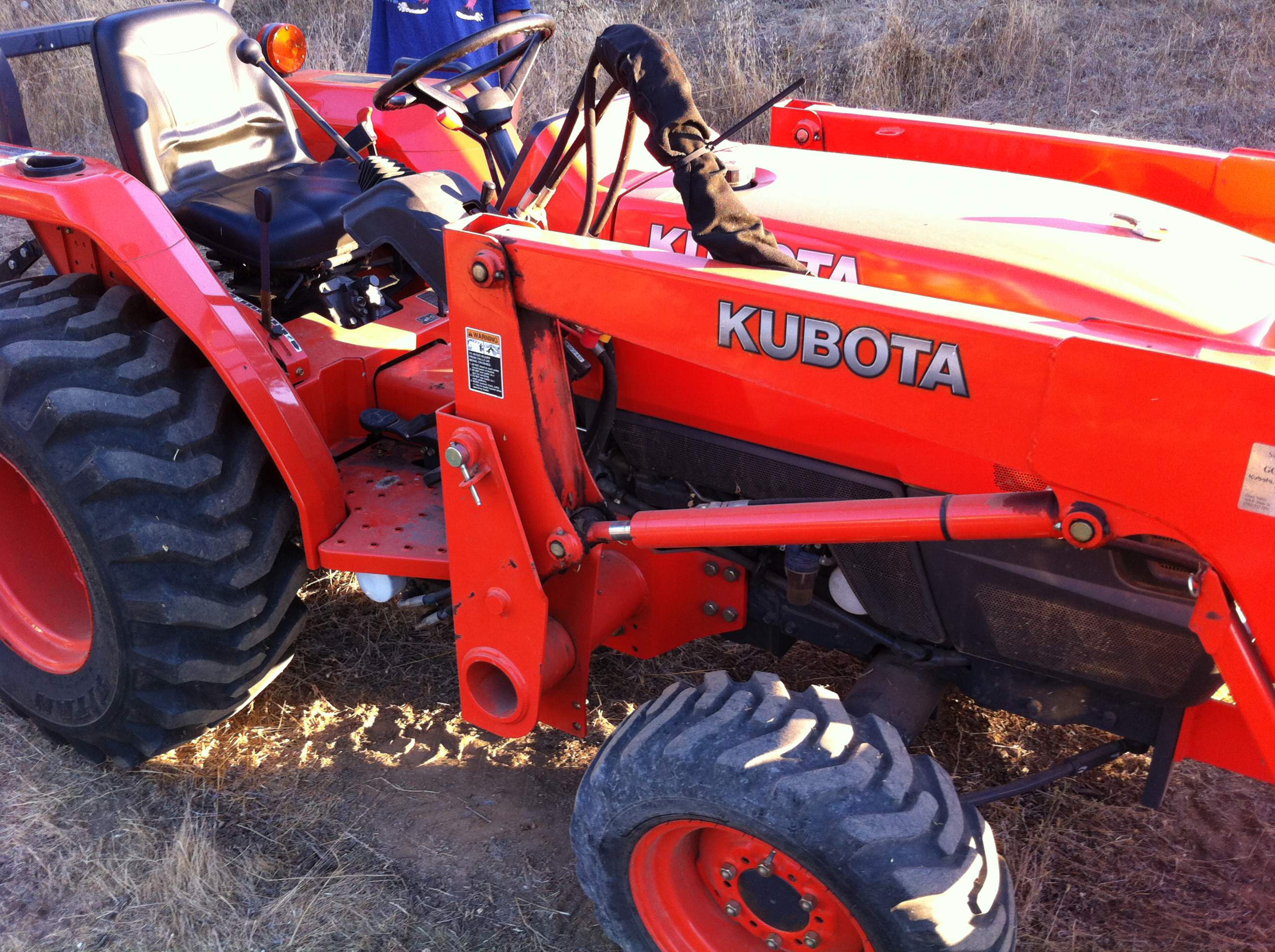

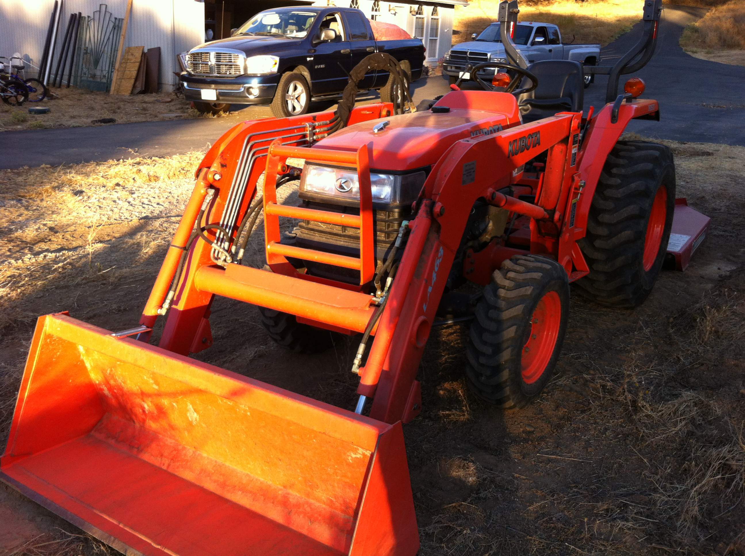

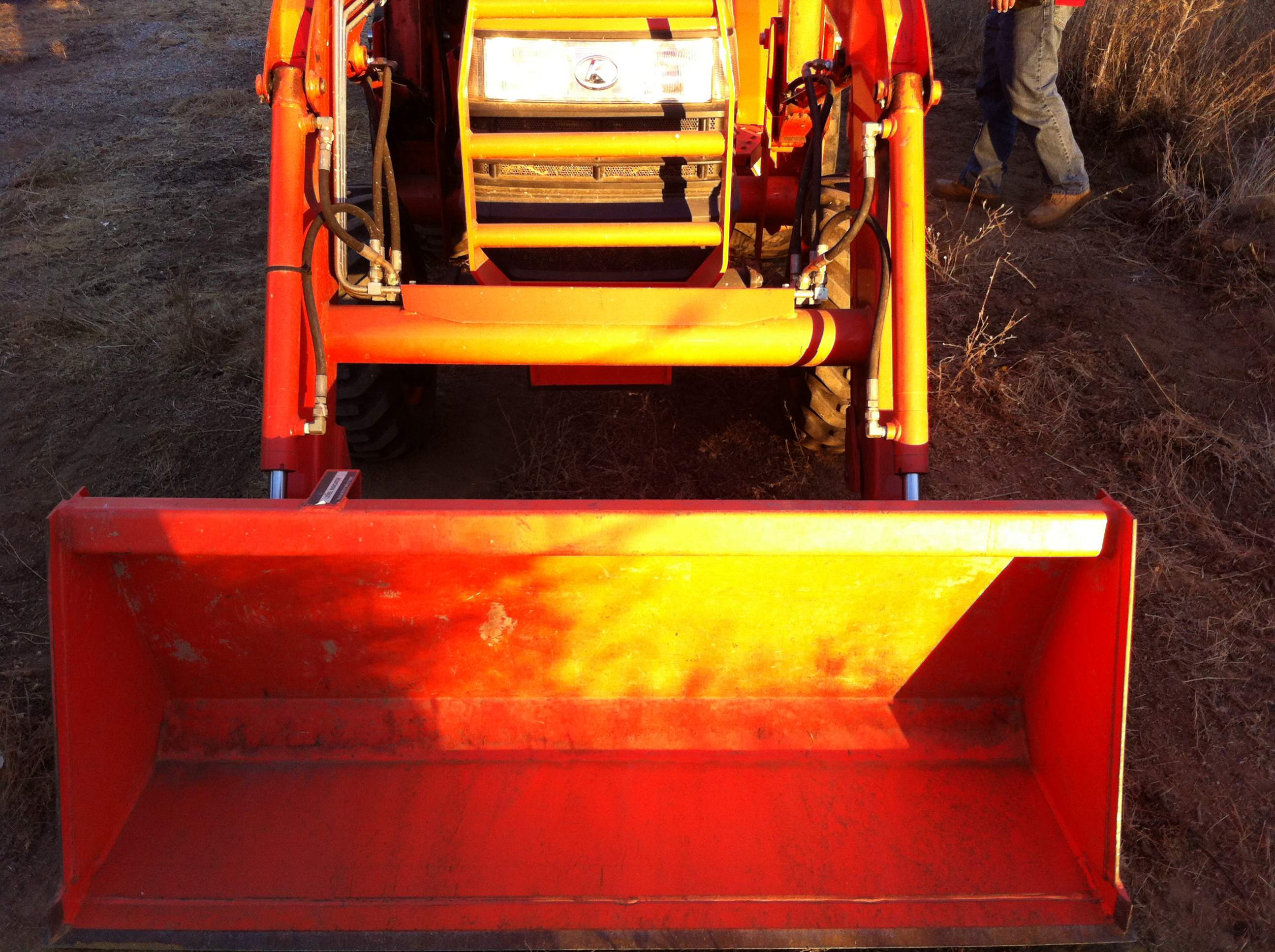

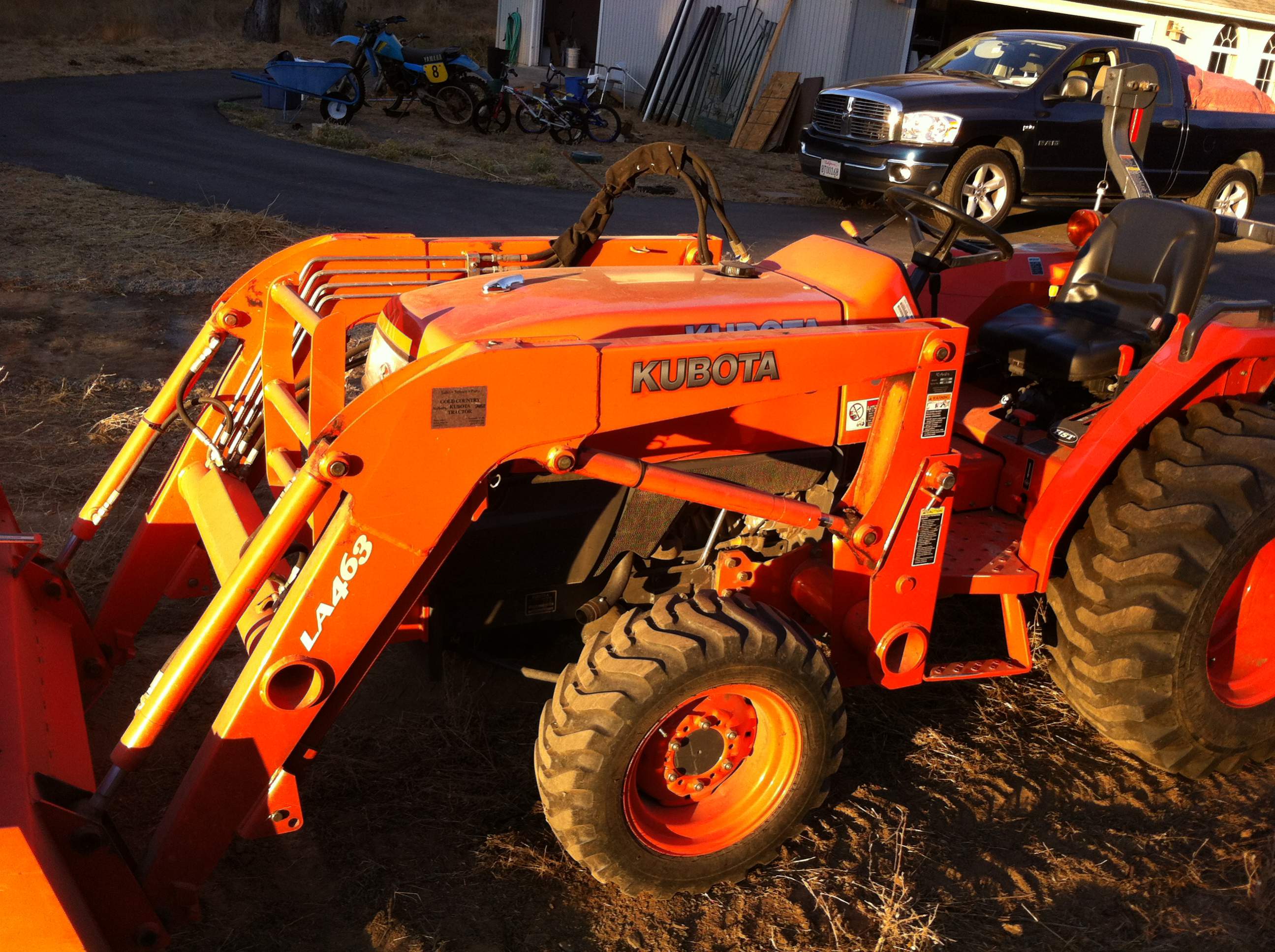

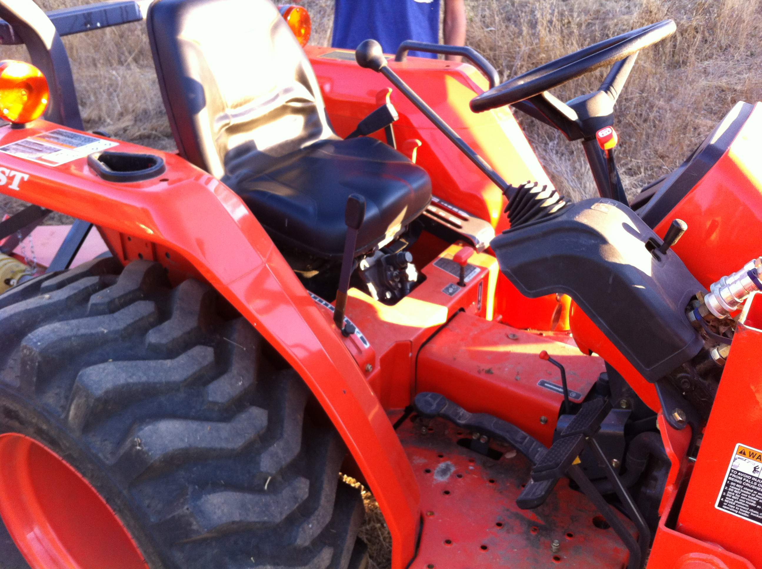

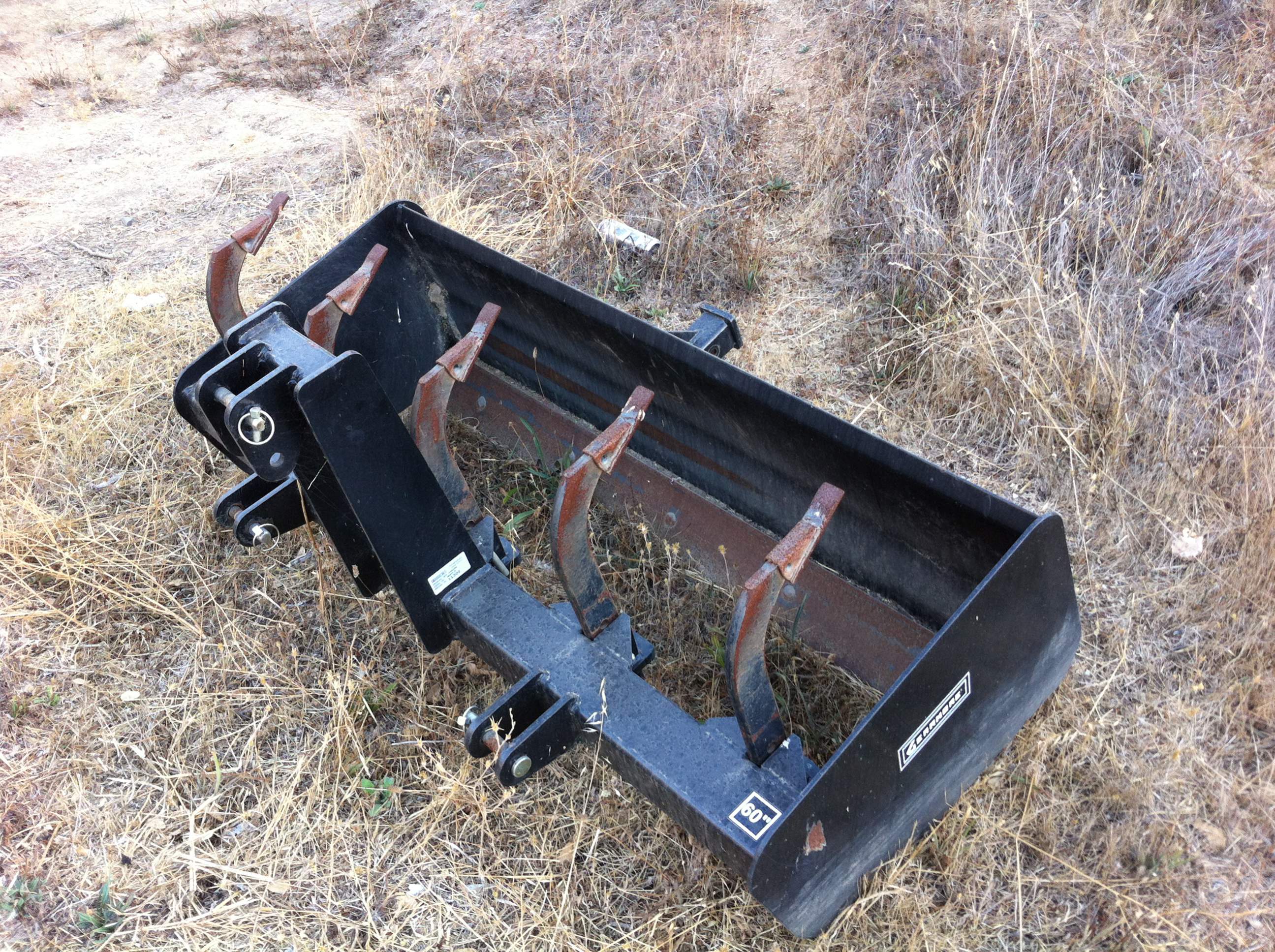

Ok I think I am going to make a final inspection of the L2800 - uho pic heavy see attached - probably not the best photos!
Other than general observing - is there anything specific I should ckeck on this.
I have driven it fwd / backward in each range, turned, raised/lowered Fell, engage the PTO on the Bush Hog (gently let out cluch), tried the 3PH with bush hog on it. He was religeous about greasing all points every 10 hours (108 hrs now).
Any items that i should specifically inspect for would be appreciated.
Also is there any way to route that bundle of FEL hydraulic lines that stick up like a sore thumb - downward instead of up - i've always thought that was "un-cool".
Thanks,
Paul

I think either one would make a good tractor for you. The L2800 is just barely "broken in" My 2010 L3400HST had a few more hours on it when I traded it, and it was like new.. You might put some pickup bed liner on the floorboards of the L2800 if you get it. It will dress it up a bunch and really gives good traction. I did it to mine and was very pleased with the results. Yeah the L2800 probably has the "jerky" hitch, and maybe the L3200 might be better in that regard, maybe.. some report their L3200's are not jerky some are. As for the loader lines, all examples of that model are all like that, and I don't see a way to really help that a lot.. You ignore it after a while. Here is a link to the floorboard thread. Pictures on post 21
http://www.tractorbynet.com/forums/customization/177061-using-truck-bed-coating-floorboards-3.html
James K0UA
/ Help on L2800 or L3200 #9
Either one works, but as always more power is better if you can afford it and the HST is wonderful, loaders are almost as handy as the tractor. The L series are great tractors.
/ Help on L2800 or L3200 #10
That L2800 looks very good! Should be nothing to worry about...
The hydro lines on my L3800 are more forward and not sticking up that high. You might can reroute them a bit. I leave my FEL off most of the time and the lines stay with the loader.
