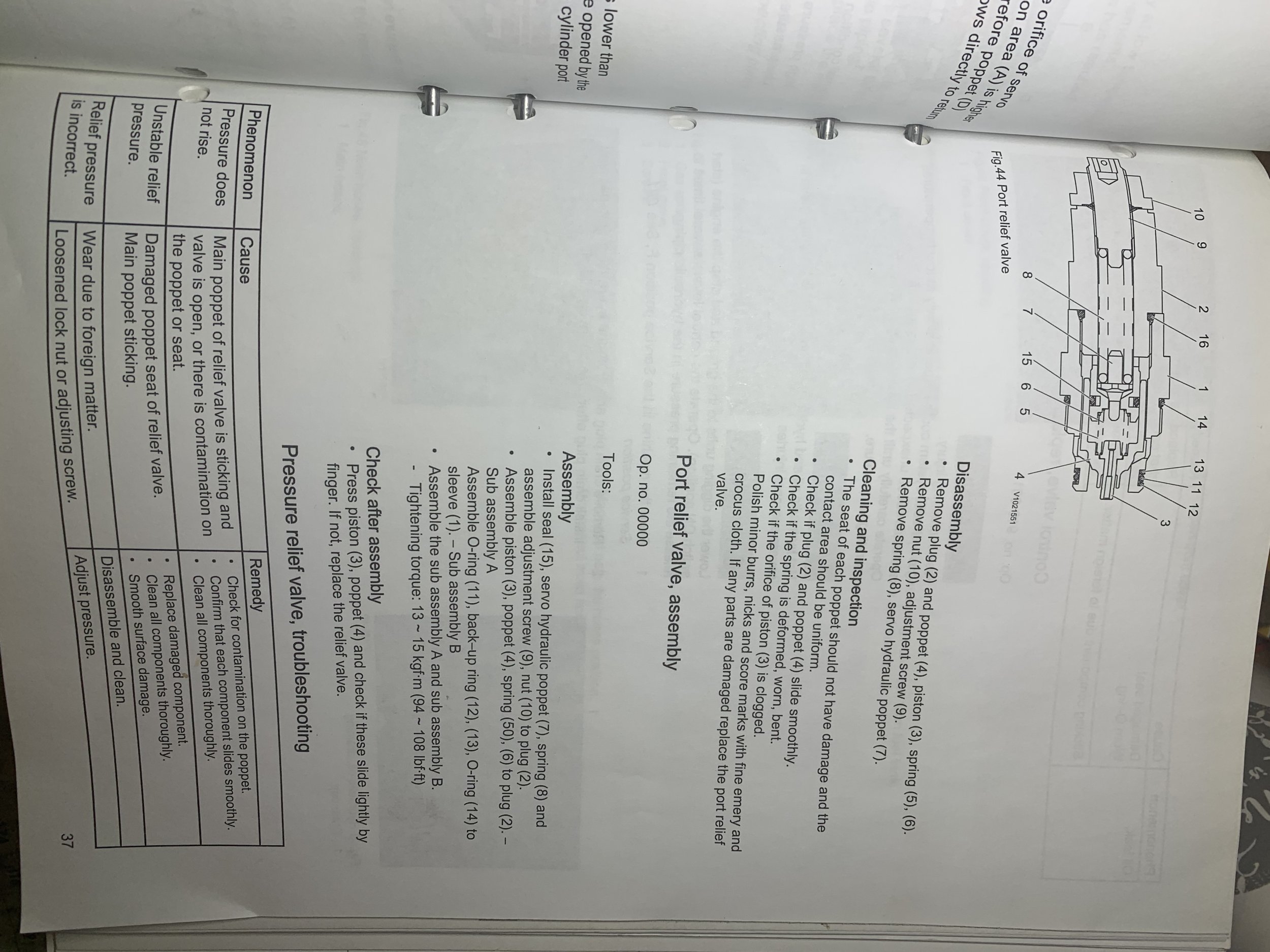

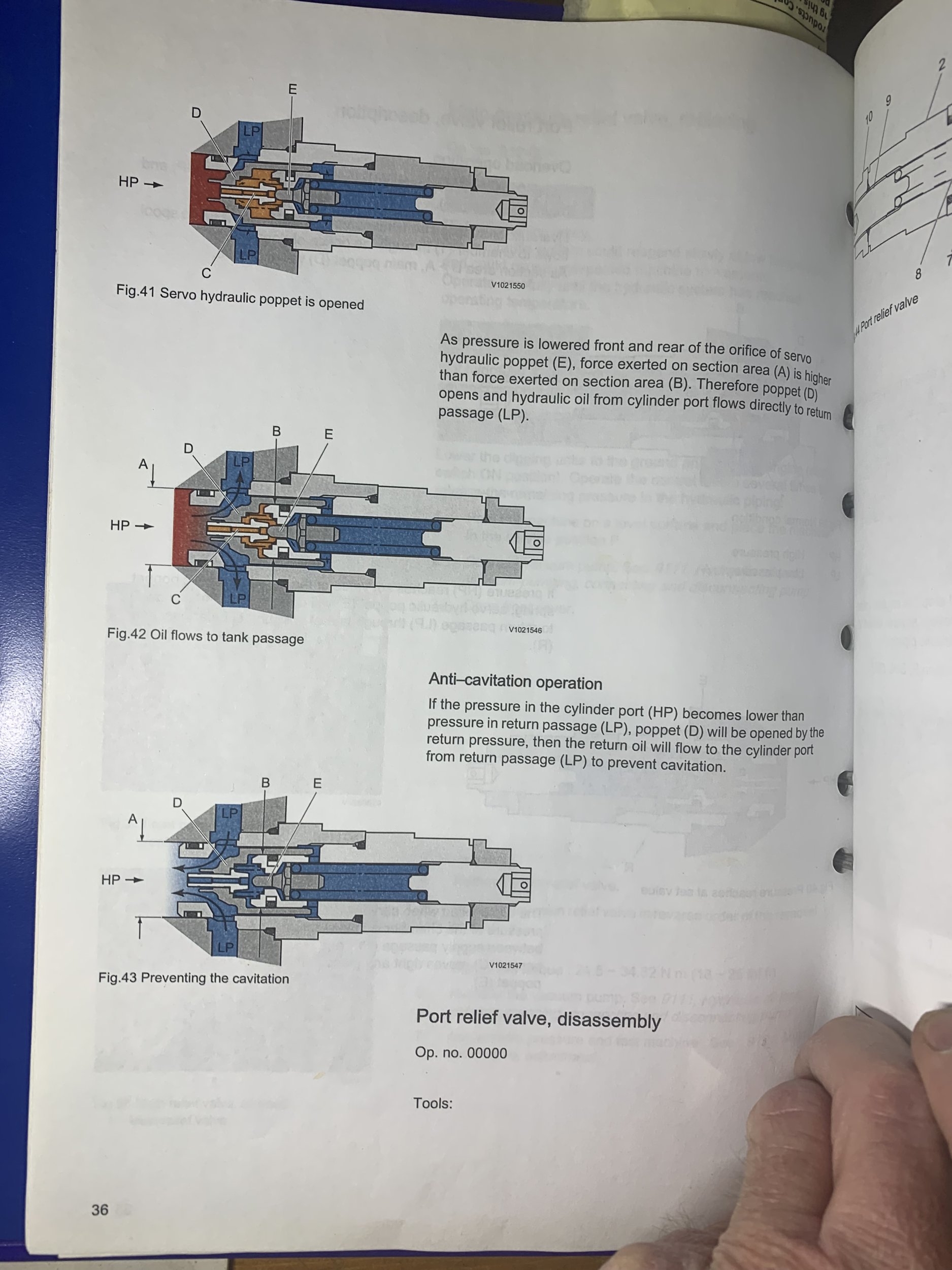

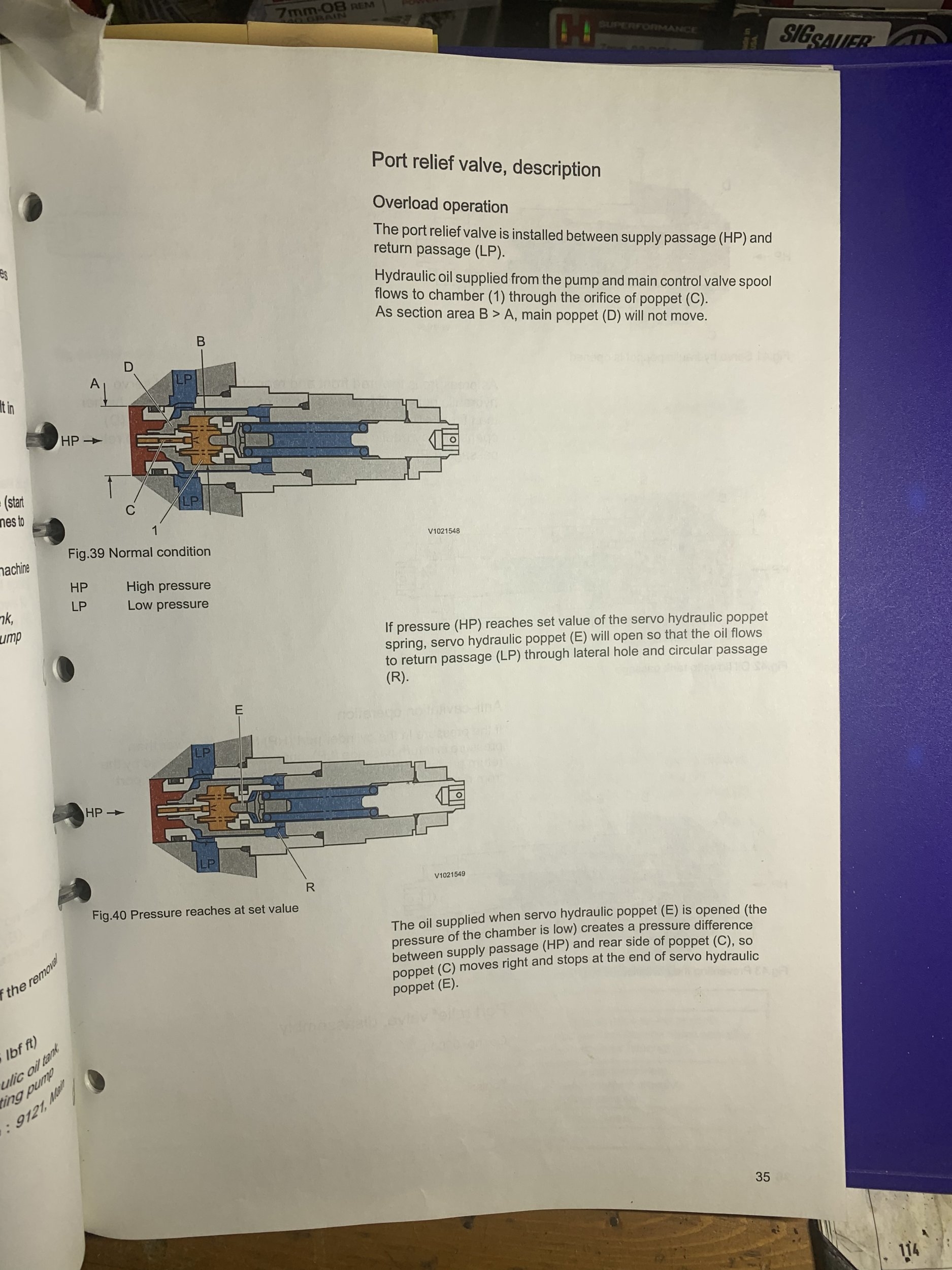

I think these intermittent issues either no swing or no down pressure are very likely the port relief/overload relief valve stuck open. These reliefs are not simple direct acting reliefs. They are pilot operated which are a more precision design with more small moving parts , orings, springs and small orifices prone to issues.
Nice thing is there just a cartridge type that just thread into the directional control valve, easy to remove for inspection and repair. If it was me I’d pull the one out that’s on the pressure port for left swing , disassemble and inspect for any contamination, plugged orifice , broken or bent springs, worn orings and a good cleaning. Don’t forget to mark the position of the set screw before disassembly.

Here’s some good info from the pages of my Volvo excavator service manual, they look to be almost identical to R Scotty’s illustration
