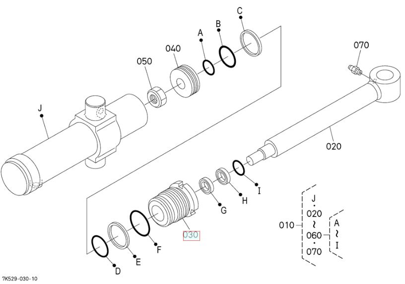

After an evening to think it through.... Now that we are beginning to understand at least one of the modes of failure, can you think of any test situation where single swing cylinder operation would fail to find a disconnected piston if that is what failed? How about false positives?
I'll admit to feeling at least a little bit dumb for not thinking of that single cylinder test years ago.....
As to causes of failure, the most obvious source of high momentum transfer would be a lateral motion of the piston on the shaft. So I'd look at how well the well the piston is locked to the shaft to the cylinder. That means taking a close look at just how that threaded nut secures the piston - are there special washers or damping springs?
Just as important is how the nut is locked onto the shaft treads. That nut can't be allowed to loosen or the system will certainly fail. That's obvious to any designer. So what is there in this design that keeps that nut from turning? And did it do the job?
If I didn't see a design that I liked, I'd do some research on common practice. JD, Case, and Cat are all companies that use a similar dual swing cylinder setup on their backhoes. It would be worth taking a look at how they built their swing cylinders.

"one of the modes of failure"...so far it's the ONLY mode of failure. No one else has any actual proof of any other mode of failure. There isn't even conjecture at this point. I, like most people, got it to work again with the gravity swing and figured "eh, must be 'fixed'". Well...it's probably NOT actually FIXED.
I think if you hooked up just the left cylinder and the swing worked in both directions, but then hooked up the right cylinder and it didn't...you'd have your solution.
The piston bolts to the shaft. It's clear in the parts diagram. See attached.
Good question! If I get inside a cylinder I'll be looking closely for evidence of locking compound.
I'm pretty sure at this point everyone uses a similar design.
