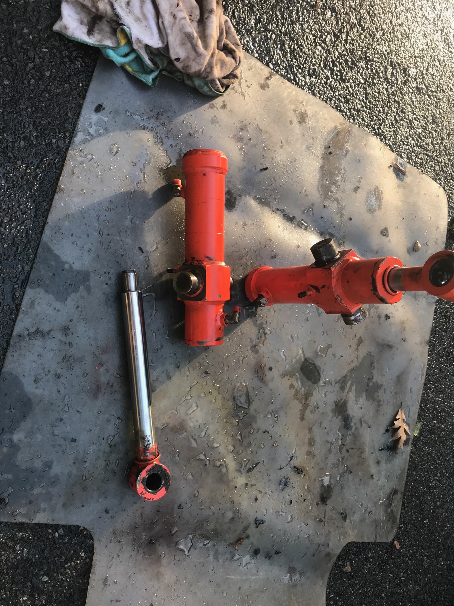

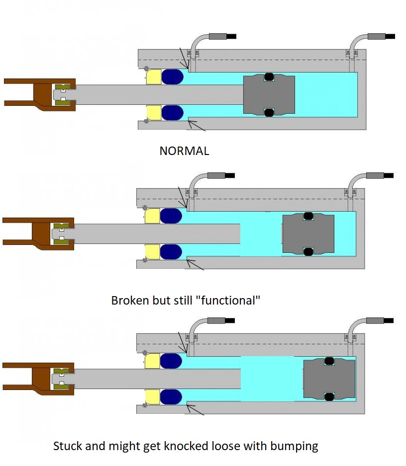

My hat is off to him for taking his cylinders apart and having a look. Right or wrong, so far it is the only positive mechanical information that we have.
If not a solid stop, how about Hydraulic Shock? Given high RPM and a load in the bucket, could suddenly reversing the swing with the control levers create enough tensile force on that rod end to cause the failure?
And looking at the cylinder rod, we have to wonder what mods to piston and rod would make sense to increase the strength of the threaded portion? I'm sure your co-worker put some thought into that. What conclusions?
A shock-damping damping reservoir on a T in the pressure feed line would be another solution.
I will be fascinated to hear what you find in yours.
rScotty
Yeah, right now we have a few examples in the experiment, but only 1 actual data point. I'll become the 2nd when I have time to dig in.
My coworker felt the heat treatment was wrong on the shaft. He also felt the machining on the shaft left stress concentration areas as they left sharp corners rather than had radii. Since the Kubota shaft failed, he didn't want to give Kubota the ~$450 they wanted for a new shaft. He went to a local shop that fabricates cylinders and they cut off the pin end of the shaft and welded it to a new shaft they fabricated.
Momentum and sudden stopping could be the cause. My coworker can be an animal on the controls from the stories I've heard. On the other hand, I'm generally gentle, but I do use my backhoe to move some pretty large logs around during firewood operations. Maybe I stopped the controls at some point and it let loose. We're really just theorizing until I can get in there.
I need to look at the physical hoses/fittings to see if I can easily just rig up one cylinder at a time.

After an evening to think it through.... Now that we are beginning to understand at least one of the modes of failure, can you think of any test situation where single swing cylinder operation would fail to find a disconnected piston if that is what failed? How about false positives?
I'll admit to feeling at least a little bit dumb for not thinking of that single cylinder test years ago.....
As to causes of failure, the most obvious source of high momentum transfer would be a lateral motion of the piston on the shaft. So I'd look at how well the well the piston is locked to the shaft to the cylinder. That means taking a close look at just how that threaded nut secures the piston - are there special washers or damping springs?
Just as important is how the nut is locked onto the shaft treads. That nut can't be allowed to loosen or the system will certainly fail. That's obvious to any designer. So what is there in this design that keeps that nut from turning? And did it do the job?

"one of the modes of failure"...so far it's the ONLY mode of failure. No one else has any actual proof of any other mode of failure. There isn't even conjecture at this point. I, like most people, got it to work again with the gravity swing and figured "eh, must be 'fixed'". Well...it's probably NOT actually FIXED.
I think if you hooked up just the left cylinder and the swing worked in both directions, but then hooked up the right cylinder and it didn't...you'd have your solution.
The piston bolts to the shaft. It's clear in the parts diagram. See attached.
Good question! If I get inside a cylinder I'll be looking closely for evidence of locking compound.
I'm pretty sure at this point everyone uses a similar design.

Just wanted to update everyone I fixed my swing problem. I ended up swapping top to bottom bottom to top on the valves not the hose. My swing problem changed with the swap. So I looked to see how much a valve was to replace. Way to much money for something that has springs and an o ring so I took mine apart guessing the valve the followed with the problem was now the bottom valve. I was told by kubota it was un serviceable, they are right to extent. There's an o ring and backer ring that sits inside a cup that holds a needle in place. Low and behold a small piece of oring that has been rolled off by the backer ring pinching the o ring. Took to local shop for o ring sizing they were surprised how loose fitting the oring was on the valve. They suspect when the unit is cold the o ring rolls on it self inside and cause a poor seal causing the no swing. Sometimes with the split style backer ring the o ring pinches and well my tore but it worked sometime and sometimes didn't. So I replaced the oring a very loose fit but put it back together and power left and right more then I ever had for pushing the machine side to side. Now I just to rebuild my boom cylinder never ends. But if anyone wants pictures or what I did further feel free to take stuff apart it's only money if you break what's already broken
/ HELP! My Backhoe won't swing left! #60
Congrats on taking it apart and doing it yourself. And maybe you have solved the mystery.
It seems like a piece of O ring holding an overload relief valve from closing would eplain all the things we have seen so far, including having unequal swing power in both directions.
I do wonder about tha oversize O ring you found. It seems odd. There are some fluids that will cause O rings to expand. It might be worth tapping off some of the trans/hydraulic fluid in your machine and putting it in a jar with some O rings just to check.
To see what can happen, coat some standard hardware store O rings with vaseline and put them into a zip lock. Compare with a new one in a few months. Amazing.
