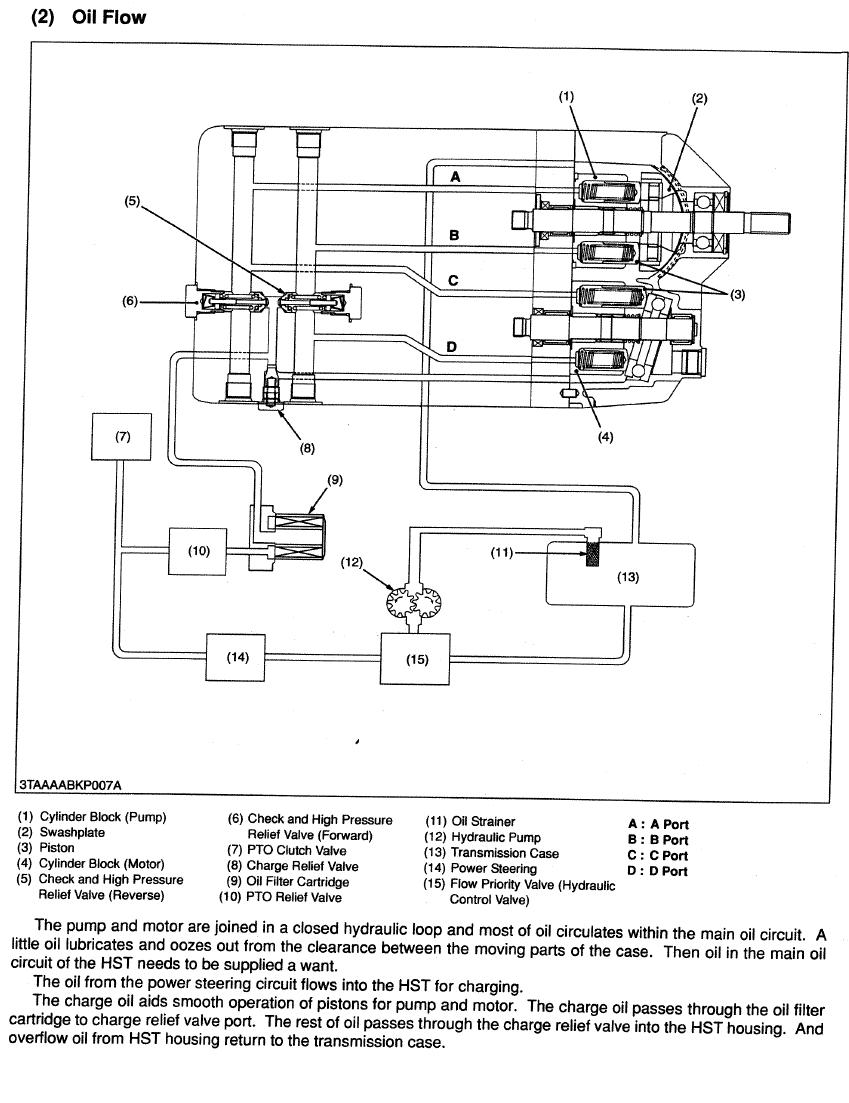

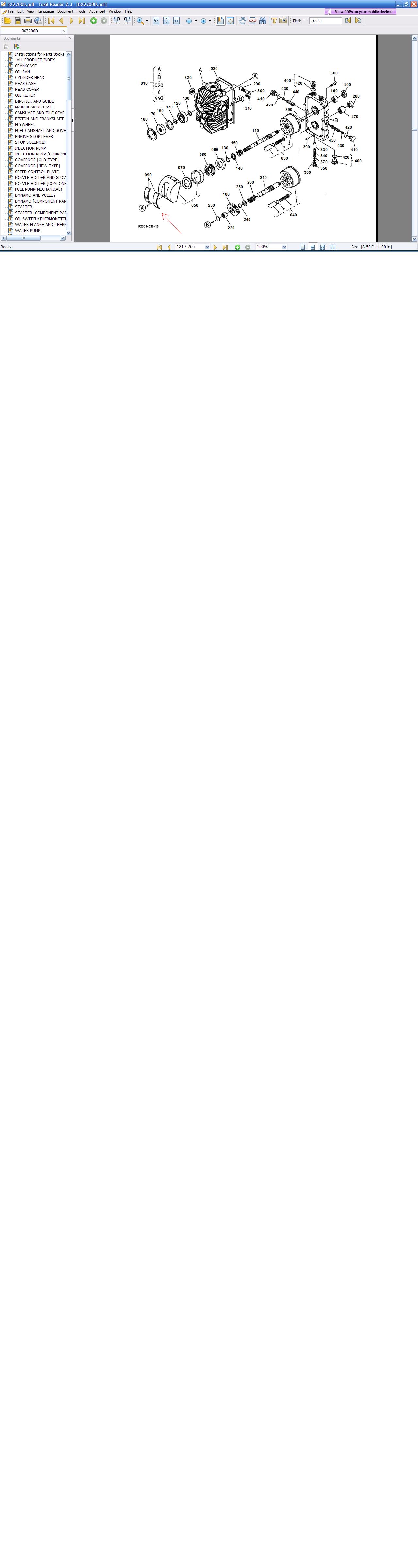

Thanks for the update Larry. I have been wondering about this for a while, and I know you have been fighting the white stuff. I took the liberty of posting a jpg from my BX2200 manual; yours should be very similar since they are both BX??00 series. It is item 90, marked with a red arrow. It takes reaction forces from the pump pistons.
This part should be wet with case fluid, but it depends a bit on the case drain layout, etc. I would not expect to see that part fail early, since there are moving parts that are living a much tougher life nearby.
