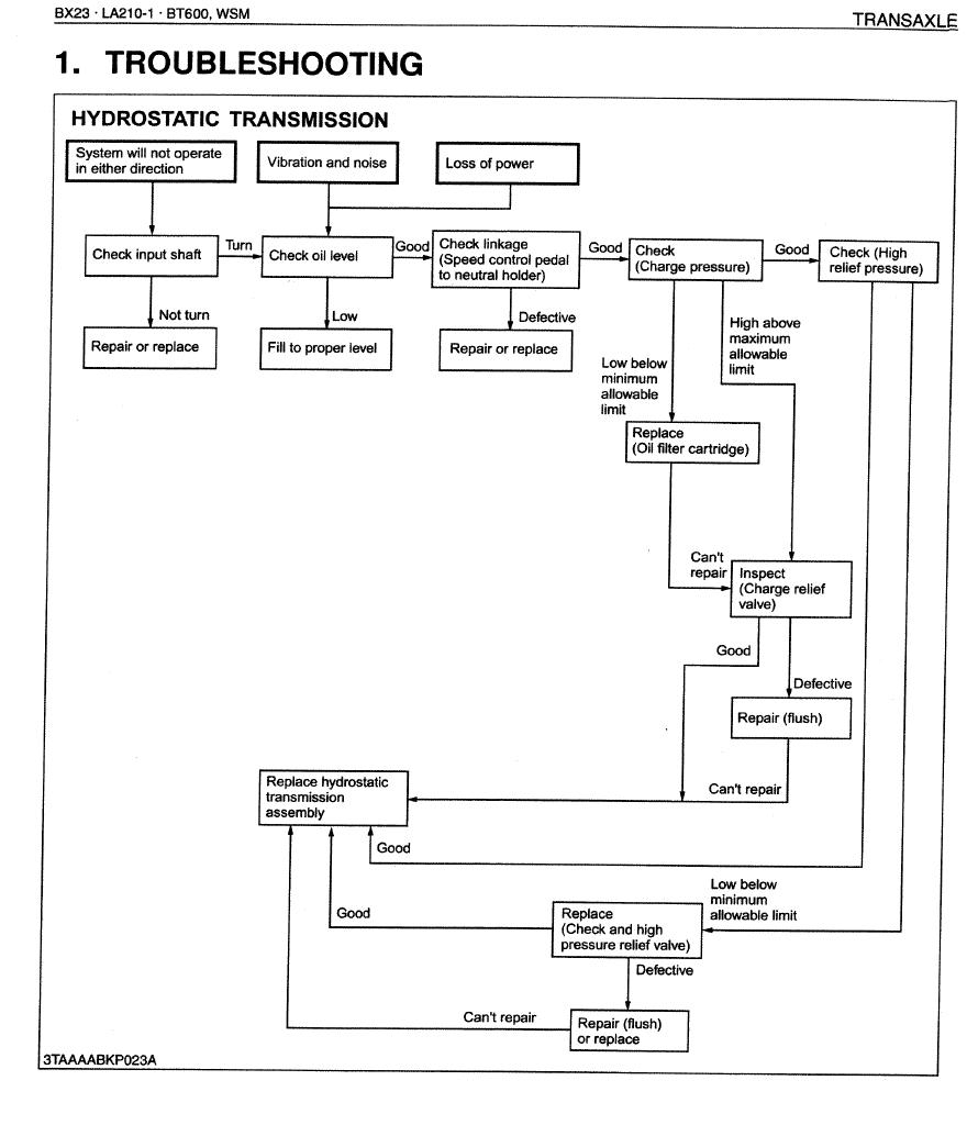

My BX1500 has a serious problem. Everything on the tractor is working perfectly except the transmission. Im running SUDT and the level is right - fluid clear and clean. Never a problem until yesterday when I noticed that pushing the go pedal for reverse in hi range caused the tractor to shudder. Forward fine - lo range fine both directions. Went ahead and got a good start on snowthrowing. Finished today and its getting worse. You have to really nurse the go pedal to get it to climb a hill or push - even in lo range. Once the tractor encounters a bit of real resistance the go pedal will just drop to the floor as if it lost its servo connection to the transmission and the tractor loses all thrust - it seems to be out of gear. If you let up and re press the pedal it has firmed back up and if you nurse it by pushing gently you may be able get enuf thrust to crawl out of the situation. Reverse is worse - the tractor wont back up much of an incline.
Does anybody know where to look for this problem? Iv heard of something called the charge pump that I think is necessary to supply the servo link to the variable volume hydrostatic pump. Is that correct? Why would it suddenly take a walk?

Sorry to hear it. I don't know much about your tractor. Mine is a BX2200, and if they are alike:
If any of the hydraulics works, the charge pump must work. If the power steering works, then the flow priority valve is working. If the PTO works, you have fluid to that point, leaving the only thing between the charge pump fluid and the final destination: the PTO relief valve, and the FILTER. I would replace the filter if you have not already, since the filter is the last thing before fluid enters the axial piston pump / motor housing.
After that, I would start to wonder if some sort of contamination was interfering with the three relief valves in the hydro set.

Larry,
I would check the linkage between the foot pedal and the transmission. Look especially close and the connection on transmission. From what I can see in the parts list it has a pin that hold the linkage onto the input shaft of the tranny. This is the only simple and external common component I can think off that would give the symptoms you are describing.
Typically stuck relief valves should only effect travel in one direction.
Did you notice and excessive or change in noises coming from the tranny. I.e whistling like water fluid escaping under pressure?
Does the tranny get hotter than normal or get hot quicker in one area.

From the BX23 WSM, should be applicable to the BX1500 HST.
Good luck.

Volfandt posted the chart that tells the tale.
You said you ran it in high a good bit, but you didn't say whether you were gaining in temperature enough to be sure that if water crystals were present that they would melt. If water were in the fluid, melting it is not necessarily sufficient to cure problems, however, since emulsified water in oil has trouble sometimes going through filter media.
The screen being clean is an important point, but adequate lift movement ought to give a reasonable indication of whether or not that is a big enough problem to account for the symptoms. Nevertheless, I would examine that before I did anything intrusive, or expensive. I have wondered if cavitation in the presense of water might result in vapor, which would not effect hydraulic actuators substatially, but may cause problems in the hydro set.
My instincts tell me to get the tractor warm by any possible means, check the pedal linkages as others have suggested, and then work through the flow chart Volfandt provided, testing at each stage. That may be beyond your capabilities. It is beyond mine, since I don't know where the test points are, and I may not have the fittings. My tractor seems to use some G1/4 testpoints which are BSPP 1/4.
