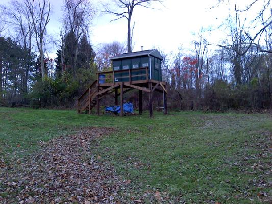

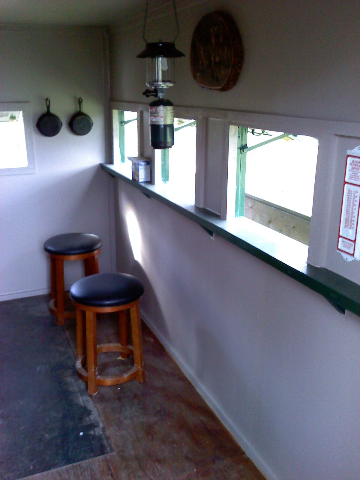

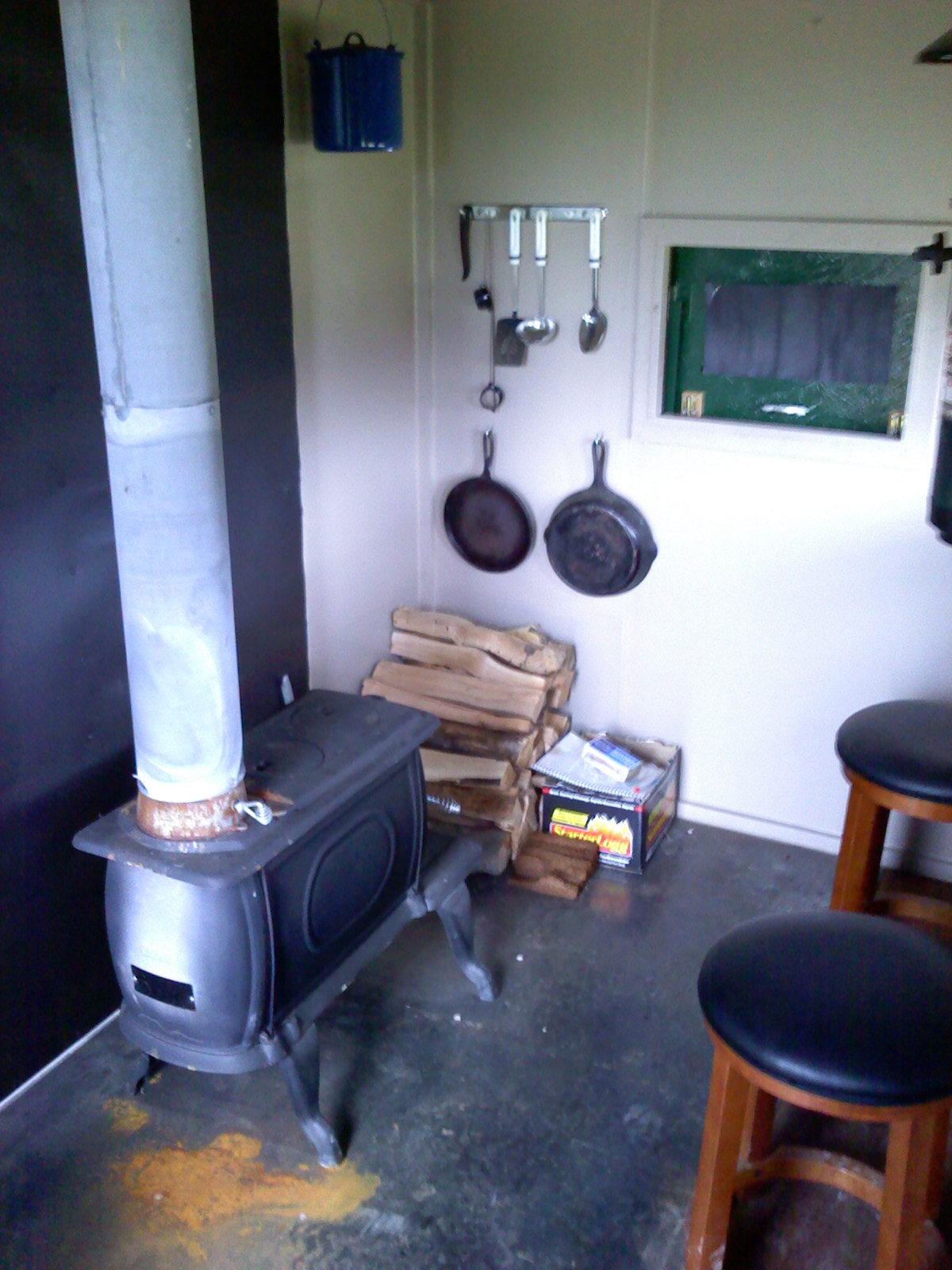

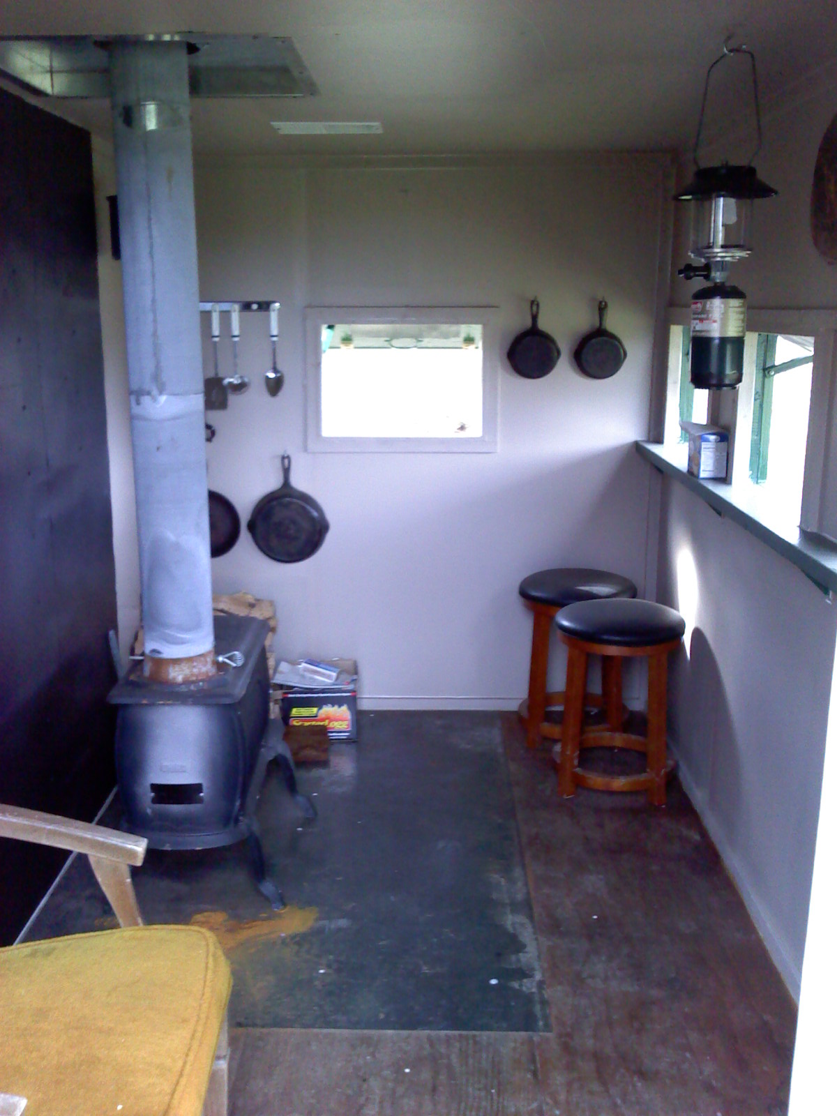

here is some pics of my cabin. may give you some ideas.

Kiotick20,
Thanks for the pics. Can you give me the inside dimensions as well as the dimensions of the porch. What you have is pretty close to what I am imagining.
If you had to do it all over again, would you make any changes?
Thanks
/ Help me with a Deer Condo #17
the deck is 8' x15' x 10' h and the cabin is 6 1/2' x 11 1/2' x 7' h . the walls are insulated with 1 1/2" pink styrofoam, finished inside with drywall. the wood stove comes in handy for coffee or hot chocolate. even made breakfast on it. thought of a ladder up the side to the deck, but glad i put in the staircase. hope this helps.
YOU WIN!!!!! That is the best deer blind that I've ever seen. Love the wood stove. That's just so over the top as to be genious. :thumbsup: :thumbsup:
Thanks for sharing, you've raised to bar to a new level.
