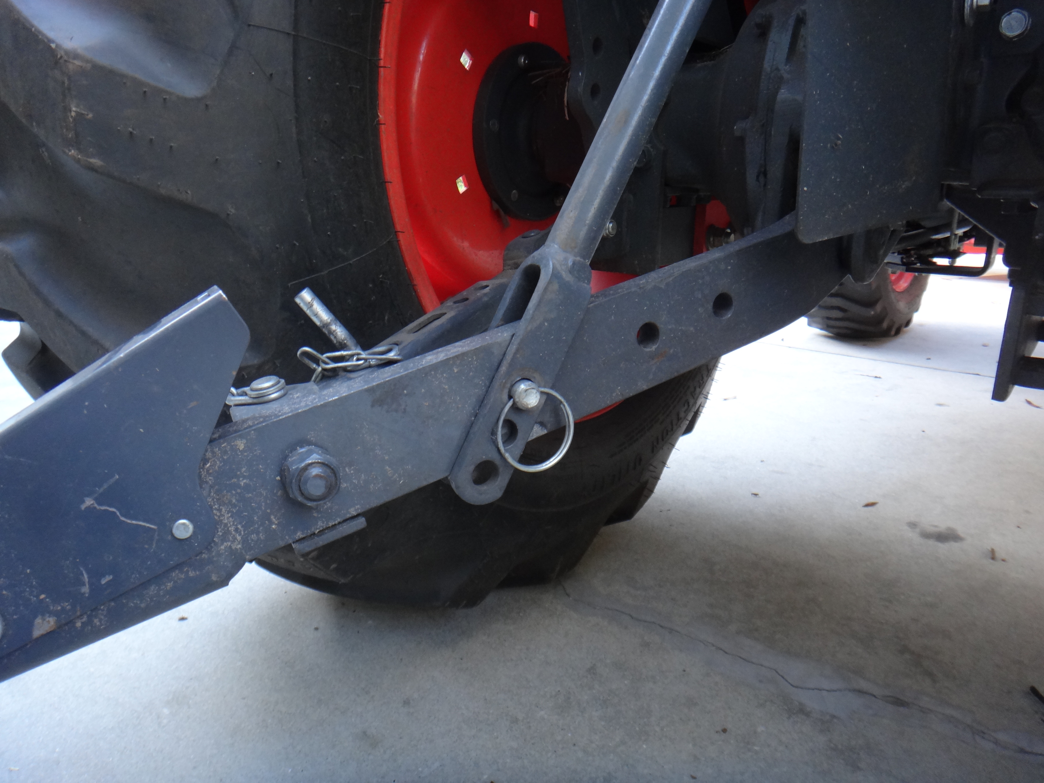

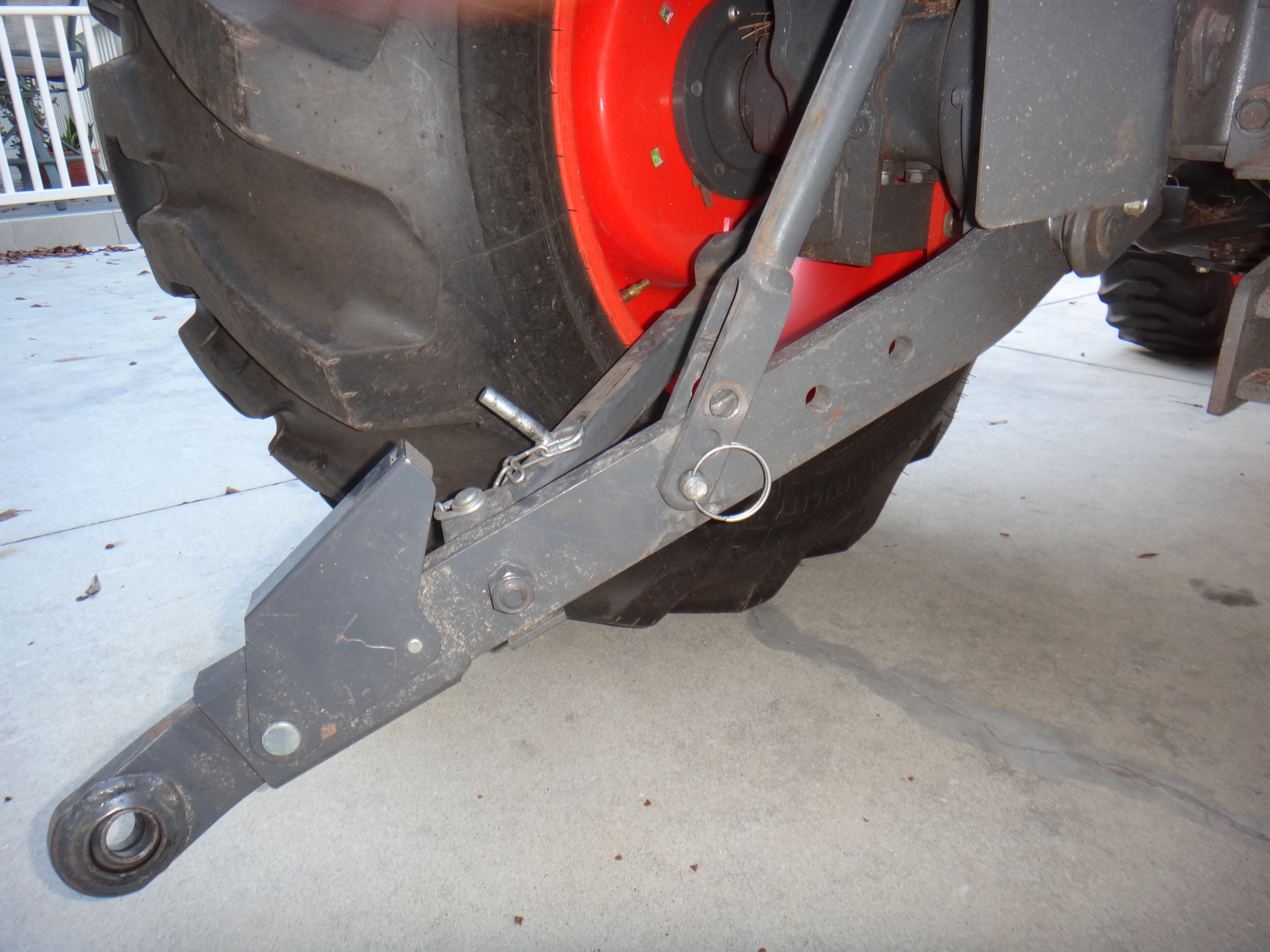

My blade is a CountyLine one from Tractor Supply, and have heard they can bend if you use them for heavier digging/cutting. Also, the blade itself doesn't tilt so I would need to extend the right hand 3PH arm to get the tilt which I have read can bend the arm and cause other problems.
Better to adjust Box Blade tilt by moving LEFT Lifting Rod stirrup pin to one of the two lower adjustment holes available. Lower hole = less lift = tilt to left. (RIGHT works equally well but only two, rather than three adjustment holes on right.)
Then fine tune tilt with adjustable Right Lifting Rod. Less stress on the Lifting Rods following this procedure.
