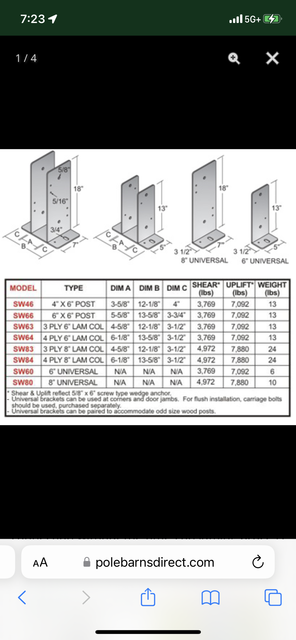

Post frame with either wet-set anchors for the posts or drilled in anchors. how would my slab need to be constructed for this? I know with post-in-ground you can just pour a monolithic slab with no footing after the erection, easiest and cheepest.
How would the slab need to be built to support stick built construction?

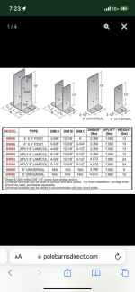

If you go the pole barn route……
Use this style of base after concrete

The common misconception that poles will rot out in the ground isn't true. I understand that wood posts in the ground, can, and have rotted out, but not when they have proper drainage. Usually the rot is from a fence post, or unprotected building with an exposed wall, or massive run off from the roof that is splashing, and eroding the soil at the post. As long as you have good drainage, and you keep your posts in the ground dry, they will last a hundred years or more.
Wood posts in the ground with purlins on the walls and wood trusses for the roof is the most cost effective, cheapest way, to build a structure. Besides a huge savings in what it costs to build, wood posts in the ground make the building more secure, and stronger then stick framing, or posts attached to the surface of a concrete pad. The most obvious advantages are the resistance to racking, and uplift from a storm. Another plus for building with poles in the ground is how simple it is to frame it up. Set posts in a straight line, attach purlins, and your walls are done.
Stick framing will cost a lot more in materials, but if you are framing the interior walls, you are spending that money anyway. The advantage to stick framing is in finishing the interior walls. One person can easily frame a building, but it's time consuming.
