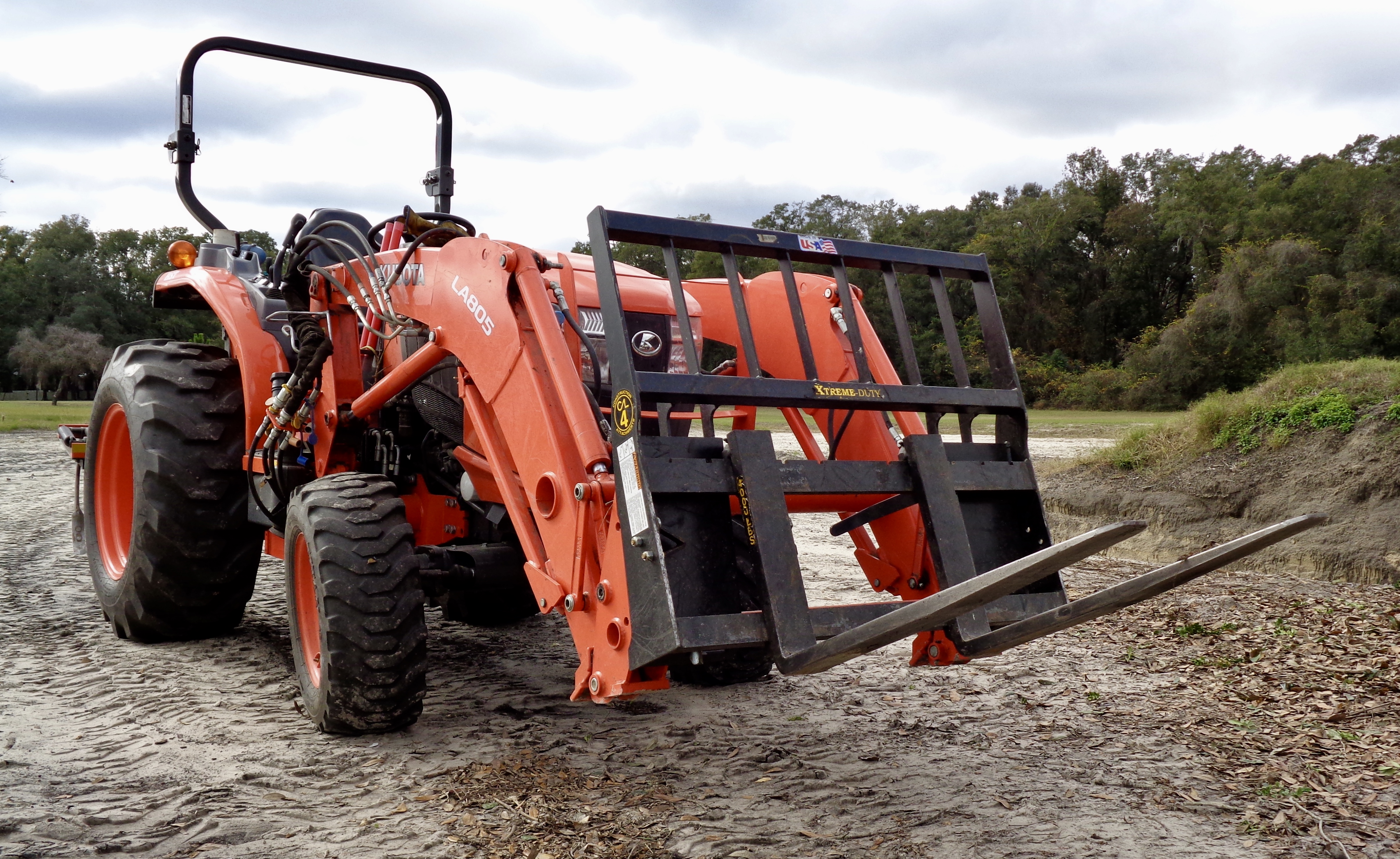

I’m going to throw out an idea, get forks instead of a grapple. You will probably want forks anyway, and not the kind that go on the bucket but forks with a headache rack. A lot of people will disagree with me on this but it will save you at least $1500. I might bump up your brush cutter a foot bigger also with the money saved on the grapple. That might not fit on your trails though? but would make the open areas go quicker. If later on you find you really need a grapple you can add it.

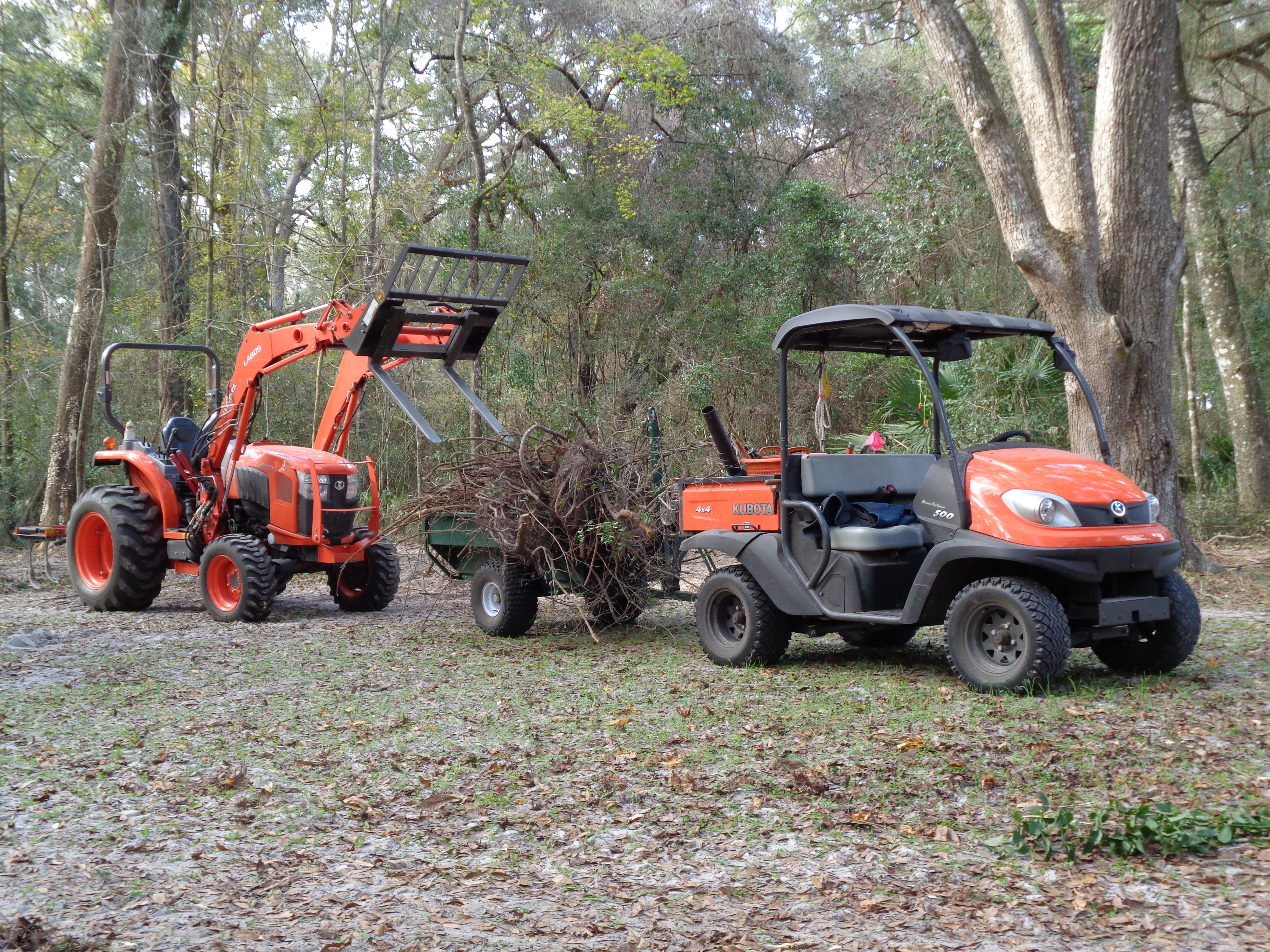

Moving tree debris is the OP's primary tractor task.
I find SSQA Pallet Forks entirely satisfactory on my flat land. For the OP's land, all sloping, some significantly hilled, I opine a grapple squeezing tree debris will make transportation of tree debris a safer proposition. A load shift on Pallet Forks could roll the tractor.
I've had individual logs roll over my Pallet Forks and crash onto the tractor hood with only dents as the result. The OP is giving consideration to a cab tractor. Logs might have broken tractor glass, had I a cab tractor.
