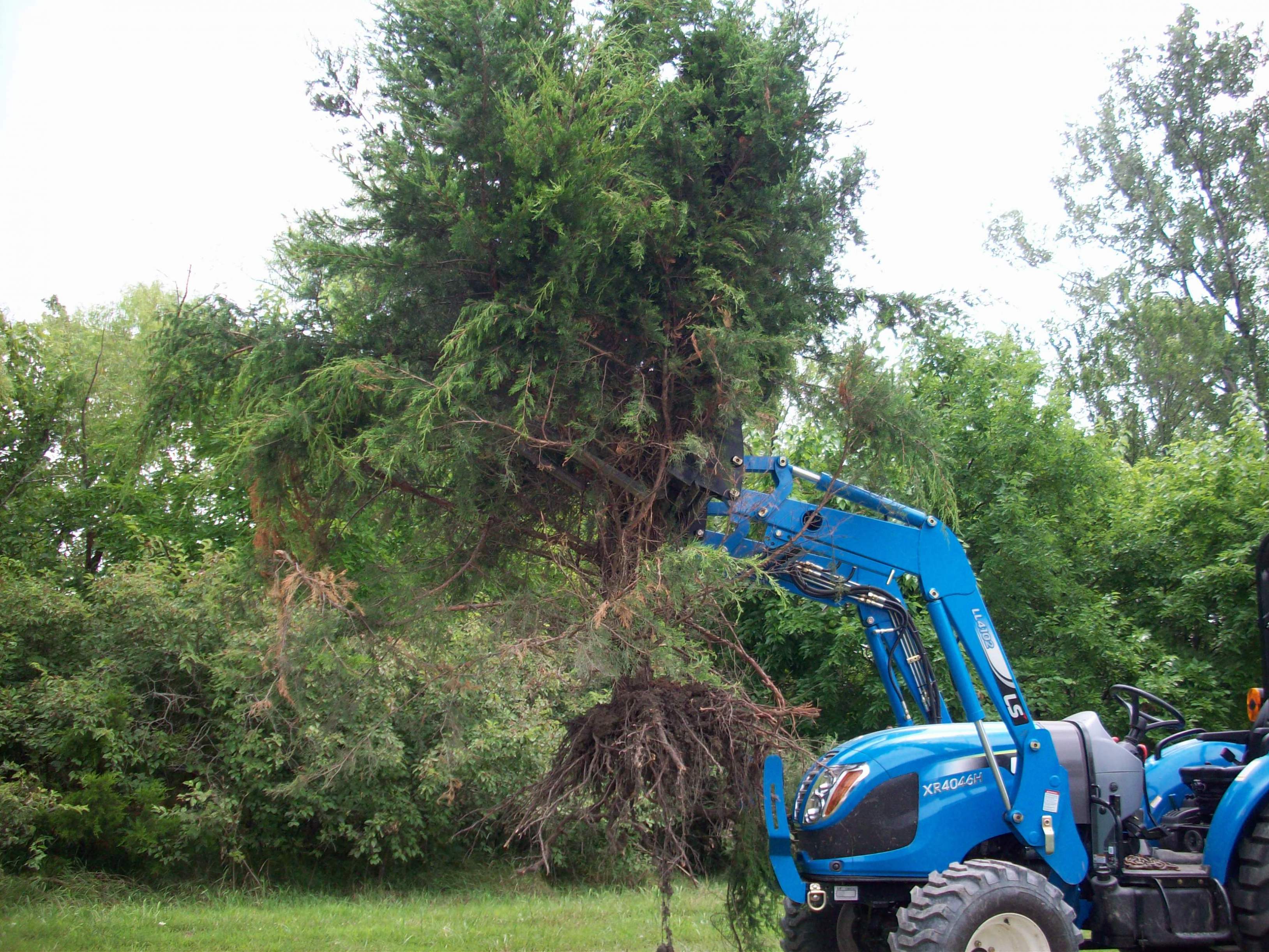

I have a LS xr4046 and bought the 60" grapple and forks from palletforks.com. I can remove cedar trees under 5" trunk with just the grapple. Push the tree back and forth to loosen up the roots and then pull out with the grapple. On the larger trees, I use the forks and dig under the tree to loosen and break roots then I am able to pull the tree and stumps out. Do not cut the tree down before trying to remove the sumps, use the tree for leverage to loosen the stump. I was amazed at how large of a stump I could remove. I like having the oversized grapple and the 2 lids work good for removing and moving brush. The welding on the titan is not real pretty, but I have not broke any yet.

Cedar trees are bulky but not very heavy (relative to hardwoods), especially after they've been dead a while. I've removed a few hundred so far with my stump grapple, which is only a single lid and is very narrow. For just moving downed cedars, any grapple will do the job, which is a pretty easy job. So don't overthink it.
Are you sure you want to cut them off and leave the stumps? The stumps are a nuisance, IMO. I'm removing mine by either pushing them over and ripping them out of the ground with the grapple, or by wrapping a chain around the trunk and pulling them out of ground. For the larger ones I can't push over with my DK50SE, I dig up the lateral roots with the BX23 backhoe and then push them over or jerk them out with a chain.

If you are going to try to dig with the grapple, get a narrow one. Very hard to dig with a wide grapple, the more teeth it has the harder it is to penetrate soil. Also, make sure the design is intended to penetrate and does not have a cross tube near the tips.

The short answer is "I have always done it that way" :) Once I get the grapple I will try taking down the whole tree. My new LS outweighs my old tractor by over 1000 lbs and has 10 more HP. The FEL on the LS will lift over twice what the one on my 1920 would - so shoving and ripping might work better. I will give it a try. It would be nice to be able to skip my grinding step on all except the bigger trees.

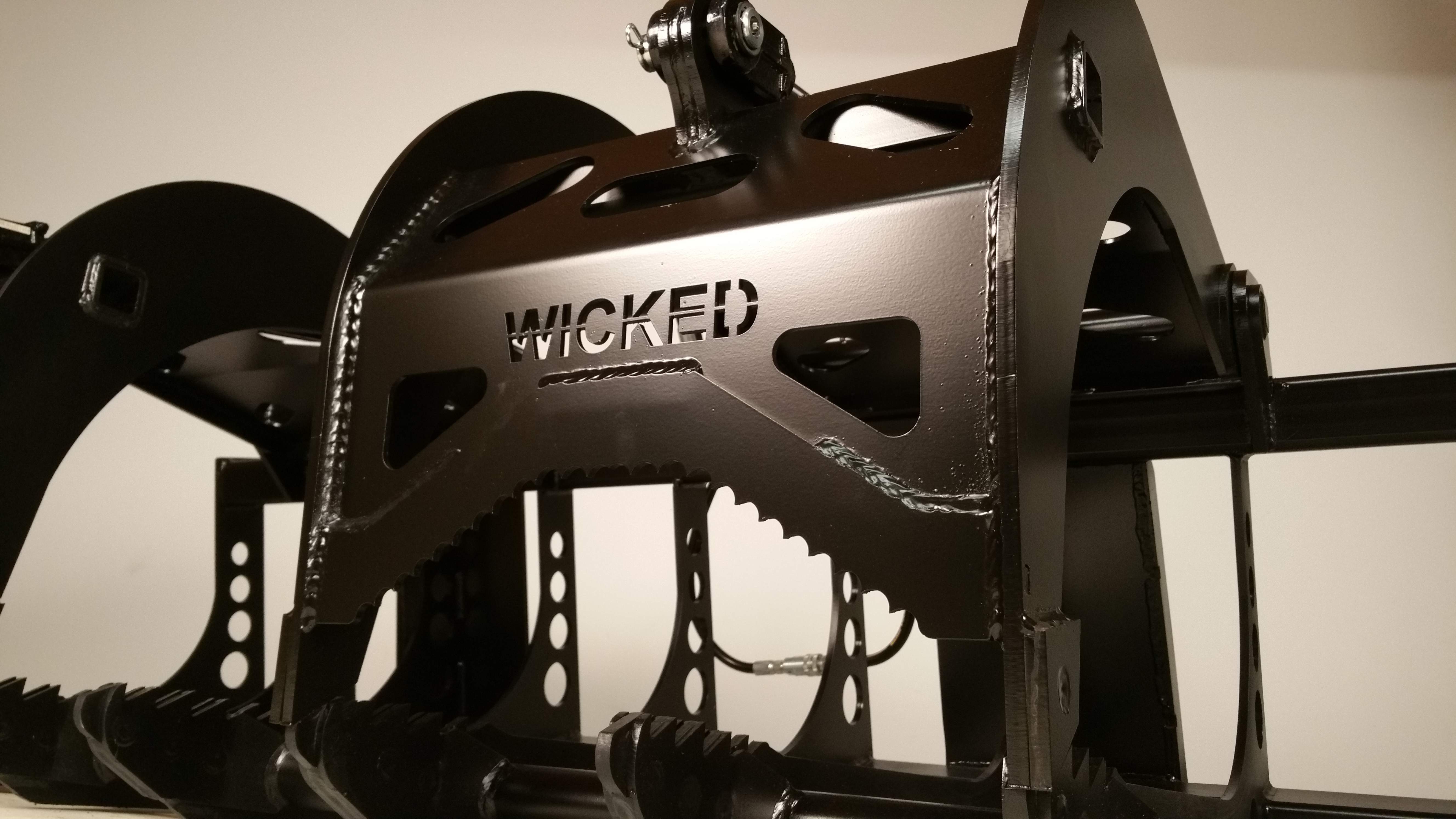

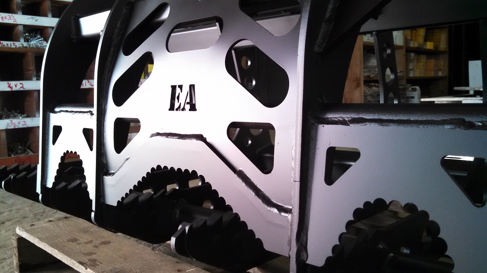

I have an 84" dual lid Blue Diamond grapple and WR Long 3rd Function installed on my New Holland TL100A (96 HP) tractor. After offsetting weight of the grapple (900lb.+), I can still lift over 4000 lbs. net. I regularly push over dead trees with goal of breaking out roots and all so I have a hole to fill and no stump to have to deal with.
My one and only complaint, on this grapple, is the jaw opening is only 34" which somewhat limits it in picking up piles of brush or limbs from tree trimming. I am looking seriously at Everything Attachments new Wicked Grapples for Utility Tractors. They already have a 72" model with jaw opening of 42-43" and should soon have same in a 55" model which is where my interest is to install on my LS XR4046HC. I already have the WR Long 3rd function installed on this tractor as well.
Using one of your rear remotes, to operate your grapple is certainly doable but, once you use one with a true 3rd function you will never go back. You control lift and curl with your hand and grapple with your thumb on toggles switch.

Question about pushing them over: Grapple high on the tree for leverage? Grapple curled back or rolled forward?
/ Help me choose a grapple #35
For cedar trees, I raise the stump grapple up so that it contacts the trunk of the tree about 3 - 4' feet off the ground (depending on the size of the tree). That seems to me to do two things. First, it keeps me from having any part of the FEL structure fully extended, which might put undue stress on it. And, secondly, it gives me a little leverage to put more pressure on the roots
If I start too high up the tree trunk, it will usually just crack and splinter without busting the roots out of the ground. You'll be able to judge how high to start after you've done a few of them (and busted a few trunks up by positioning the grapple too high up on the trunk.)
I try to keep the grapple just rolled down just slightly below level.
