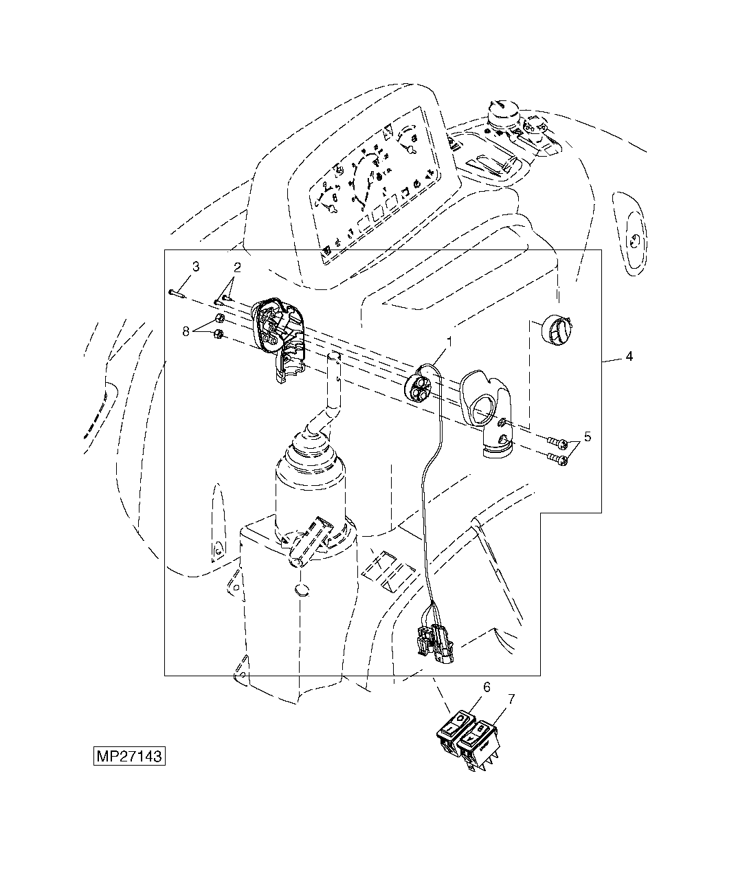

The 110TLB was the tip. I got the part number. Thanks.
attachment.php

I was just getting ready to post that!
Here is the breakdown to go with the pics since I just got it anyway:
SCV Controller (312149 - )
Cart key PART NO. PART NAME QTY SERIAL NO. REMARKS
1 LVA11729 Wiring Harness 1 ALSO ORDER LVA13698
2 37M7355 Screw 2 (A)
3 37M7356 Screw 1 (A)
4 T178768 Boot 1 SWITCH, (SUB FOR AT222804)
5 AT222608 Kit 1 (Grip Fastener Hardware Kit) (Includes Parts marked (A))
LVA12162 Nut 2 4.826 mm (A)
6 LVU16701 Grip 1
7 LVU16650 Grip 1
8 LVA13698 Grip 1
21H1486 Screw 2 0.190" X 1-1/8"
9 LVA12405 Switch 1 AUX HYDRAULIC ENABLE
10 LVA12404 Switch 1 THIRD SPOOL
11 M115279 Plug 2 (SUB FOR LVU12756, THIS APPLICATION)
12 M93511 Screw 2
13 24M7146 Washer 2 4.300 X 12 X 1 mm
14 T149199 Label 1 AUX HYD

It turns out it is also used in the 5083e as well and who knows, likely more applications too.
Apparently once a guy could order the harness alone but now Deere wants to sell the grip as an assembly, part number LVA13698.
I can save myself $60.00 by soldering the bits I've ordered, or spend $60.00 more on a slick factory grip with better looking wiring harness. LOL
(not the mention the soldering wick, and special silver solder I also ordered) :(
Sheesh, and I found the exact little switches Deere uses and ordered four of them from the same company at $4.00 a pop.
Thank you for your help.
I need to stop buying things in the middle of the night, learn patience, and wait until morning for people to respond.:laughing:
