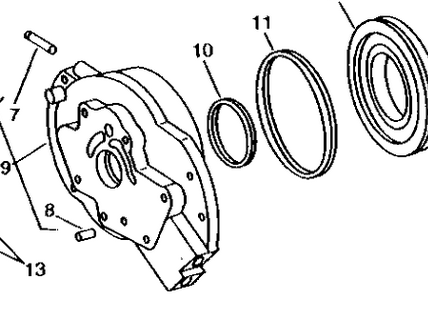

/ Help, Jd 410 backhoe won't move fast #3
Does it have 160#s in forward? Maybe disconnect clutch(parts key 4) is slipping.

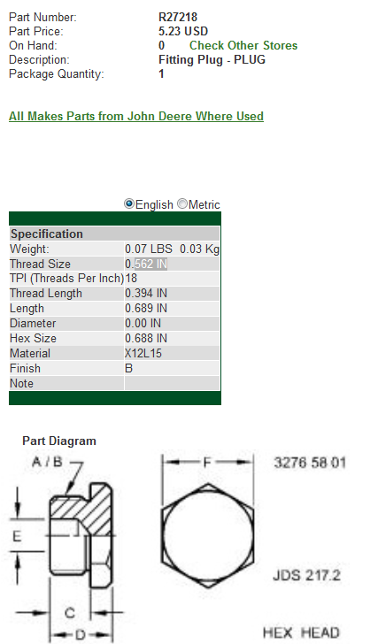

#11
So I got the cover plate in but they didn't send a gasket so I made one out of an unused water pump gasket which worked no leaks. My challenge is coming in trying to find the right thread/size for the test hole. I bought about 15 different fittings to make sure I had the right one and I cannot get any of them to thread in without force. I took the plug to Lowes and I believe it's 3/8 20 but they don't sell 3/8 20 fittings. I had to use compression. I could get the plug to screw into the female side so I found a male to match but it will not thread in when I got it gone. Does anyone know the exact type and size fitting/thread.
/ Help, Jd 410 backhoe won't move fast #12
Are you referring to test ports on reverser control valve? If so the specs for plugs are listed below.

/ Help, Jd 410 backhoe won't move fast #17
Hyd leaks will be internal. Reverser brake piston seals(parts key 10 & 11), Sealing rings on fwd clutch(parts keys 2A or 2B) depending on tractor serial number.
